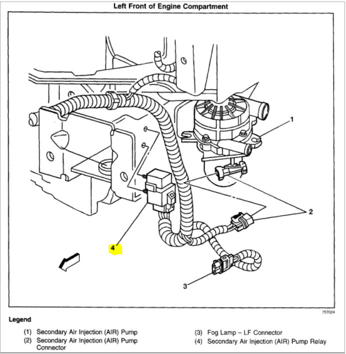

Secondary air flow relay location needed.

The secondary air injection pump relay is located left front of the engine compartment near the air filter duct.
I have attached a diagram below for your reference.
Let me know of any questions.
