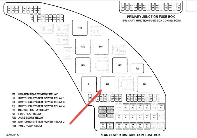

I am trying to find out and buy relay one which is found in the primary junction box in the driver's foot well. It is for the power supply in the front arm rest.

we list power relay one in rear junction box, not sure if this is what you want or not see picture this is on US models so may be different where you are. Check out the diagrams (Below). Please let us know if you need anything else to get the problem fixed.
