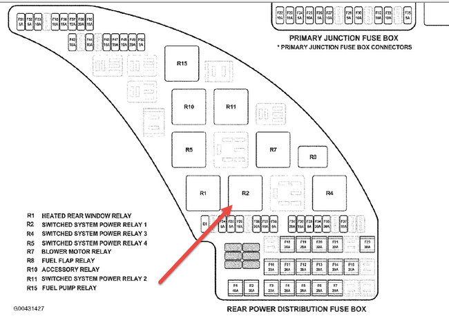

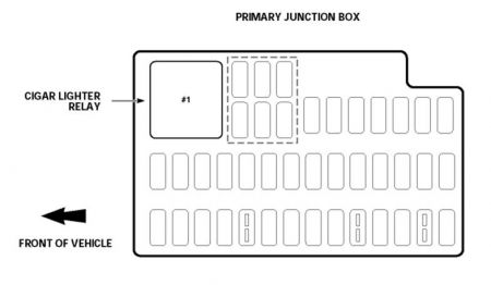

I am trying to find out and buy relay one which is found in the primary junction box in the driver's foot well. It is for the power supply in the front arm rest.
Regards
Apr 2, 2017 at 12:10 AM
HMAC300
  • 48,601 POSTS
we list power relay one in rear junction box, not sure if this is what you want or not see picture this is on US models so may be different where you are. Check out the diagrams (Below). Please let us know if you need anything else to get the problem fixed.

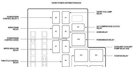

Air Conditioning problem
2000 Jaguar S-Type

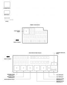

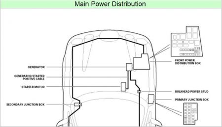

My friend has a problem with her jaguar, so we took it to a mechanic and he said it might be the relays problem is i have the handbook but it does not say anything about the relays. Anybody know all the relays in the fuse boxes? I know there are 3 fuse boxes and i looked everywhere on the internet but could not find one diagram of the relays. Any help would be appreciated.
Jan 18, 2021 at 3:12 AM (Merged)
  • 75,992 POSTS
Main Power Distribution
https://images.2carpros.com/forum/automotive_pictures/12900_r3_3.jpg
Relay Identification And Location Part 1
https://images.2carpros.com/forum/automotive_pictures/12900_r1_12.jpg
Relay Identification And Location Part 2
https://images.2carpros.com/forum/automotive_pictures/12900_r2_12.jpg

TOOLMAN74523

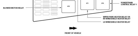

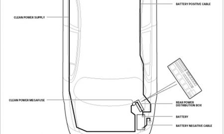

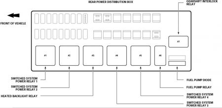

this is great, and im sorry for even asking this since you helped me this much already. Is there anyway you can make the writing bigger so i can see it more clearly? its just alittle bit blurry for me to pick up. If you cant dont worry about it and thank you again for this
  • 75,992 POSTS
I hope this helps!!!
https://images.2carpros.com/forum/automotive_pictures/12900_r_8.jpg
https://images.2carpros.com/forum/automotive_pictures/12900_rA_1.jpg
https://images.2carpros.com/forum/automotive_pictures/12900_r1_13.jpg
https://images.2carpros.com/forum/automotive_pictures/12900_r2_13.jpg
https://images.2carpros.com/forum/automotive_pictures/12900_r3_4.jpg
https://images.2carpros.com/forum/automotive_pictures/12900_r4_3.jpg
