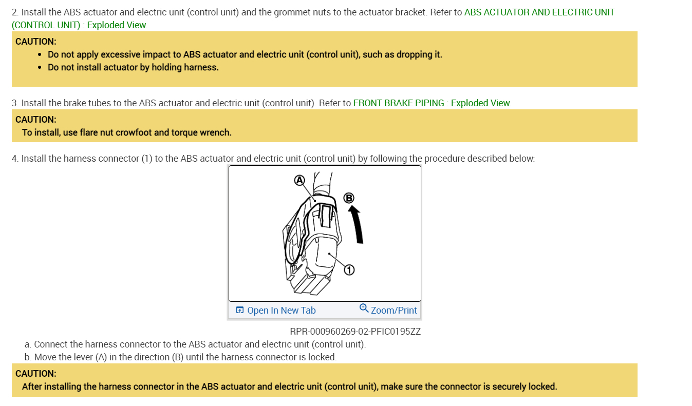

Related codes?
2019 NISSAN ALTIMA
45,000 MILES • 2.5L • 4 CYL • 2WD • AUTOMATIC
ROLO91
C1111-00
C1111-04
C111D-1C
C1140-04
U1002-01
P059F
Active shutter functions properly. Completely drivable. Brakes function properly and despite codes, no anti collision system or brake lights active on instrument panel.
Possible that this is a CAN/short issue? Any ideas?

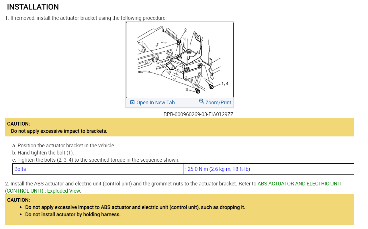

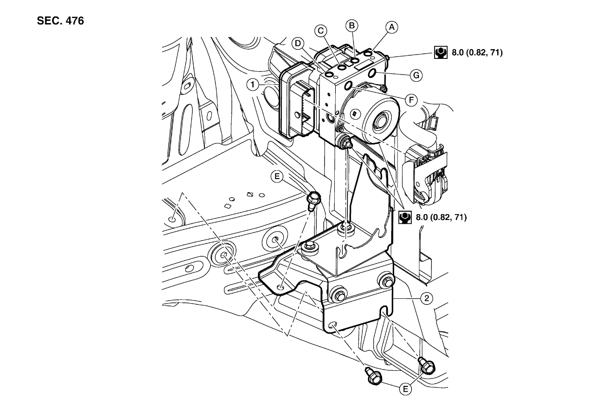

Here is what is said about the codes:
C1111-00: This code is generally related to the ABS pump motor, indicating a fault with the pump motor circuit.
C1111-04: The "-04" extension usually indicates a specific aspect of the C1111 fault.
C111D-1C: This code is less common. C111D often relates to issues with the speed sensor circuit.
C1140-04: C1140 is often associated with issues in the steering angle sensor circuit
U1002-01: U codes are typically related to communication issues between different modules in your vehicle.
P059F: This is a generic code that typically indicates a problem with the Active Grille Air Shutter "A" Control Circuit/Open.

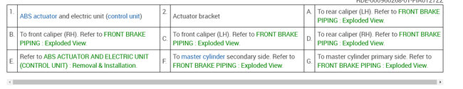

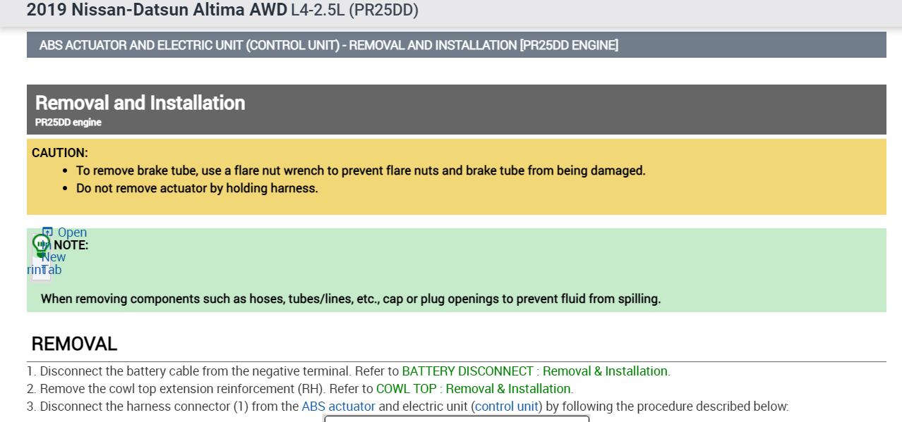

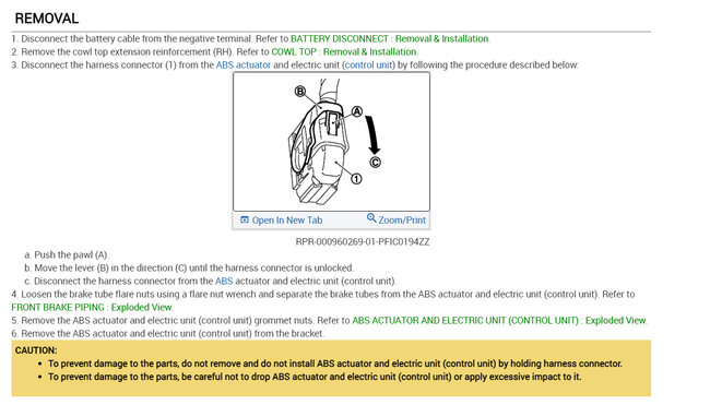

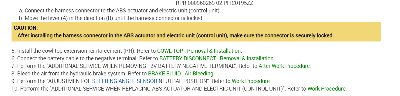

So, it looks like the ABS unit/module needs to be replaced. Here is how the job is done in the images below. Check out the images (below). Please let us know what happens.
