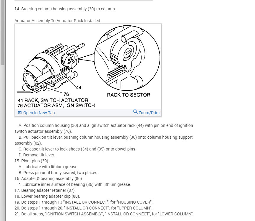

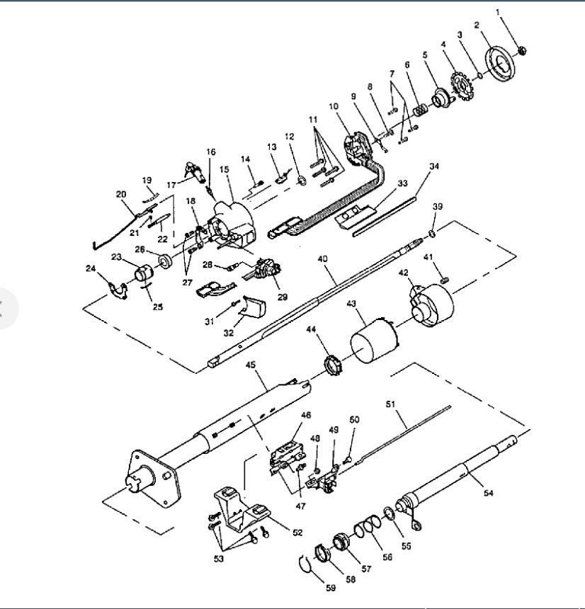

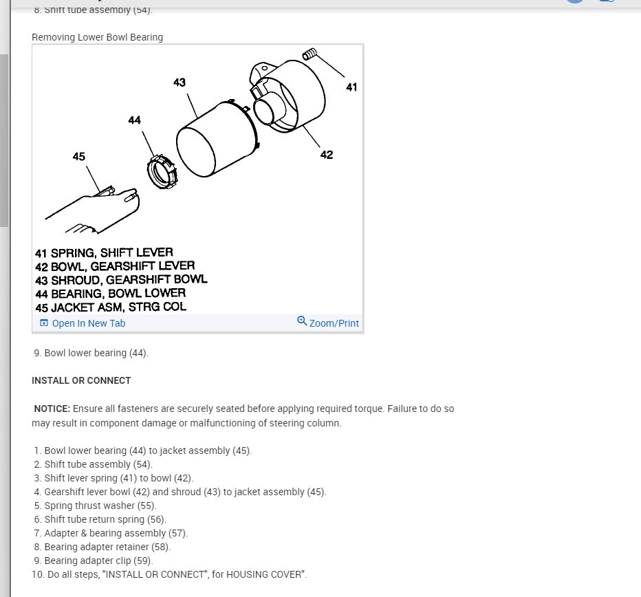

I recently had a few repairs to make on my steering column and its components. I had all parts, screws, springs, clips, washers, etc., laid out in order so I could reinstall everything hopefully without a hitch. There was an accident that caused mass dispersion. Everything was so scattered that I now have the big problem of remembering where they went and what order they should be reinstalled. I need some instruction/guidance. It's a non-tilt column. I suppose my biggest problem is getting the rack and sector to work in sync with the ignition lock. I also need to know the other parts/components that need to be in the ignition lock housing. I really need help here if possible.

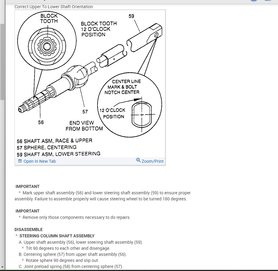

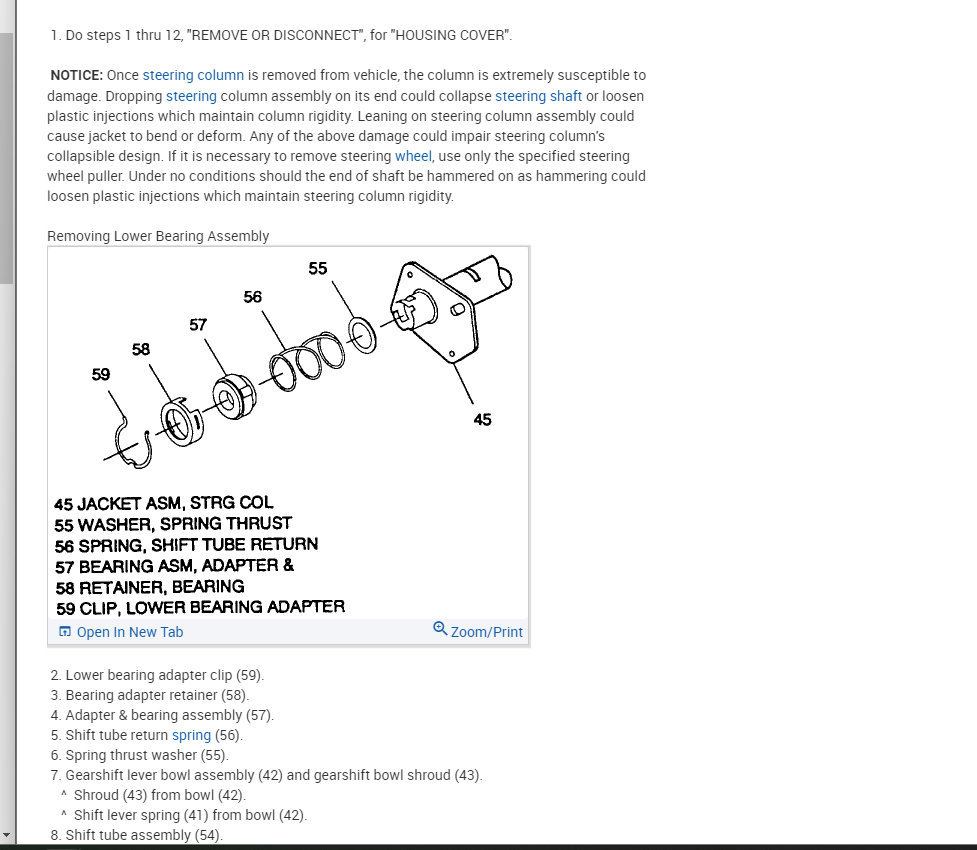

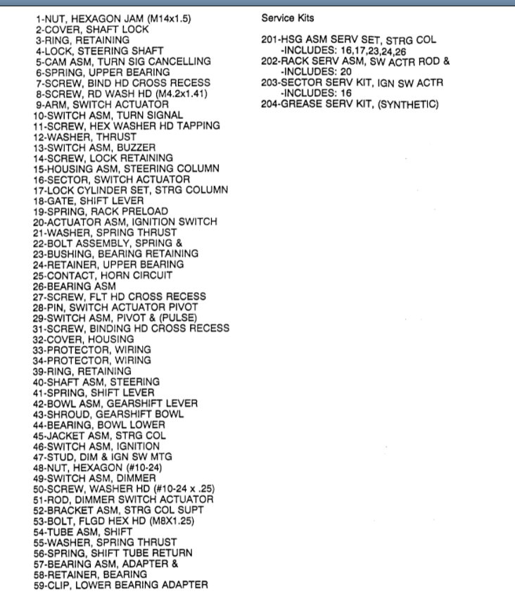

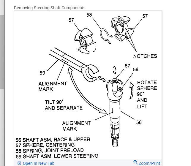

I am not sure which portions you are going to need so I am just providing what I found in the manual.
Clearly you are going to have to let me know what else you need, and I will do what I can to find that detail.
However, it would be best if you get pictures of the components that you can't find a place for.
Please see the info below and let me know what you find.
Thanks
