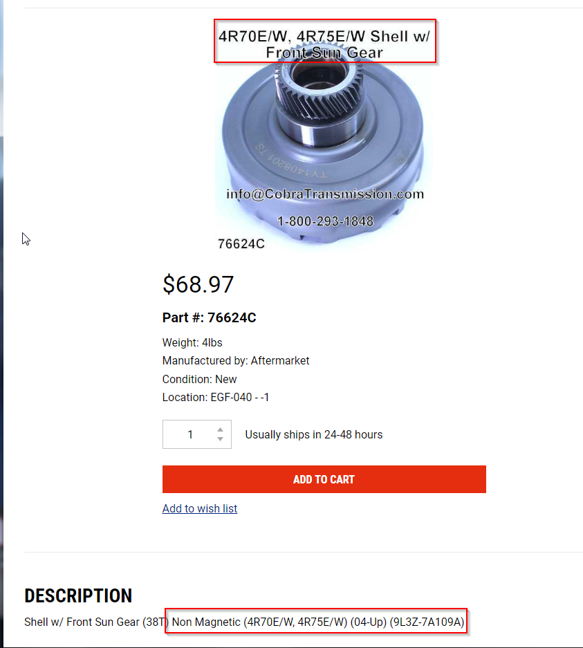

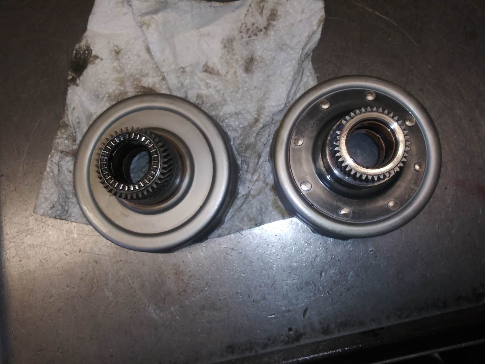

Is riveted sun gear shell interchangeable with non riveted sungear shell in 4r70w?
Here are part numbers: 76624BK (fits 93-15) and 76624C (fits 04-15).
I believe the 76624C has a riveted shell... I'm just concerned about the ISS reading correctly.
Mar 14, 2020 at 7:20 AM

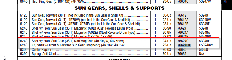

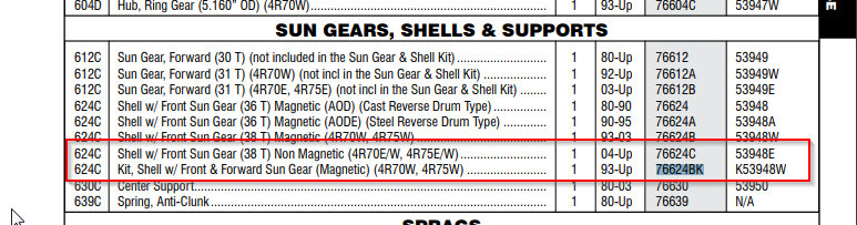

Your concern is on the right path. You need to stick with the one that came out. The non riveted is non magnetic so it is different. Take a look at these charts. There is a separate listing for each one.
Also, is there a reason you are replacing this? These sun gears are fine to reuse unless the races inside the unit are scored or the teeth on the gears are damaged.
I have rebuilt a lot of 4r70's and have not had to replace this very often. In fact, I can't remember when I did. I am sure I have but it has been so rare that I can't remember. Basically if you inspect it and find no sign of damage then I would just reuse the original.
