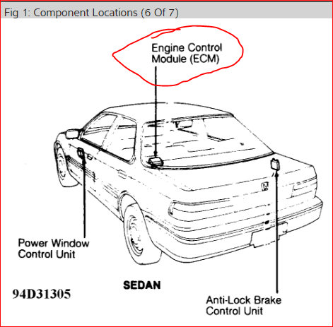

I am wondering what happens if the fuse to the ignition were to blow or be disconnected after the car is already running? I am asking hypothetically as I am thinking of putting a kill-switch in my car to deter auto theft.

Being that your car is ECM controlled it would not be good to blow the fuse while driving! You would lose all control/power to the ECM (picture attached) the fuel pump would shut off, engine would shut off, etc. Hope this helps and thanks for using 2CarPros.
