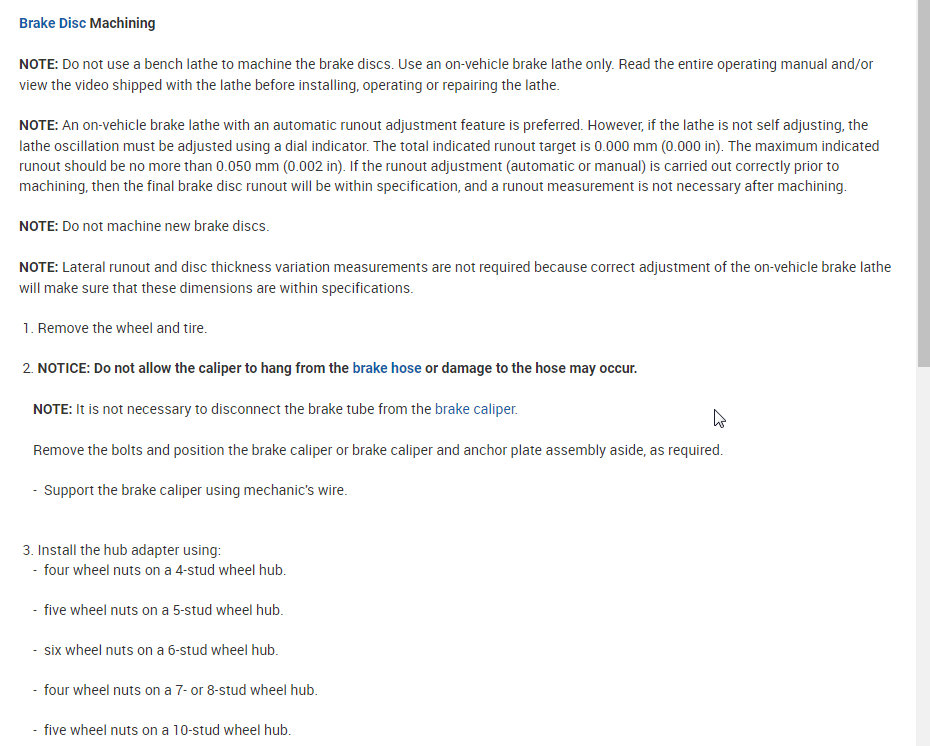

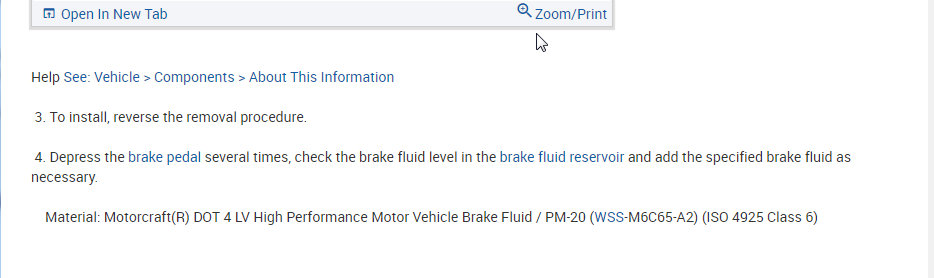

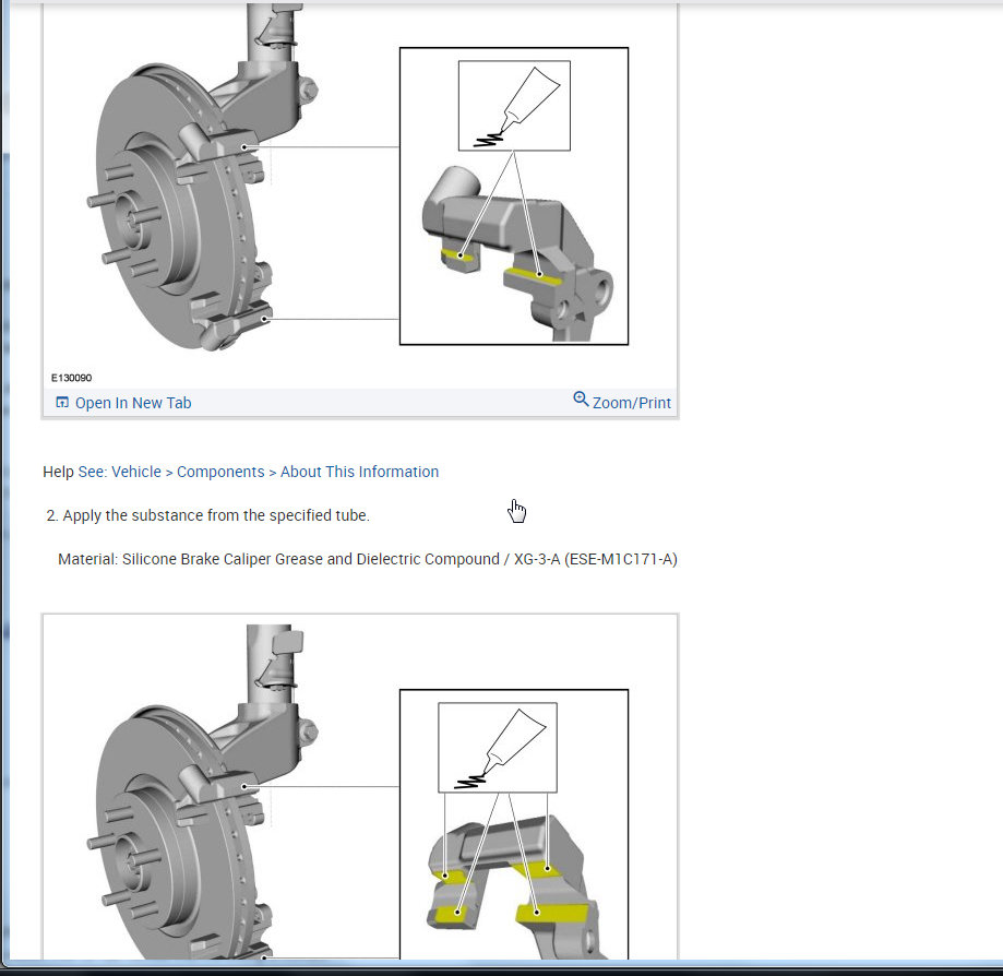

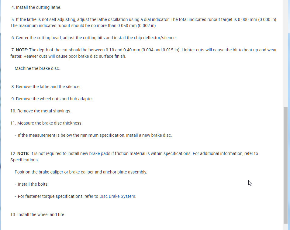

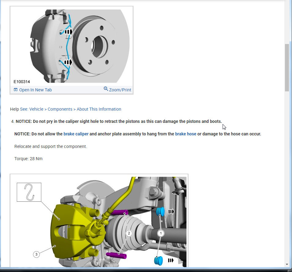

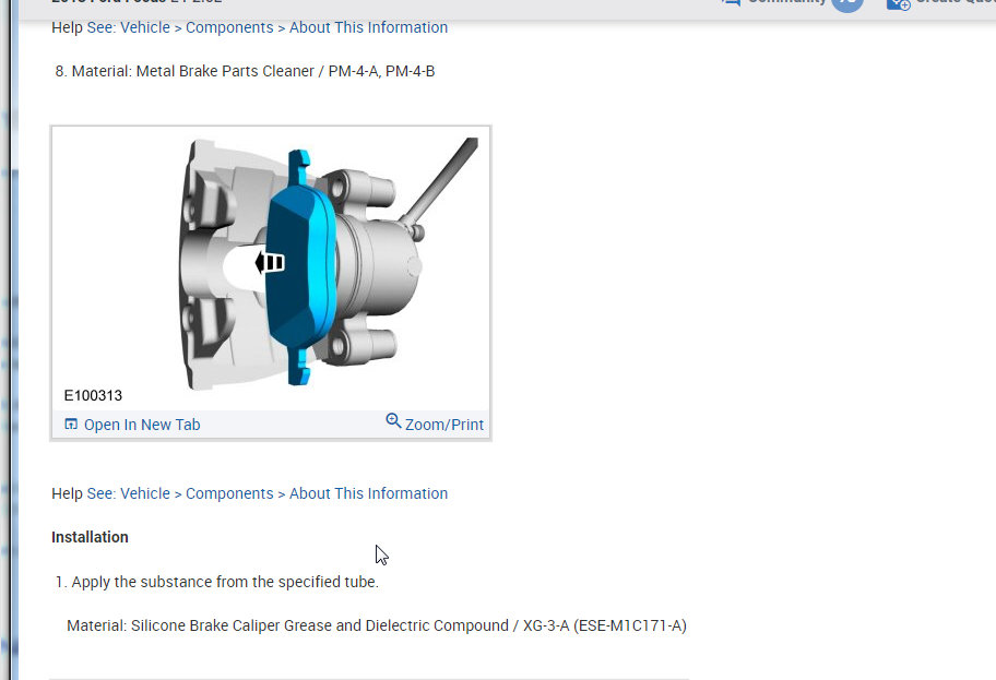

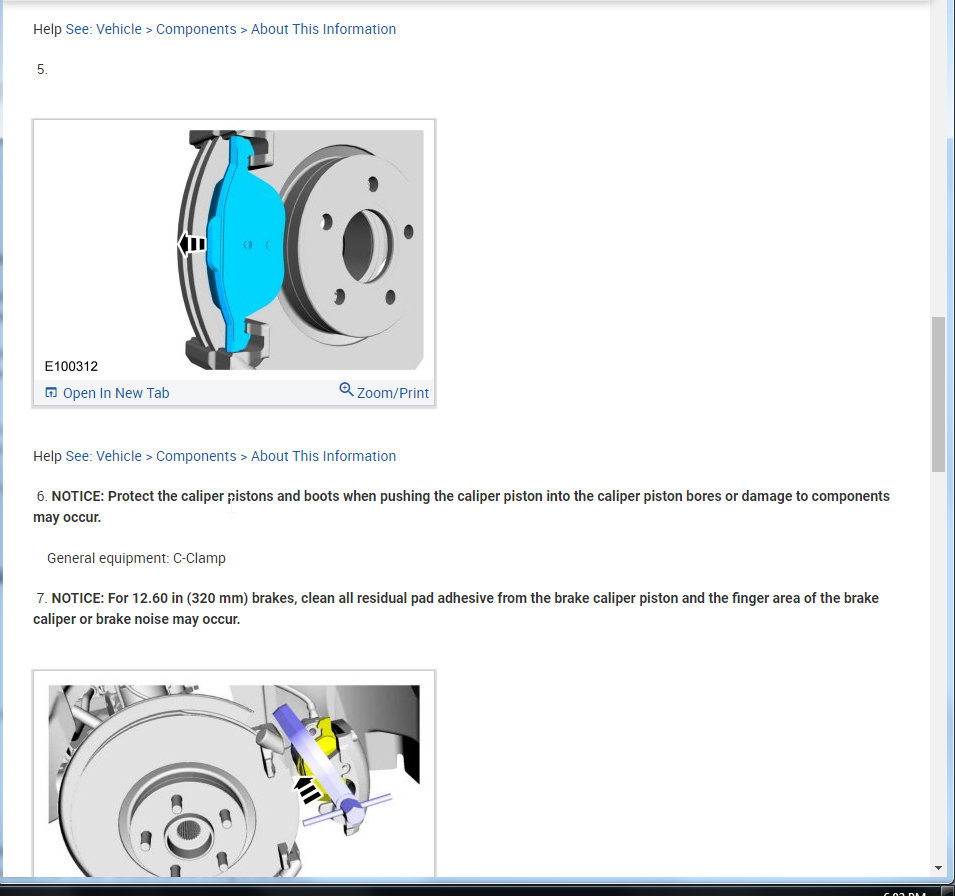

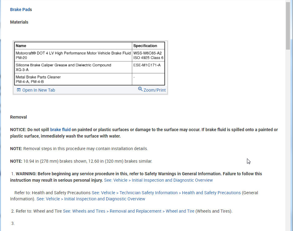

I am attaching the process on how to replace the pads and rotors. Plus here is a guide that will help with this:
As for the noise, and smell, how often does it do this? Was it just one time or can you get it to do it frequently? If you can, you may want to go down and show the dealer what it is doing so they are not missing something. Also, can you get a recording of the noise so that we can get a better idea as to what it could be?
You will find the process below for the brakes. Let us know if you have other questions. Thanks
