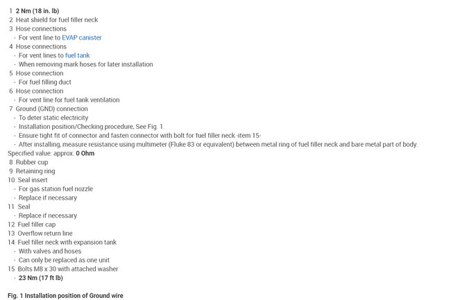

When refueling my gas tank it triggers the gas nozzle to stop prematurely even at a low rate of discharge from the nozzle. Is there anything in particular I should be looking for in being the problem?
Oct 16, 2018 at 2:06 AM
  • 55,386 POSTS

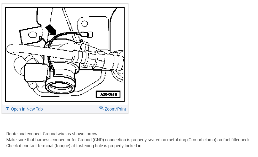

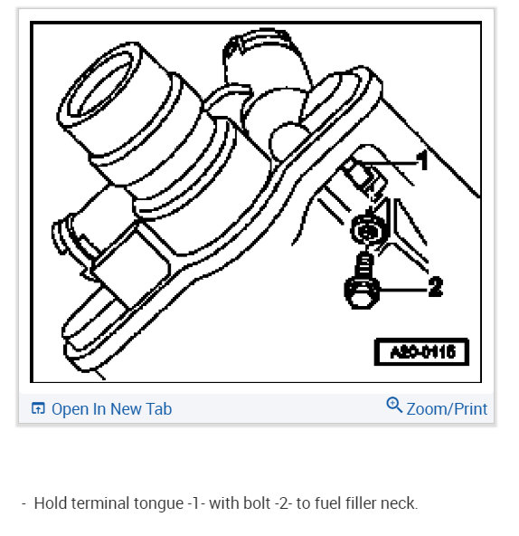

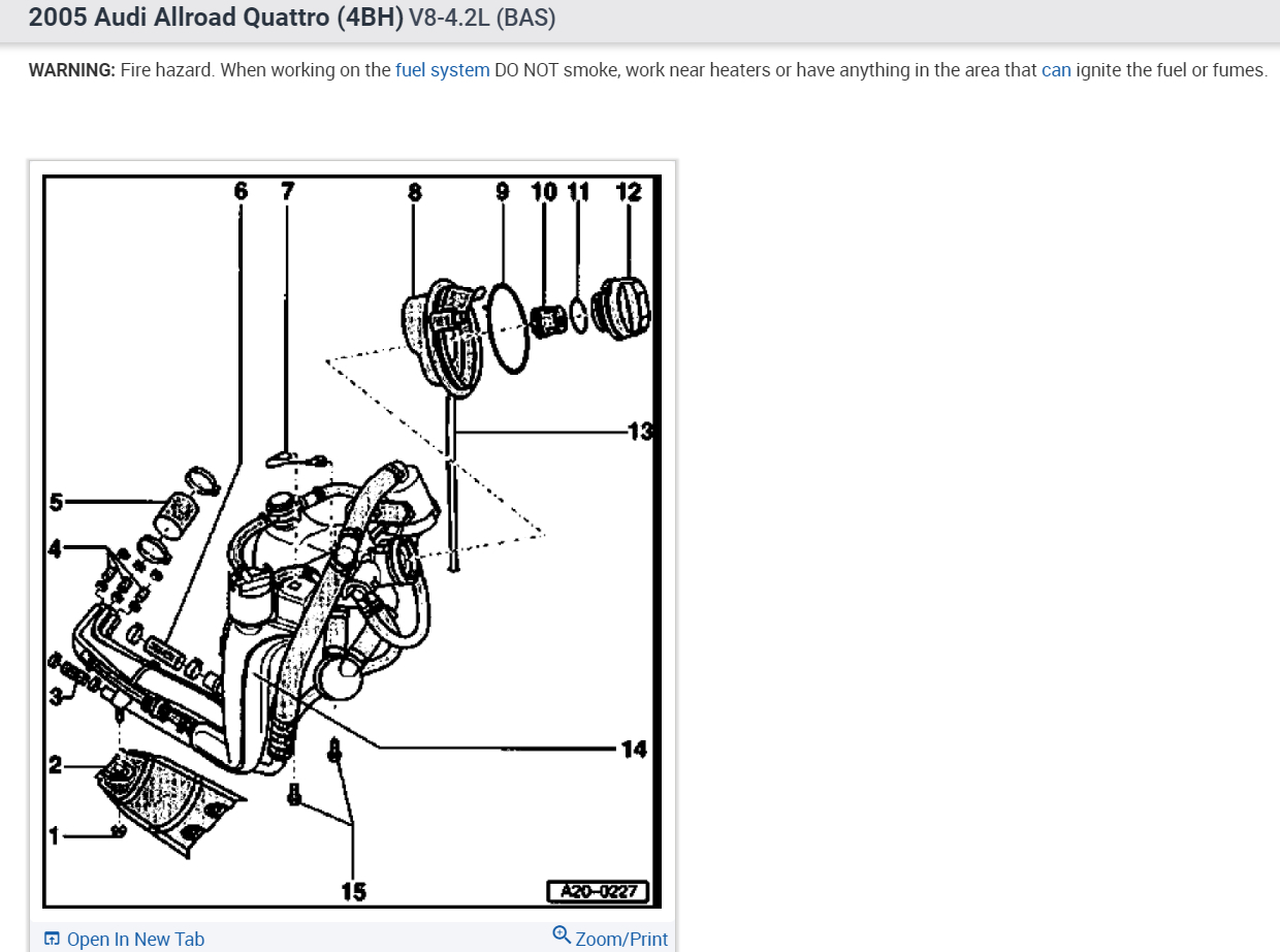

What happens is the filler neck has two hoses one inside the other which one is for air the other for fuel you will need to remove the filler neck to inspect it. Here are diagrams to help you get started.
