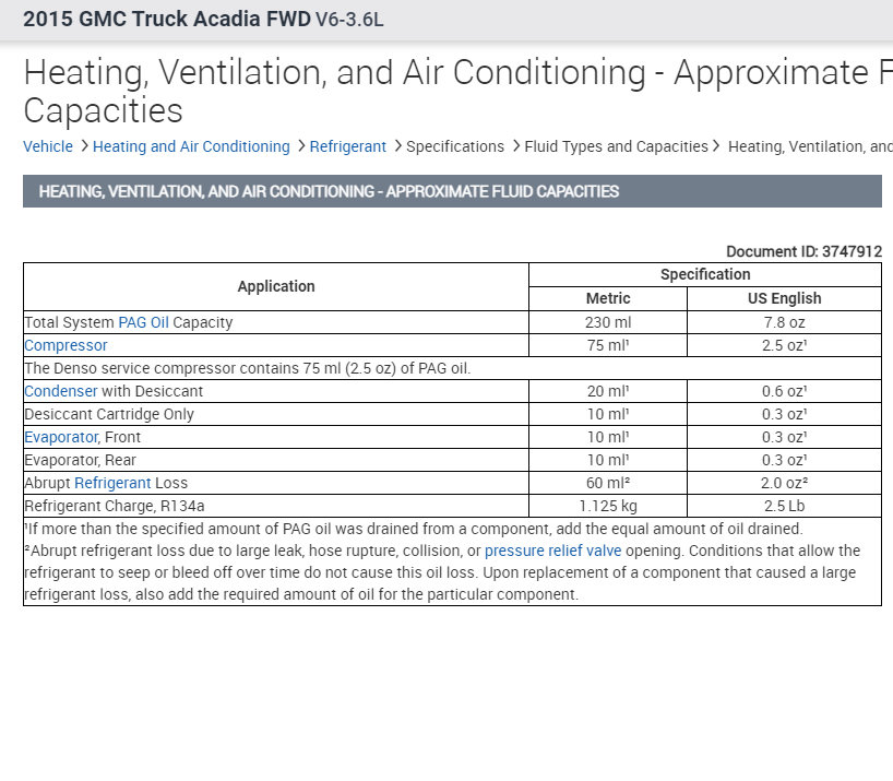

I cannot read the sticker under the hood of the vehicle that tells me how many pounds of R134a to put in the system. Can you tell me?
Jun 16, 2022 at 1:54 PM
SQM
Experienced Mechanic
6,383 POSTS
It calls for 2.5 lbs of R134a.
I have attached the chart below for your reference.
Let me know of any questions.

Thank you so much.
