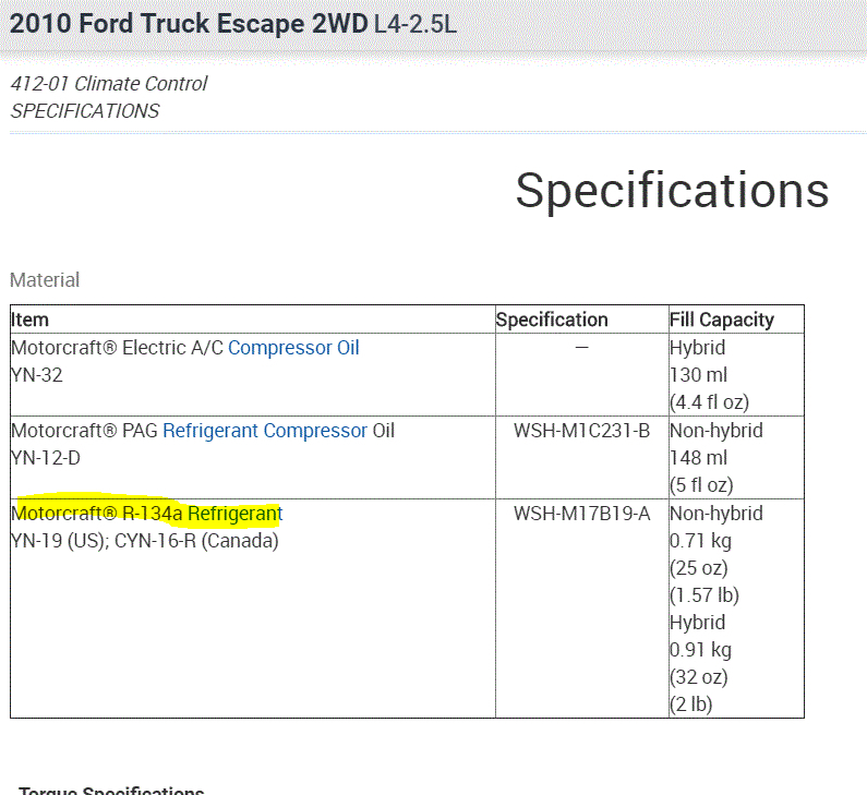

Can you tell me the total R-134a refrigerant capacity for my vehicle listed above? I just made some A/C repairs and will be charging the system (so it's completely empty right now).

I attached a pic below of the capacity. Let me know if this is what you needed or if you have other questions.

Exactly what I needed. Thank you!
