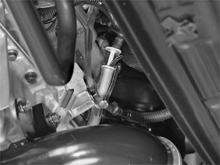

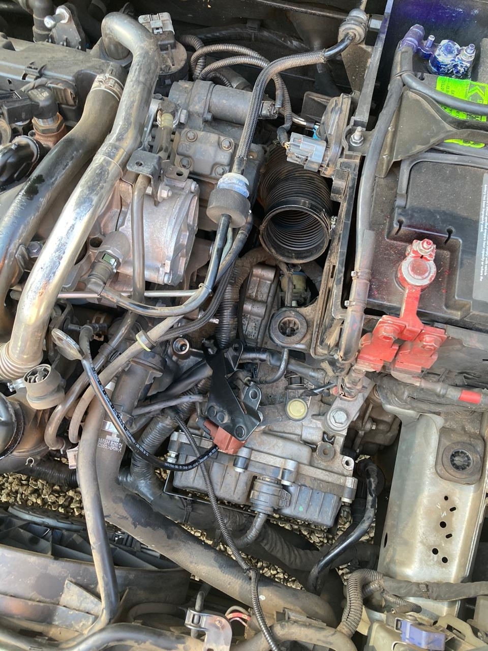

The transmission oil was drained in error.
The transmission does not appear to have a dip stick.

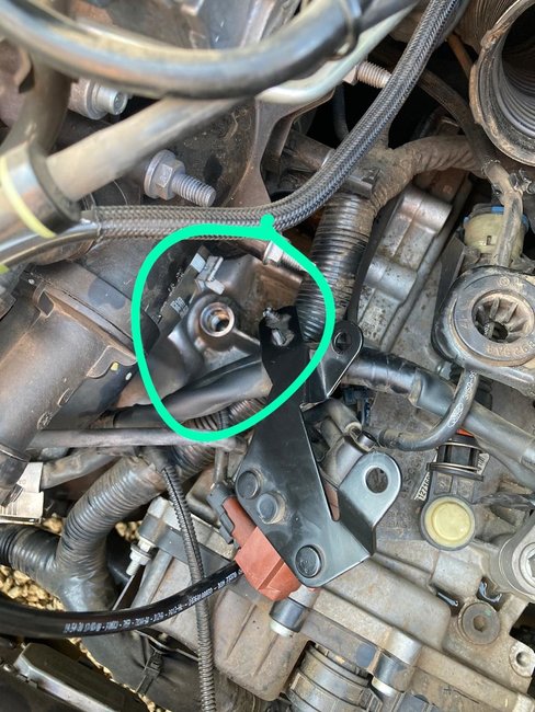

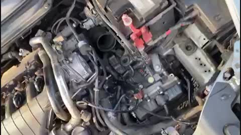

A breather type valve was located close to the engine on top of the gear box. See photo and video)
Is this where fluid can be re filled?
How does one know when the level/amount is correct ?
Cannot load video.
The breather is plastic and black in color about a 17mm size.

Managed to load images.

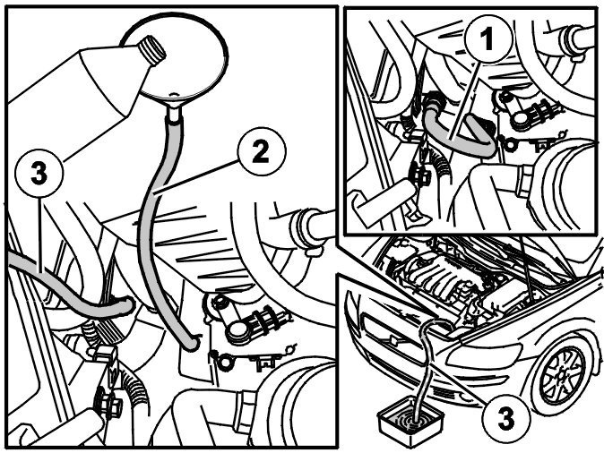

Here are directions for refilling the ATF. Note this came from the service section, so you will need to judge how much was originally removed. The attached pics correlate with the directions and the second set of directions are for checking level.

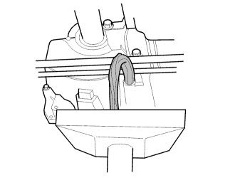

Connecting hoses
pic 1
Remove the oil line (1) between the transmission cover and the oil cooler.
Hint: The quick-release connectors for the oil line are detached by pressing the clutch housing towards the cover/oil cooler. Hold the connection housing in this position. Pull back the lugs on the connection housing. Pull the connector off the cover/oil cooler.
Connect a hose (2) to the return pipe sleeve connector on the cover. This hose is used to fill with oil.
Install a transparent plastic hose (3) on the oil cooler connecting sleeve, which runs down into a container.
Filling with transmission fluid
Apply the parking brake. Move the gear selector lever to position P.
Fill approximately 2 liters of oil through the hose connected to the transmission cover.
Start the engine. Allow the engine to idle so that the oil pump for the transmission pumps out the oil. Turn the engine off when air bubbles start to become visible in the hose.
Fill approximately 2 liters of oil again as described above. Start the engine again. Allow the engine to idle so that the oil pump for the transmission pumps out the oil. Turn the engine off when air bubbles start to become visible in the hose.
Further filling of transmission oil
pic 2
Remove the hoses from the oil cooler and the transmission cover.
Connect the oil line between the oil cooler and the transmission cover.

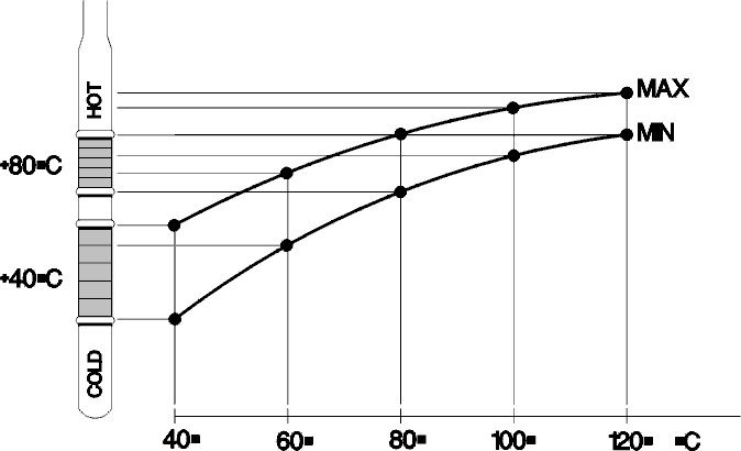

The difference between MAX and MIN volume is 0.3 liters. Check the oil temperature in the transmission.
At room temperature (+20 °C) the oil level is near the MIN marking on the "cold area".
At room temperature (+20 °C) and low oil level the oil barely reaches the dipstick.
The "cold range" (+40 °C) is reached after approximately 15 minutes idling in the workshop, while the "hot range" (+80 °C) is reached after approximately 30 minutes highway driving at an air temperature above +15 °C.
Note! Carry out the check at an oil temperature of +80 °C. Select the digital display parameter. Select the parameter for the transmission oil temperature.

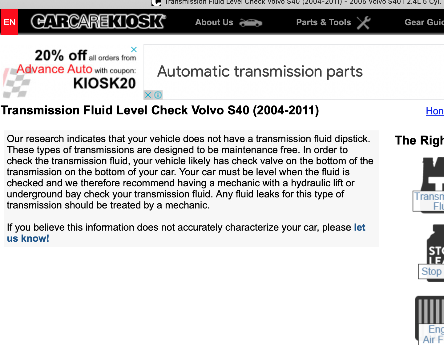

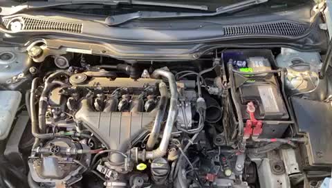

Thanks for the info. Further research has the below comment. I still cannot locate the dip stick. I have looked under the battery after removal, Below the intake pipes and searched ???
Oct 16, 2020 at 1:08 AM
  • 110,240 POSTS
The only thing I'm not sure about is the engine size. You listed a 2.0L which wasn't offered. I went with the 2.4L. Is that what you have?
Also, I went back a year and forward a year and they all show the dipstick. I was thinking there may have been a mid year change. It should be near the firewall on the driver's side of the vehicle.
