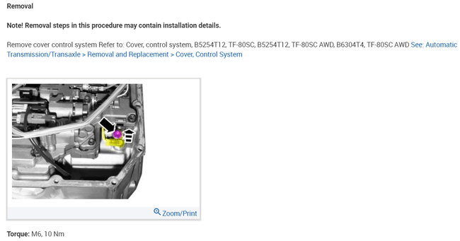

Car was serviced about a month ago at the dealer. Had no problems whatsoever. Just got in the car and the error displayed “reduced transmission performance“: V40 T4 Car does not shift gears, high revs. Switched it off and back on again. Error message was off and gears changed but gear shifted not smoothly and jerky. Revs are also still higher than usual.
Aug 8, 2018 at 10:22 PM
  • 55,694 POSTS

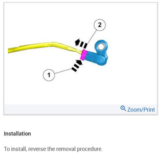

This sounds like you have a transmission turbine sensor that has gone out or is not reading correctly. Lets run the codes first to see what comes up.
Here is the location of the sensor (below).
