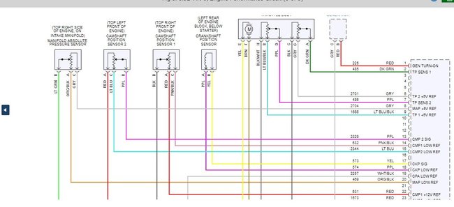

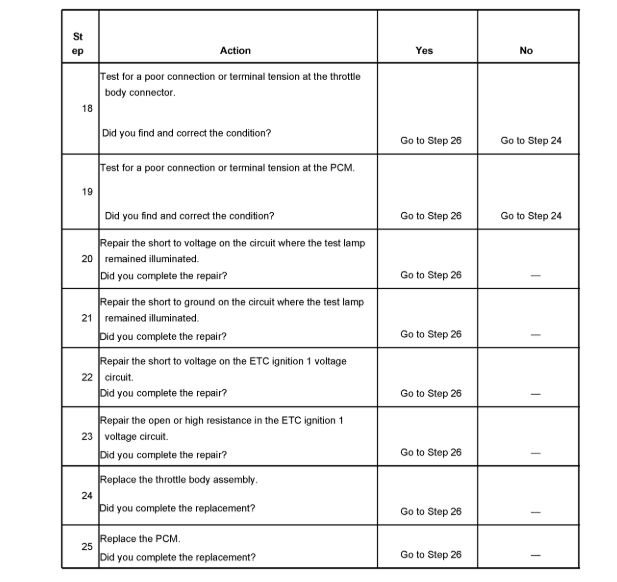

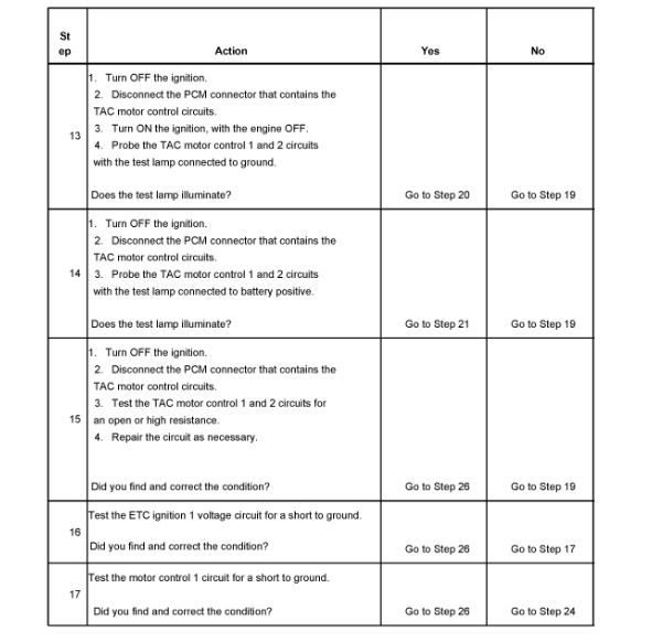

I have put a new timing chain and tensioner,and both slack bars. The variable cam is okay. I put a new APP sensor which is the complete gas pedal, and I just installed a new Throttle Body complete with TPS and TAC. Cleared the engine codes and it will not rev over 1800 RPM's. When I look at Live Data, the TPS stays at 27.2%. Even without engine running,it stays at 27.2%. It will not change when I press accelerator. When its started, it runs like shit and will not idle. Can someone please tell me what's up with my truck? Oh and before you ask, I just bought like it is. So I don't have a clue as to what it was doing before I bought it. I checked continuity between the TB and the PCM and all appeared okay.

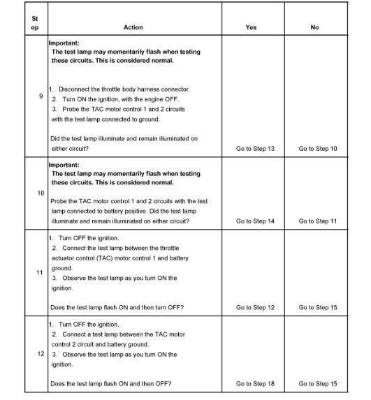

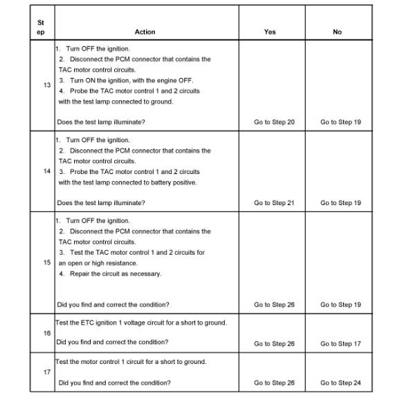

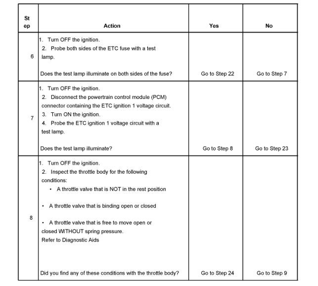

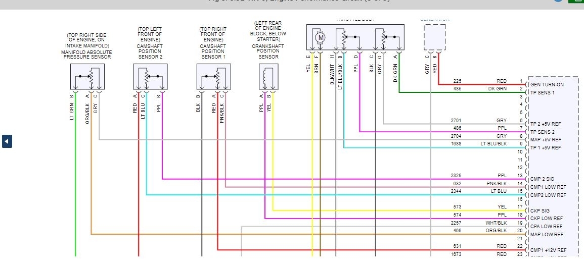

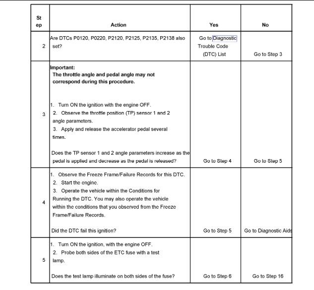

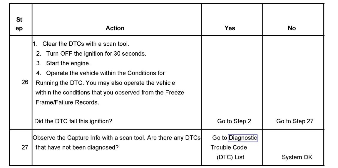

Good morning,
I attached a flow chart for you to follow for this.
We need to do some wiring testing to see if the voltages are present at the sensor.
Do you have a voltmeter to do the testing?

DTC P2101
CIRCUIT DESCRIPTION
The commanded throttle position (TP) is compared to the actual TP based on accelerator pedal position (APP) and possibly other limiting factors. Both values should be within a calibrated range of each other. The powertrain control module (PCM) continuously monitors the commanded and actual TPs. This DTC sets if the values are greater than the calibrated range.

The throttle valve is spring loaded to a slightly open position. The throttle valve should be open approximately 20 percent. This is referred to as the rest position. The throttle valve should not be completely closed nor should they be open any more than the specified amount. The throttle valve should move open and to the closed position without binding under the normal spring pressure. The throttle should NOT be free to move open or closed WITHOUT spring pressure. Replace the throttle body if any of these conditions are found.
IMPORTANT: Operating the throttle blade with the Throttle Blade Control function of the scan tool may cause additional DTCs to set. DO NOT attempt to diagnose DTCs set during this function.
The scan tool has the ability to operate the throttle control system using Special Functions. Actuate the throttle valve using the throttle blade control function located in the throttle actuator control (TAC) System menu. This function will operate the throttle valve through the entire range in order to determine if the throttle body and system operate correctly.
Inspect for the following conditions:
Use the J 35616-B Connector Test Adapter Kit for any test that requires probing the PCM harness connector or a component harness connector.
Poor connections at the PCM or at the component. Inspect the harness connectors for a poor terminal to wire connection.
