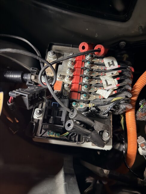

Did more reading and most say the dc to dc converter is not charging the 12v battery back and hence, similar to the alternator, and he ce would mot get out of gear. Its usually the 3 fuses inside the converter, but before i remove it to check it, they also say it could be the f100 fuse on top of the 12v battery which is a junction box. Is there a way you can see where the dc dc converter fuse if any so i can check if it is blown or not? All i see is the junction box abd then two other small fuses boxes next to the battery

Since the 12V battery has already been replaced and the same warnings remain, the next checks should be:
1. Measure voltage directly at the 12V battery posts with the car asleep/off and then again with the car awake.
2. With the car awake, the 12V system should normally be higher than resting battery voltage. If it stays around 12 volts or drops lower, the DC/DC converter is likely not charging or the battery is bad.
3. Check the F100 high-current fuse/junction fuse near the 12V battery. If that fuse is open, the DC/DC converter may not be able to feed the 12V system properly.
4. Check the smaller fuse boxes near the 12V battery for any blown low-voltage control fuses.
5. Inspect the 12V battery cables, ground connections, and junction box connections for looseness, corrosion, overheated terminals, or a poor crimp.
I would not remove or open the DC/DC converter until the external fuses and 12V feed circuits have been tested first. The converter is connected to the high-voltage system, so this is not like opening a normal alternator. Please let me know what you find.

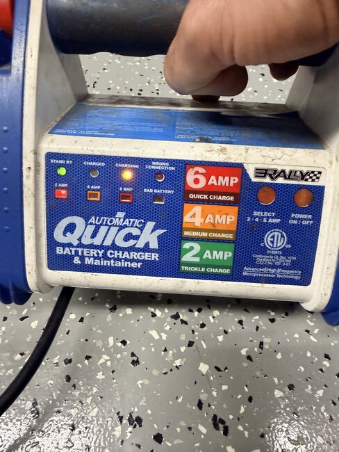

I attached this trickle charger hopefully it can get it up to 12v so i can check whether the car charges the battery or not. Charging it at 2amp. It showed the battery being bad after a minute, reconnected it and now its charging , uo to 8 some now. Will see how it goes.

What was the voltage at the battery before you connected the charger?
Jun 25, 2026 at 6:59 AM
BHAMDOC1
  • 423 POSTS
Around 6.4

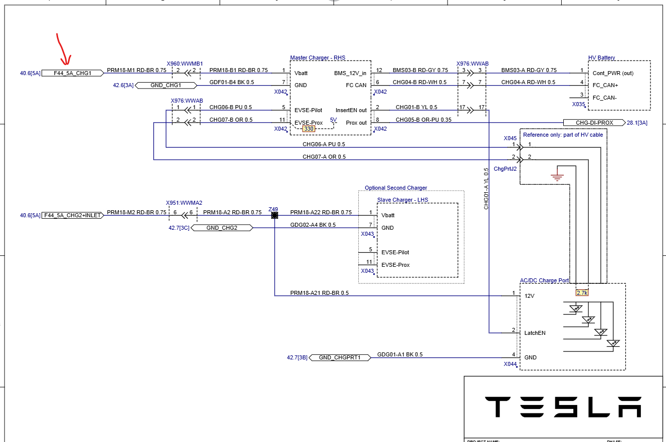

Once it is back together the car should charge the battery. Also did you double check the fuses? Here is the charging system wiring diagram so you can see how the system works. It says there is a 5 amp charge fuse.

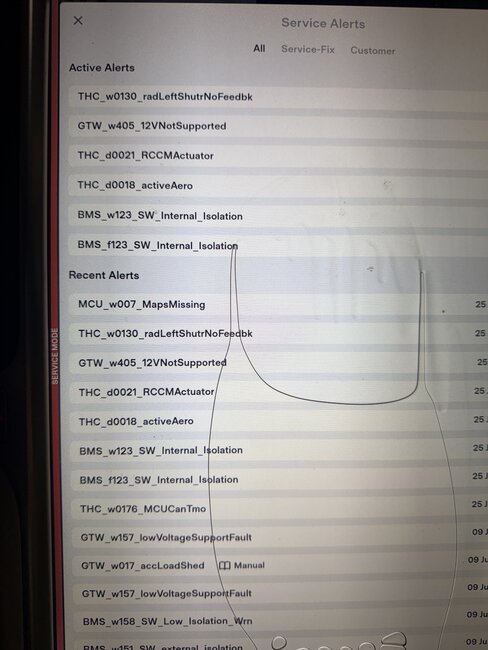

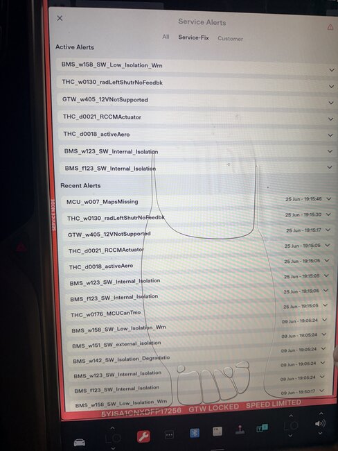

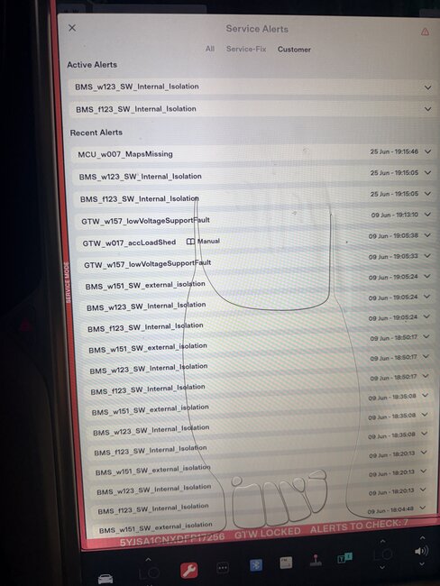

Also, noticed that there is more spark than usual when connecting the 12v, what does that usually indicate? I was able to get into the service mode and recorded the errors. I removed the negative cable again as i don't like the sound of that spark when connecting the cable. Some of the codes are under customer, all or something else so i recorded all

Yep, the large spark may not be normal, also the volts of the battery is still low, it should charge more than that, can you rig the voltmeter so you can see it and drive the car a little to see if it goes up more? With all of these codes I would clear them and run the codes again. The dead battery will trigger most of them.

This is the problem. I cannot drive it. It keeps saying cannot drive or unable to drive, service vehicle, wont come off of park.ya most of these codes were due to the low voltage. And 2 are fir the HVAC but when the ptc heater toes bad and because it is connected to the high voltage battery it can cause a drain if faulty and will render the car undrivable because it also controls the cabin heater and cooler for the large hv battery. Not sure i can delete the codes.
Jun 25, 2026 at 6:11 PM
  • 55,688 POSTS
Yep, you need to delete the codes to see what we are dealing with, scan the car with a Tesla-capable scanner and get the actual fault codes from the battery management system, drive inverter, charger/DC-DC system, and body controller. Generic code readers may not show enough information on a Tesla. It is the only way.
