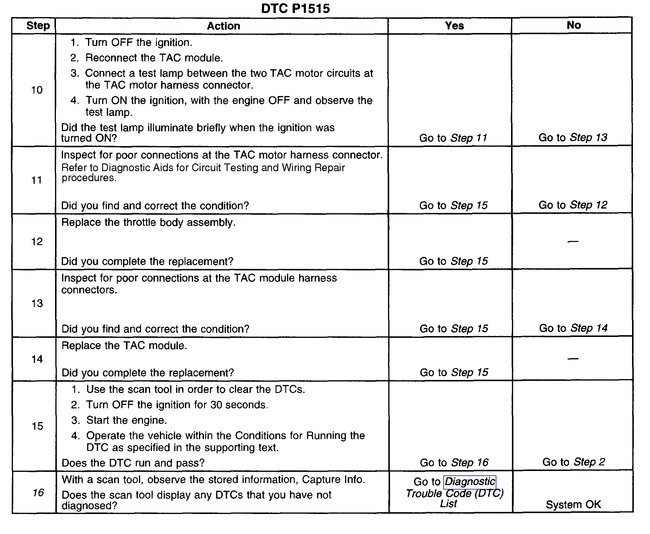

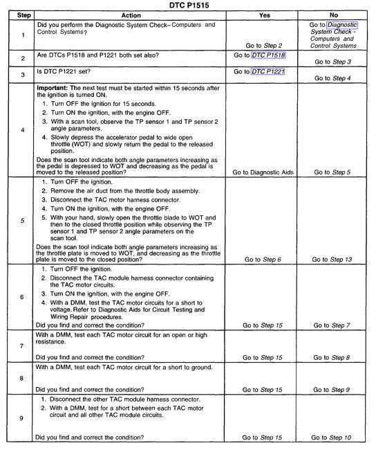

The code indicates the PCM detects that the commanded and actual throttle positions are not within a calibrated range of each other. Now, you replaced the throttle position sensor and since it seems to only happen below freezing, I would start with the following:
1) Inspect for mechanical concerns or binding that may be temperature related. Components may not move freely in extreme heat or cold due to the presence of contaminants or ice formation.
2) Inspect the TAC module connectors for signs of water intrusion.
If that all checks good, I attached two pics below which are a diagnostic flow chart for this specific code. Take a look through them and let me know if it is something you feel comfortable doing. I have to tell you, there are two throttle position sensors. For some reason, the two aren't in sync with each other. I do have to add that when both of the codes you indicated above are present at the same time, the repair flow chart sends me to first fix the 1221 code. But, since that code is no longer present, I'm providing the steps for the 1515.
I know this sounds confusing. Please feel free to let me know if you have questions or need help. Since it is temperature related, I suspect it is something simple as indicated in the above two things I asked to check.
Take care and let me know if I can help.
