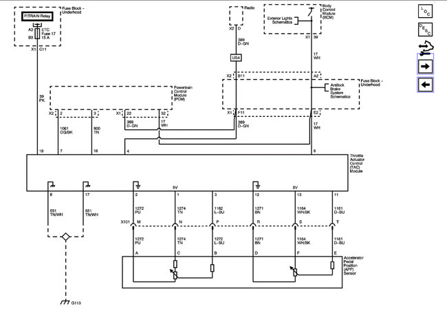

got a "reduced engine power" code and no acceleration one day after driving, put in park and reverse and then drive again. this was all of a sudden (literally). i had been driving like normal on that day. pulling out of a parking space i tried to accelerate and the gas pedal didn't give me any acceleration. I then noticed the reduced engine power notification on the screen. i luckily was able to cross the street to an auto part store. the OBD codes came up as: P0411, P0128 (third was a repeated code and U0107. By the time I got to the auto part store the gas pedal went all the way to the floor with no change in the sound of engine revving or idle. The weirdest thing is that a day or two later, my boyfriend was able to get it started and move then it cut out again. He has changed the thermostat, water pump (he noticed it was leaking/spitting a bit) and serpentine belt. a mechanic Budd advised to clean the throttle body (I'm not sure how clean it has to be) and tried changing out the pedal with one he got from a junk yard car. he currently is checking/changing out spark plugs/wires. The only other thing that we've been advised to do is to check the fuel pump so that's next.

There is a loss of communication between the throttle position sensor on the throttle body and the accelerator position sensor on the gas pedal. This is usually the result of a serial data circuit and not a faulty component.
Now, interestingly, this car came with either a 5.3L V8 or a 3.8L V6. You indicated a 5.3L V6. I need confirmation on the engine size. Two of the codes you provided are not relevant for the 5.3 V8.

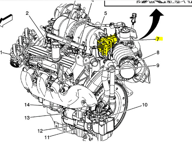

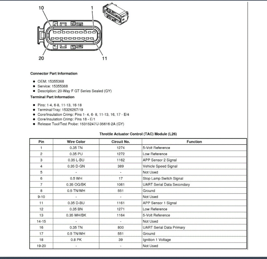

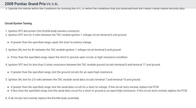

If it is the V6, I provided the diagnostics for the breakdown in communication. Pic 1 shows the diagnostics, pic 2 shows the wiring schematic, pic 3 shows the pin orientation at the throttle actuator control module. That is where the testing will need to be done to identify what is happening. Pic 4 shows the TAC module.

See pics below
PS: This has nothing to do with the fuel pump or spark plugs/wires.
