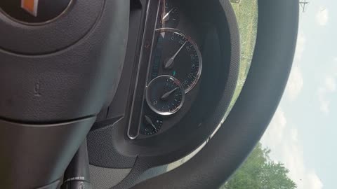

So, I am driving down the highway there is a whining sound coming from the engine and the whine is very constant. The whine gets louder as the engine gets faster. But as the engine slows down so does the whine in the engine. I have an older mechanic that doesn't know lot about electronic assisted vehicles and he can't explain the noise nor the reduced power. Also the reduced power started when the noise did and the noise is not always there so there for I don't always have reduced engine power.

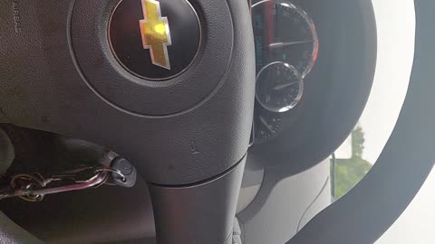

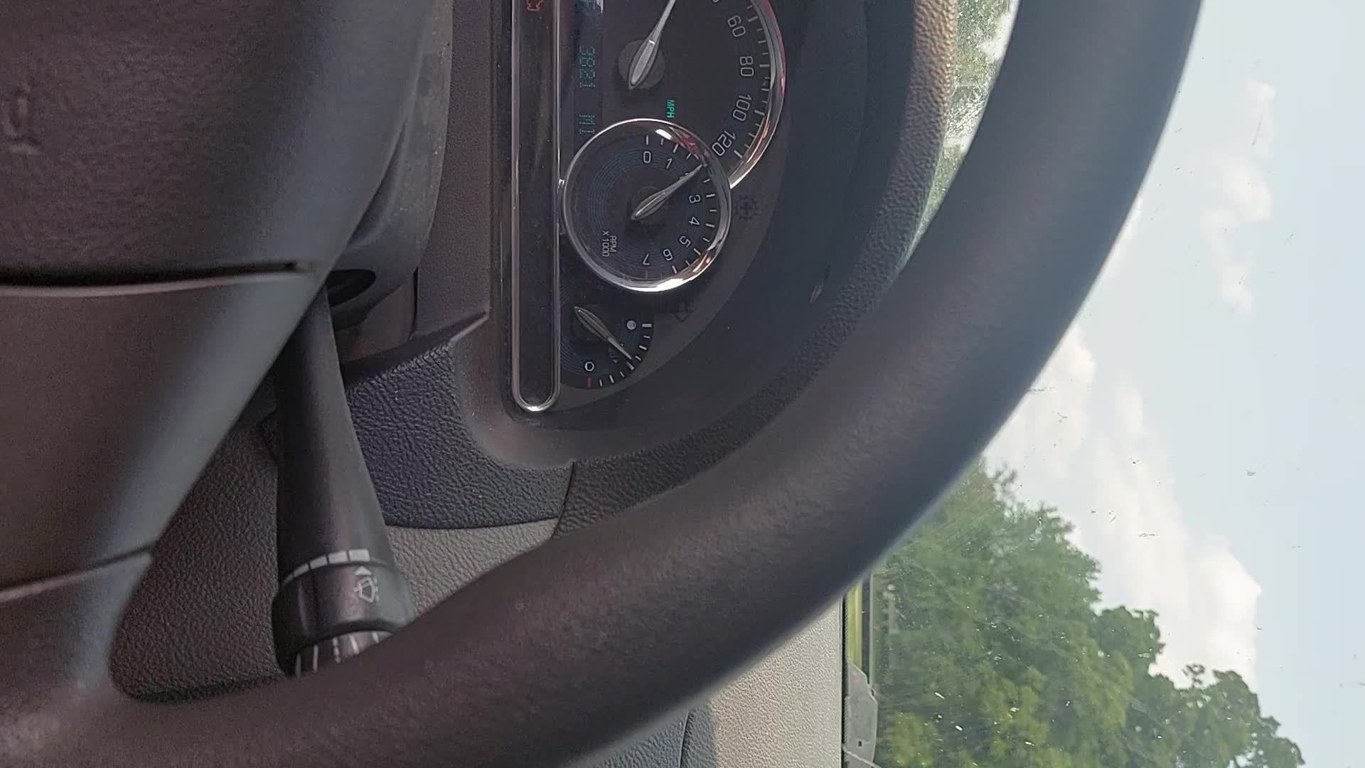

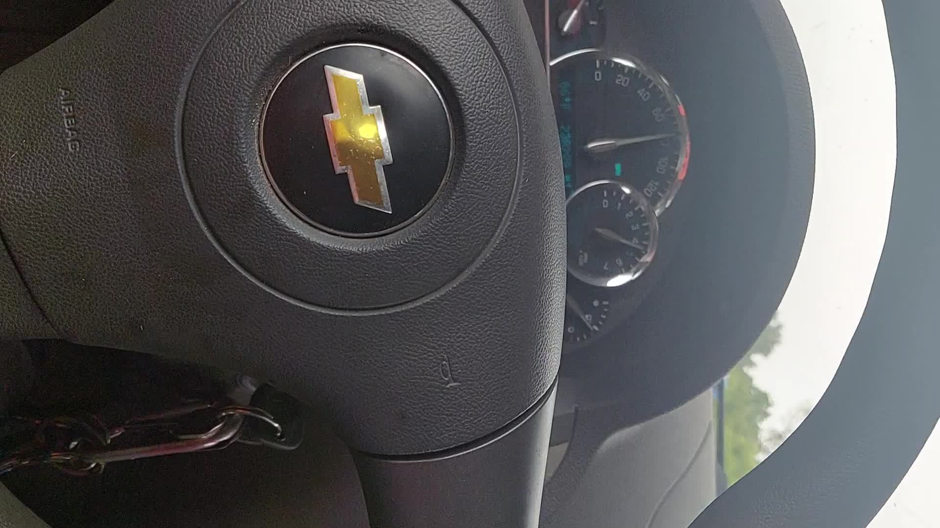

No, I haven't made any more progress. Seeing how the vehicle is not throwing any codes and I'm not having drivability problems I use this vehicle to get to work about 2 hours worth of driving everyday driving the morning it drives normally but on my way home is when I have the whining noise. I've posted 2 videos one with the whining noise and lower engine power and one without. But I've also noticed that since the whining noise has started I've been only getting around 22 MPG when I use to get around 28 to 30 MPG.

There does not need to have any codes for a mechanical issue. This is not an electronic issue, it is mechanical.
This could be a bearing related to the drive belt or something driven by the drive belt.
It does sound like it is coming from the engine and not anywhere else.
I would start by removing the drive belt and spin all the driven pulleys to see if any make noise.
