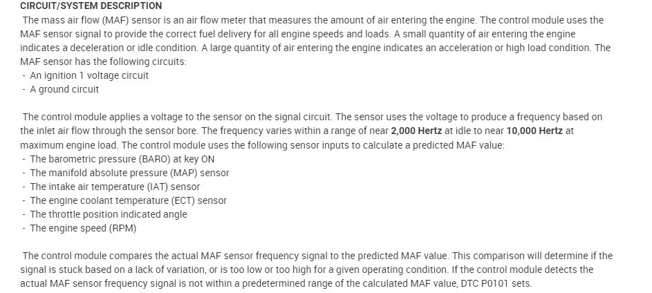

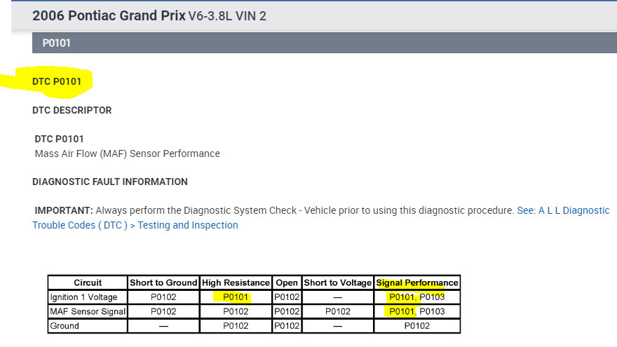

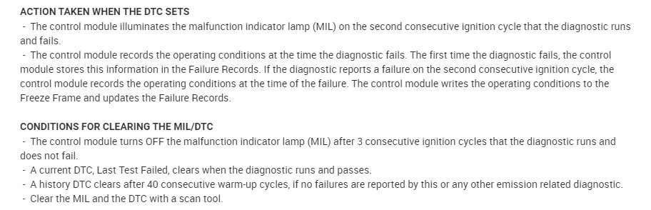

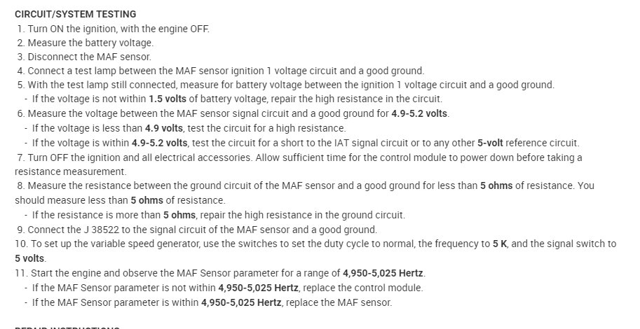

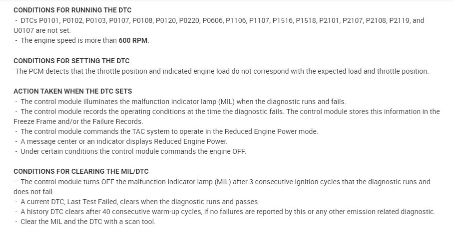

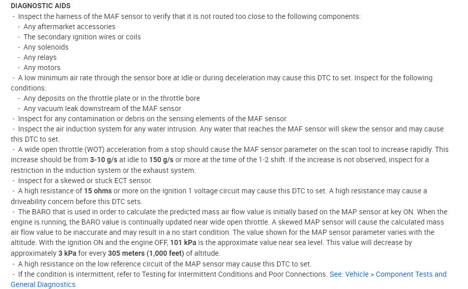

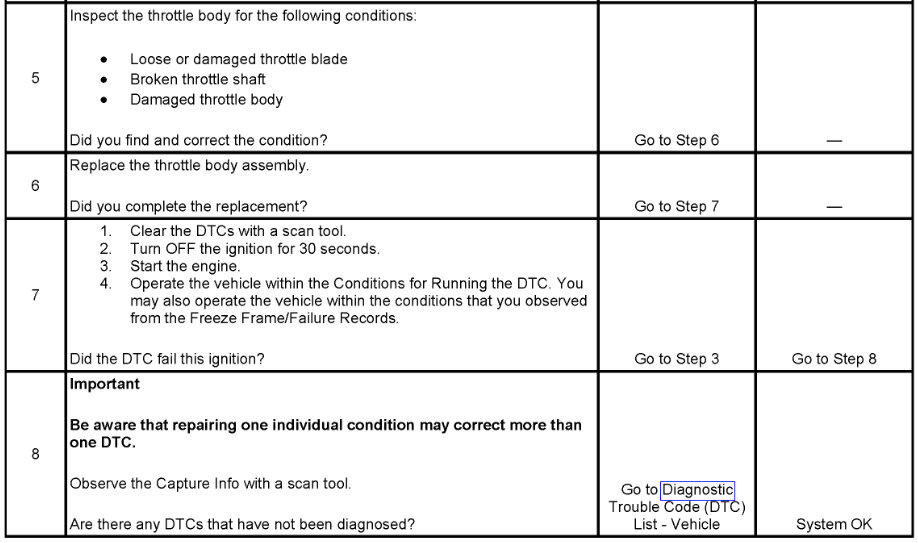

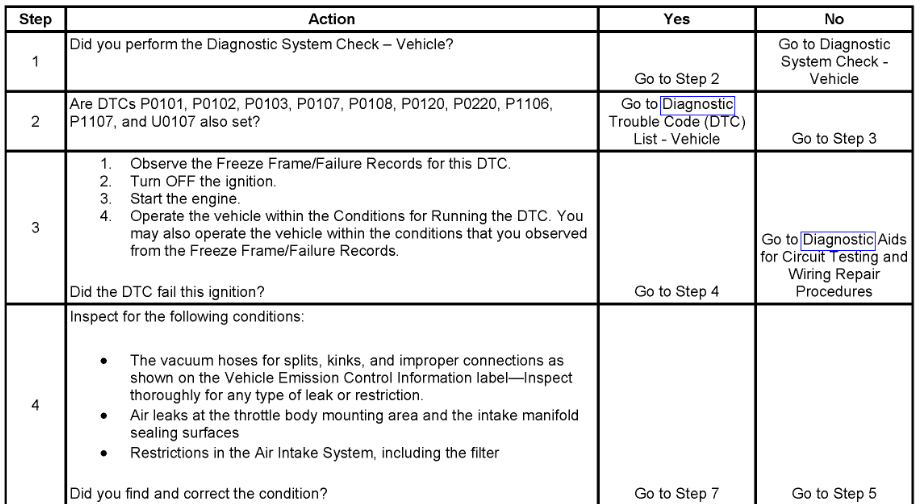

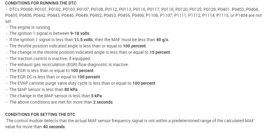

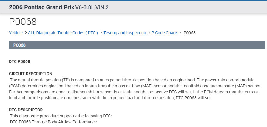

Are the same codes present? I looked at them and suspect we have a wiring issue. You already replaced the related parts, so we need to see where there is a variation from the specs.
If you look below, I started with the P0068 code. The diagnostics for the P0101 follow.
Take a look through them and let me know if you are comfortable performing them.
