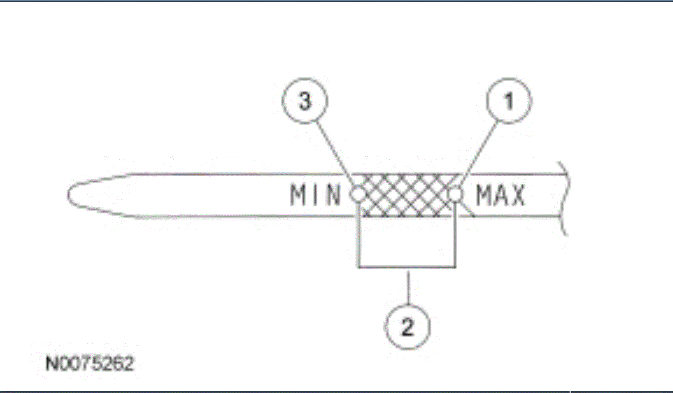

takes off fine reverse works just does not want to go 2nd to 3rd unless let off gas.

Also, if you haven't already, make sure the transmission fluid is clean and full. Here are the directions for testing and preliminary checks. The attached pic correlates with these directions.

Transmission Fluid Level Check
NOTICE: The vehicle should not be driven if the transmission fluid level is below the bottom line on the transmission fluid level indicator and the ambient temperature is above 10°C (50°F).
NOTE: Transmission fluid expands when warmed. To obtain an accurate transmission fluid level check, drive the vehicle until normal operating temperature is reached, approximately 32 km (20 mi).
NOTE: If the vehicle has been operated for an extended period at high speeds, in city traffic, during hot weather or while pulling a trailer, the vehicle should be turned OFF for approximately 30 minutes to allow the transmission fluid to cool before checking.
NOTE: Incorrect level may affect the transaxle operation and could result in transaxle damage.
Under normal conditions, there is no requirement to check the transmission fluid level. However, if the transaxle is not functioning correctly, the transaxle may slip, shift slowly or there may be some sign of transmission fluid leakage, the transmission fluid level should be checked.
Drive the vehicle 30 km (19 mi) or until the vehicle reaches normal operating temperature.
Park the vehicle on a level surface and engage the parking brake.
With foot on the brake, start the engine and move the selector lever through all the gear ranges. Allow sufficient time for each gear to engage.
Place the selector lever in PARK and leave the engine running.
Remove the transmission fluid level indicator and wipe it clean with a lint-free cloth.
Install the transmission fluid level indicator, making sure that it is fully seated in the filler tube.
Remove the transmission fluid level indicator. The transmission fluid should be within the designated areas.
See pic 1
Item Description
1 Maximum transmission fluid level
2 Normal operating transmission fluid level range 49°C-60°C (120°F-140°F)
3 Minimum transmission fluid level

Sorry took so long to get back to you, lot going on. First id like to say i found out that friend put ABS sensor in backwards. So there is a start Also i believe i told you first can reading said shift solenoid D stuck on. So went to Reds transmission bought D and replaced it then friend switched with another that looked the same still comes back d stuck on. i have spent a lot of time and something (besides the ABS) i have found is the wheel speed sensor. i say this because of the shifting engine revving up if let off gas it goes ahead and shifts. i am going to take to AutoZone to test can maybe i am not using it right.
