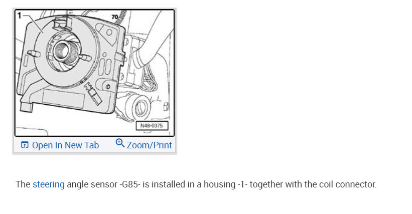

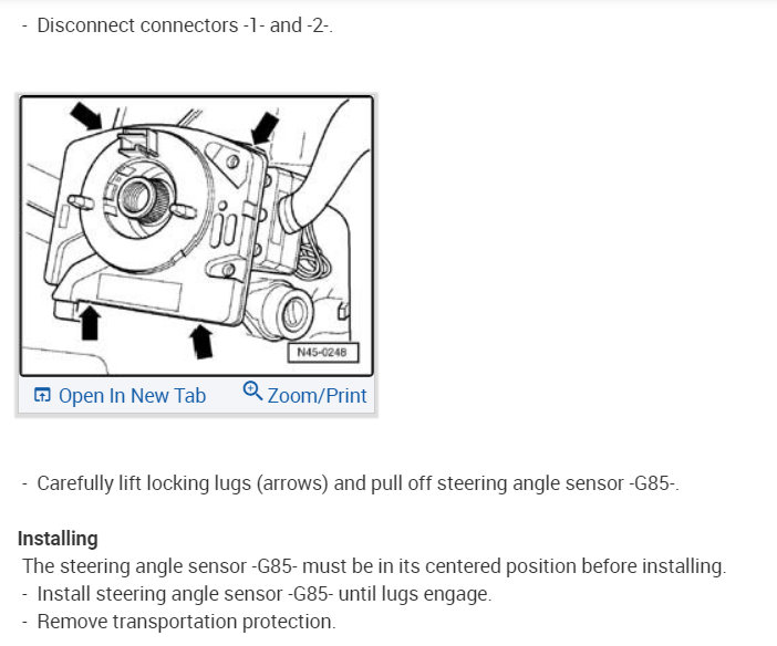

Yes, the red wheel means you have a problem with the steering system. probably the angle sensor or steering motor going out. to be sure you need to scan the system this video will show you how:
https://youtu.be/InIlnsjOVFA

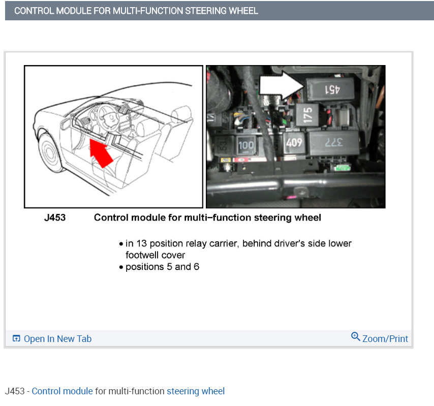

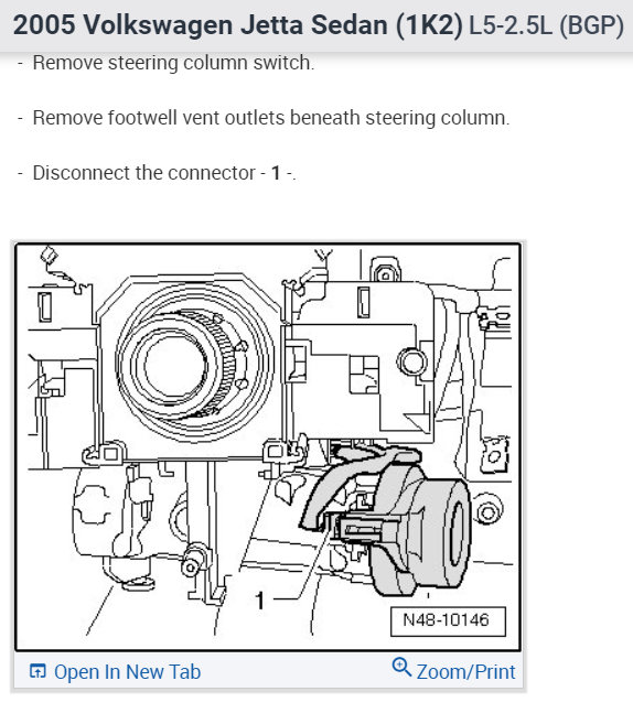

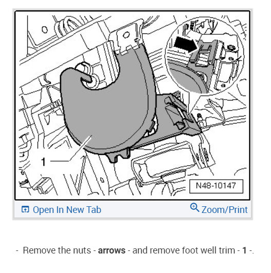

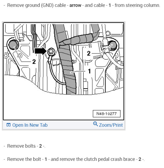

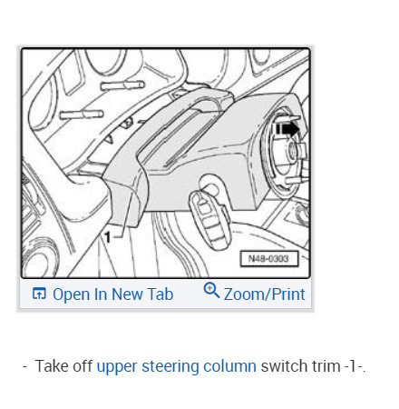

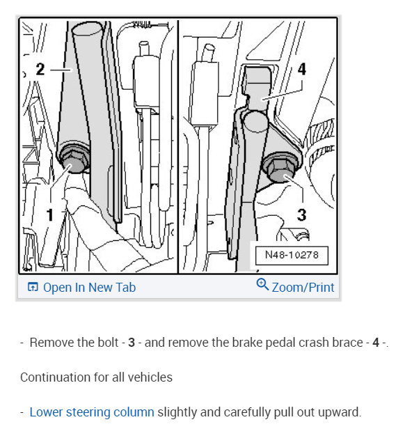

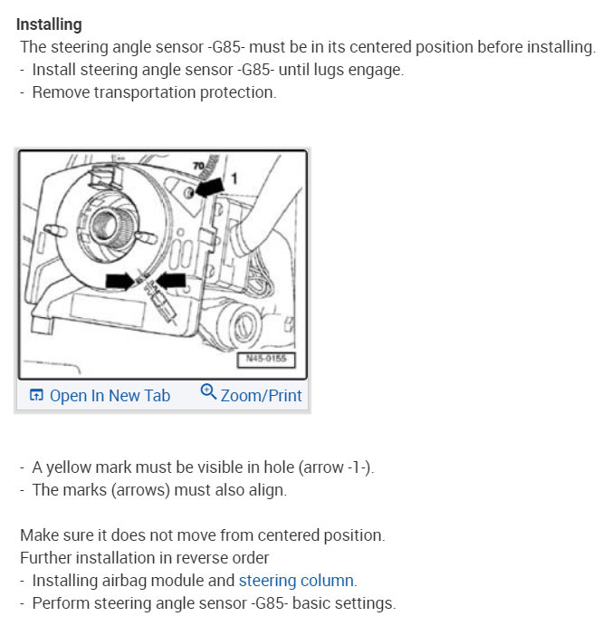

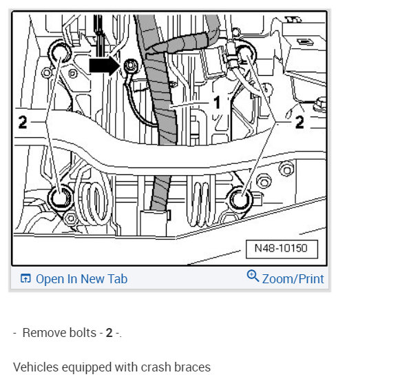

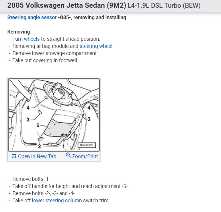

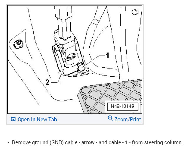

Here are diagrams and instructions on how to change out the module and steering sensor
May 9, 2019 at 6:31 AM

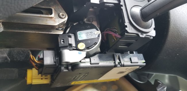

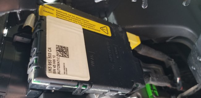

I was messing with the steering wheel cover and it's actually broken. so i was able to pry it open and I can see what I believe is the angle sensor.
Jun 1, 2019 at 3:22 AM
IVAN AZCUE
  • 25 POSTS
Pictures.
Jun 1, 2019 at 3:27 AM
  • 55,423 POSTS
The sensor is under the steering wheel which needs to be removed to replace the sensor but you should be able to turn the wheel. I am wondering if the steering motor is lock up? Can you please shoot a quick video with your phone so we can see what's going on, that would be great. You can upload it here with your response. Let me see you trying to turn the wheel please.

With the cover off I was able to remove the airbag. I stopped there since I didn't have the tool to remove the steering wheel bolt.
If the motor can lock up i think it did. what does that mean? can the angle sensor still fix that?
Jun 1, 2019 at 9:54 AM
  • 55,423 POSTS

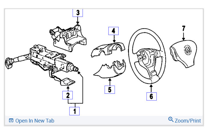

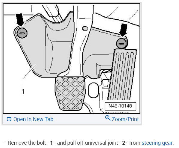

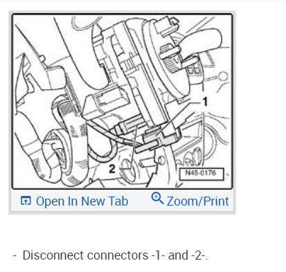

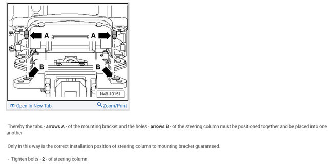

Yep, the steering motor looks like it is locked up. Let keep taking it apart to see what you find. do you need any other diagrams or?
Jun 4, 2019 at 3:01 AM
IVAN AZCUE
  • 25 POSTS

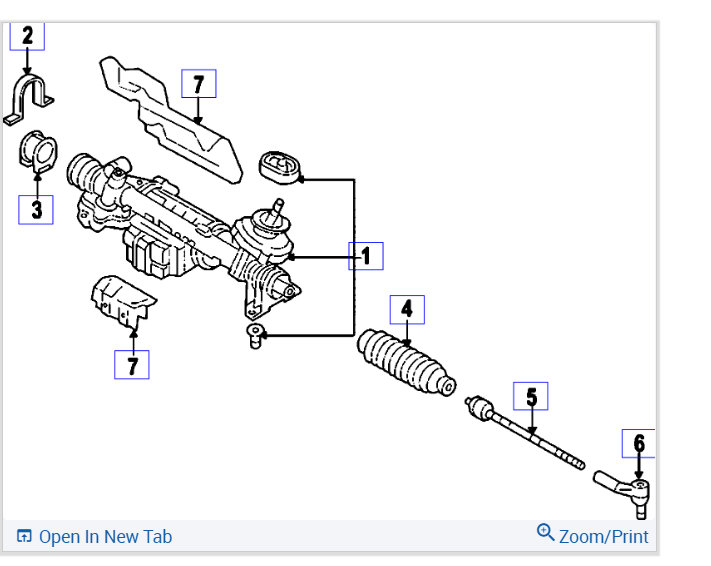

yea please. would that be the whole rack we are talking about?
I'll need a starting point, so yes on the diagrams. thanks
Jun 4, 2019 at 3:55 AM
IVAN AZCUE
  • 25 POSTS
could it be the steering wheel lock gas gone bad? any diagrams for it?
Jun 4, 2019 at 4:04 AM
  • 55,423 POSTS
Here is what I found let me know if you need more. Check out the diagrams (below). Please let us know what happens.
Jun 4, 2019 at 5:02 AM

Hi Ken, I got the steering wheel off and when I remove the clock spring I realize the clock Spring does not rotate and fact it only moves slightly left and slightly right... Does that mean my clock spring is bad and could that be the issue? With the clock spring removed could I put the steering wheel back in turn the key on and see if the steering wheel works or is that a no no?
Jun 14, 2019 at 8:32 AM
  • 55,423 POSTS
Yep, it sounds like it is bad. I would get a new unit and install it. you can try installing the steering wheel to see what happens but you will have warning lights on for the airbag, horn wont work etc.

Hey Joe, thanks for the follow up. The rack n pinion actually went out and had to be replaced all the sensors were good
