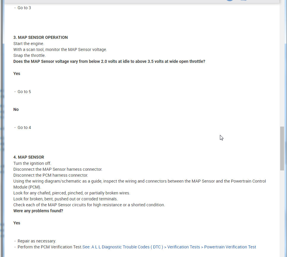

I bought my car in December '19 and decided it was time to change the spark plugs. The only issue prior to the change was some hesitation when I initiated acceleration. My neighbor who is familiar with regular auto maintenance assisted me. O'Reilly recommended Champion Double Platinum 7034 and we verified all were gapped at .050 in. When I drove the next day, I was at a stoplight when the lightning bolt and traction control lights pop up then my car went into limp mode. I can temporarily fix the problem by turning it off and then on. There were 3 codes pulled:
C121C

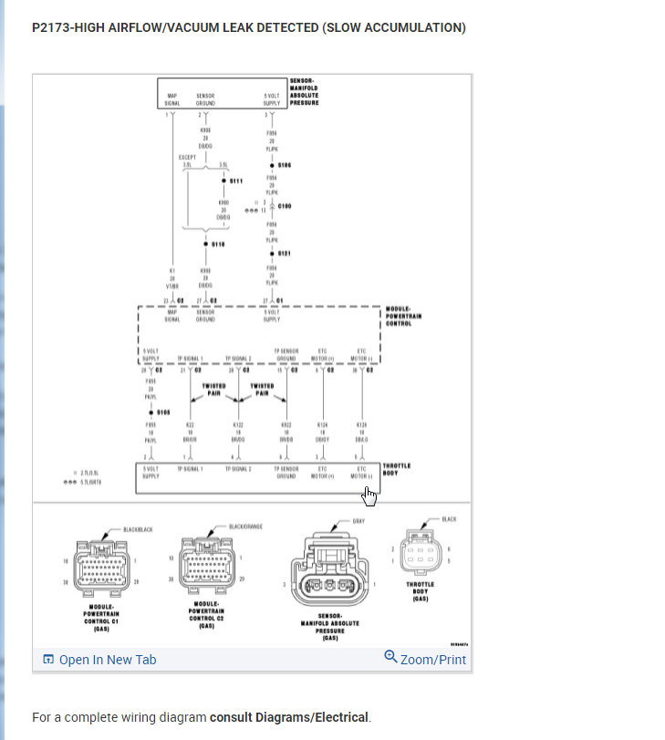

P2173

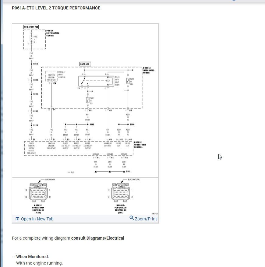

P061A
Apr 25, 2021 at 12:30 PM

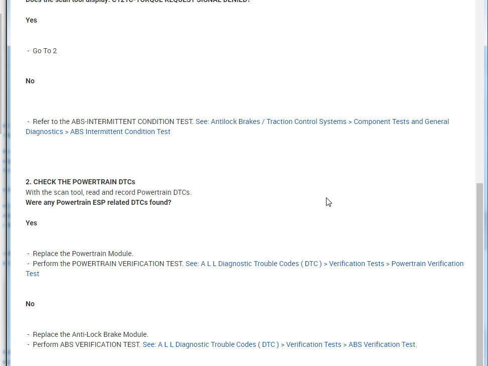

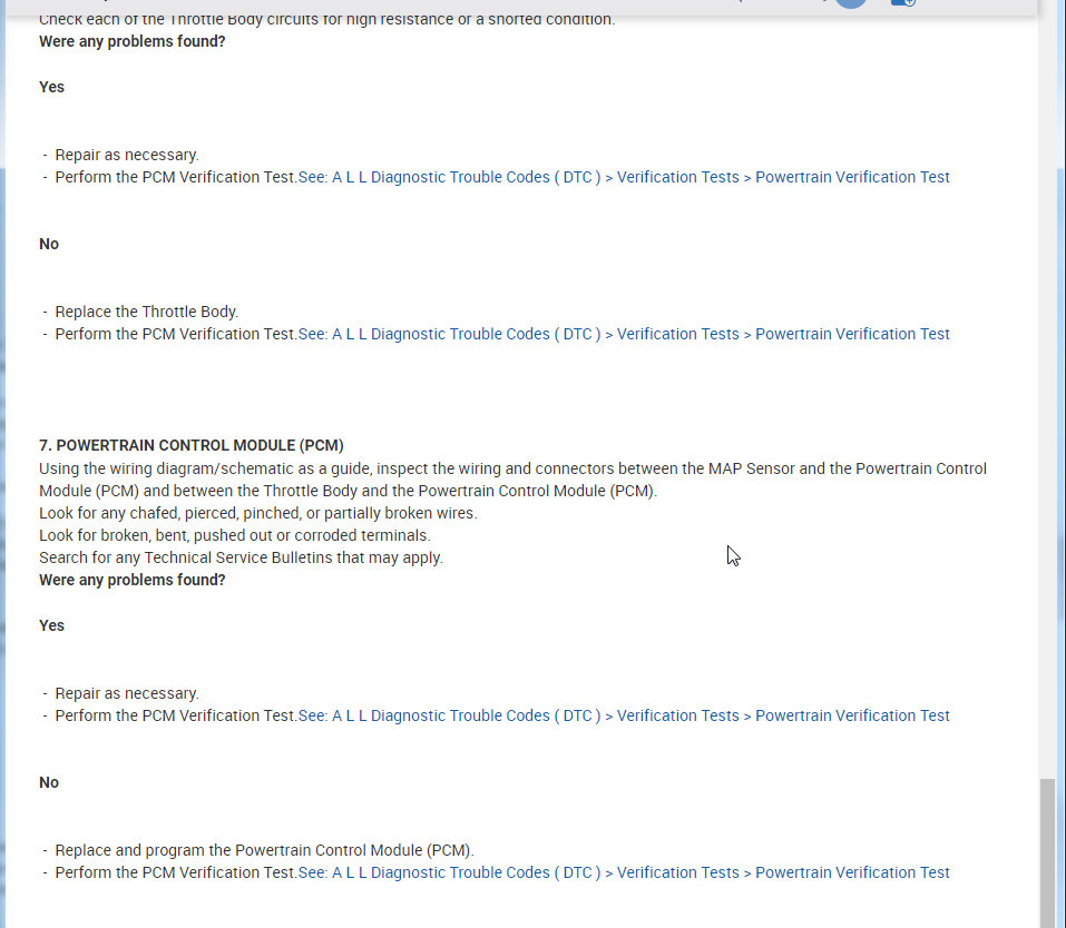

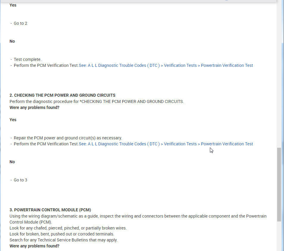

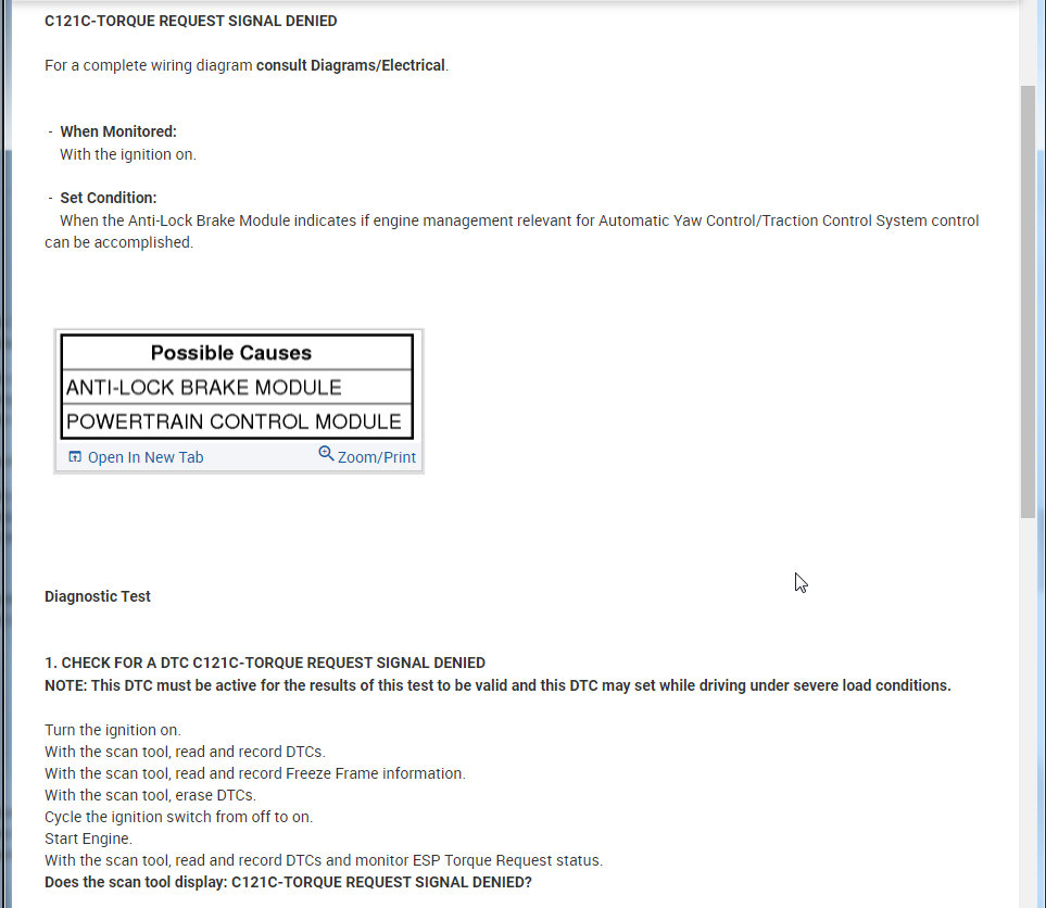

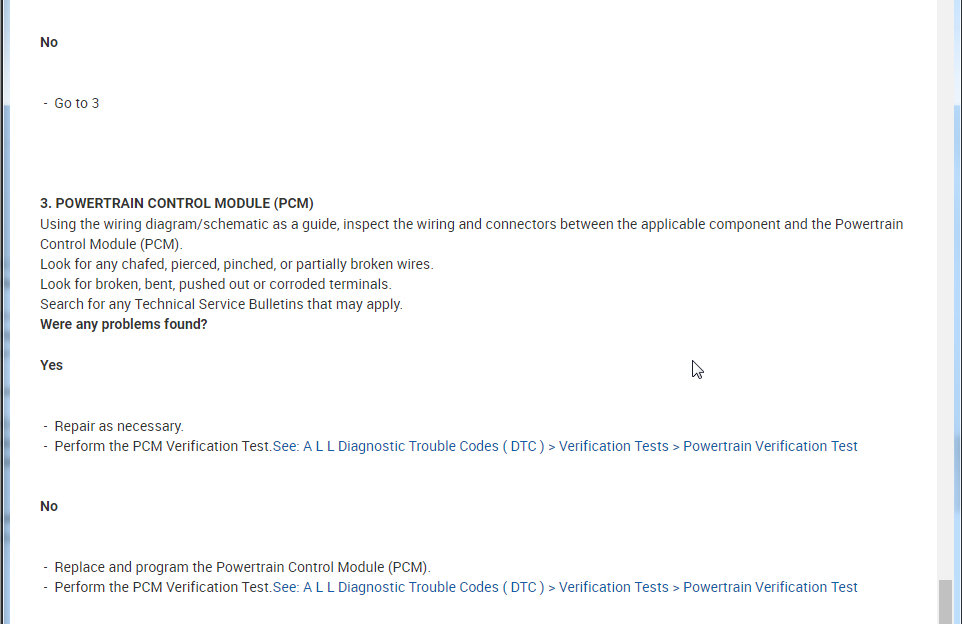

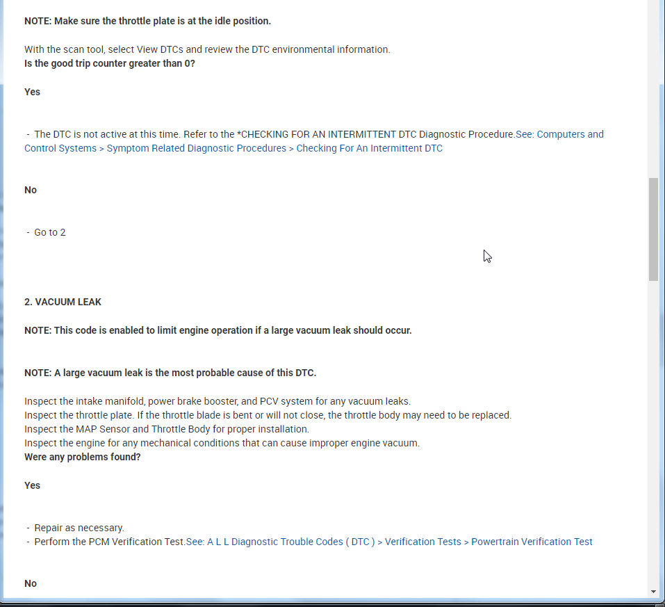

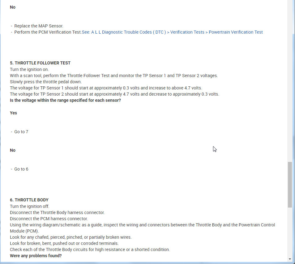

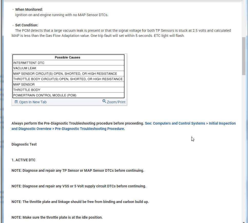

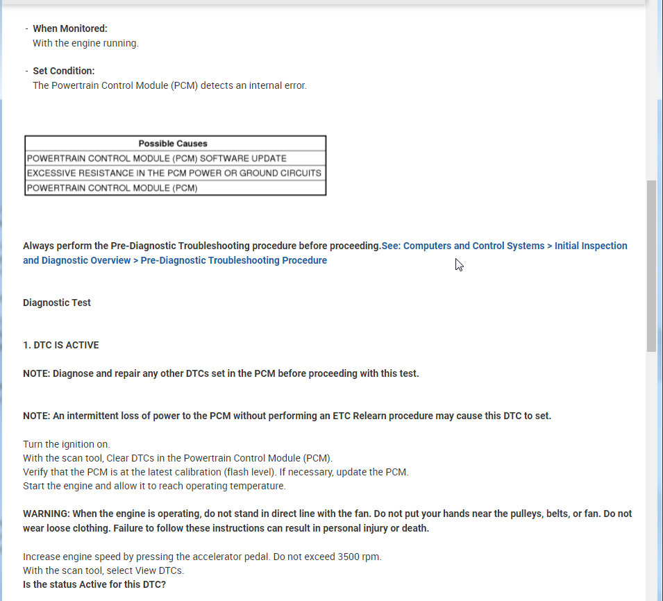

I doubt this is related to the spark plugs so I would suggest starting with the P2173 code. I supplied the testing for all these codes below.
Please run through this material and let us know if you have other questions and what you find. Thanks

Totally understand. Unfortunately these coincidences happen frequently. It could be related to the repair if something was left unhooked or damaged but it would not be the plugs themselves.
Please let us know if you have other questions or what you find. Thanks
