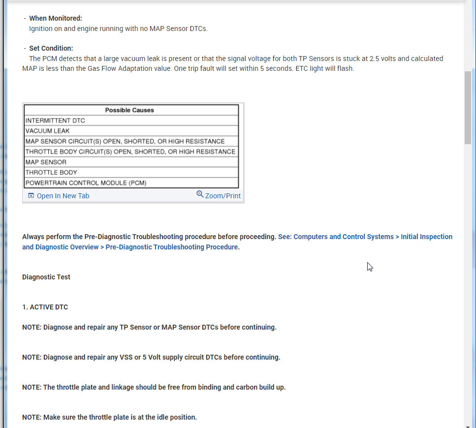

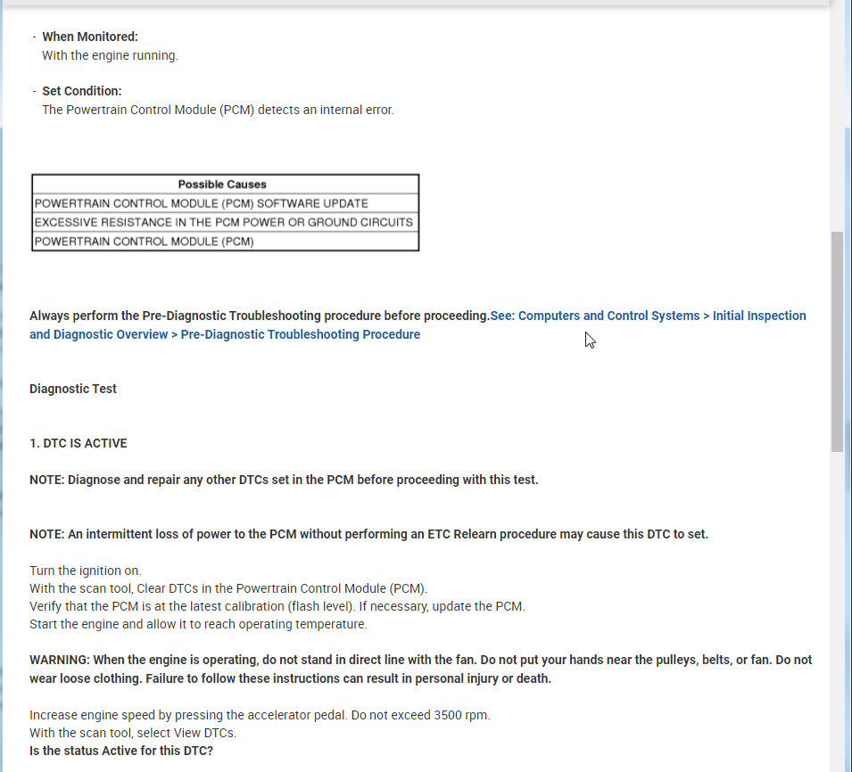

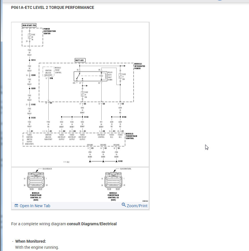

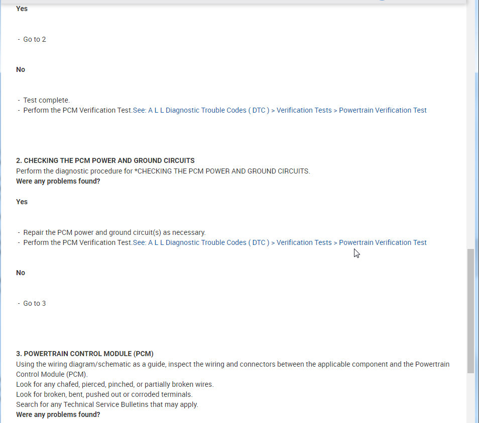

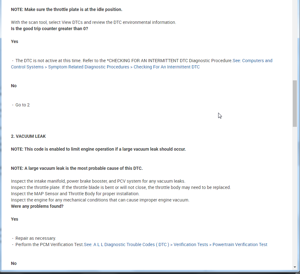

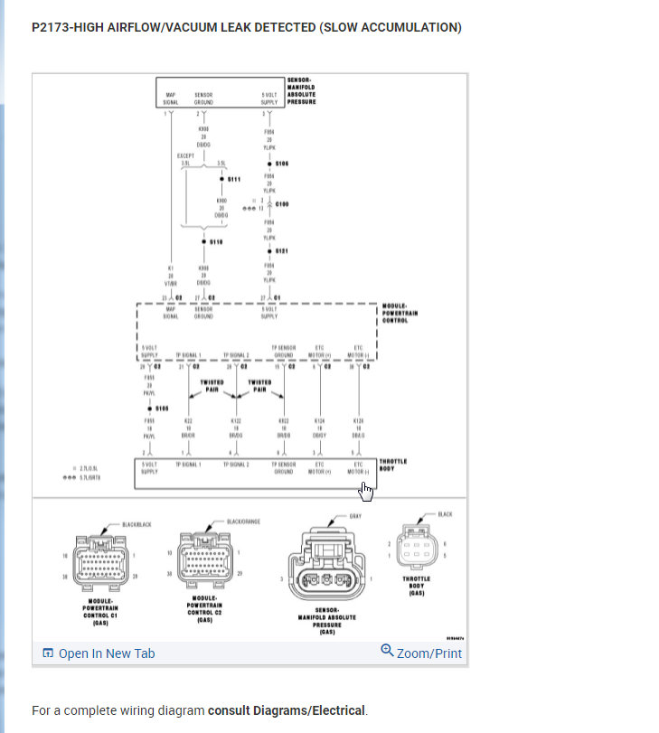

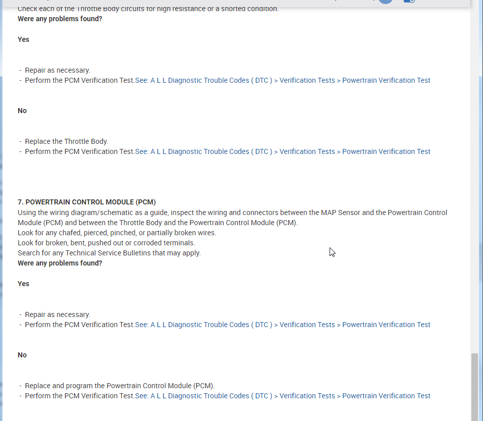

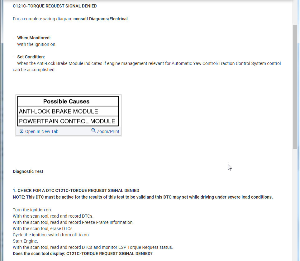

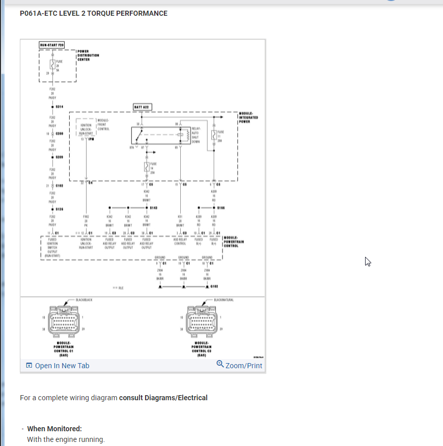

I bought my car in December '19 and decided it was time to change the spark plugs. The only issue prior to the change was some hesitation when I initiated acceleration. My neighbor who is familiar with regular auto maintenance assisted me. O'Reilly recommended Champion Double Platinum 7034 and we verified all were gapped at .050 in. When I drove the next day, I was at a stoplight when the lightning bolt and traction control lights pop up then my car went into limp mode. I can temporarily fix the problem by turning it off and then on. There were 3 codes pulled:
C121C
P2173
P061A
Apr 25, 2021 at 7:30 PM

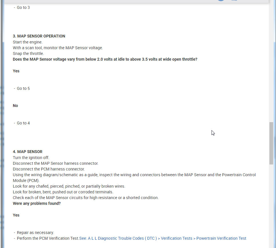

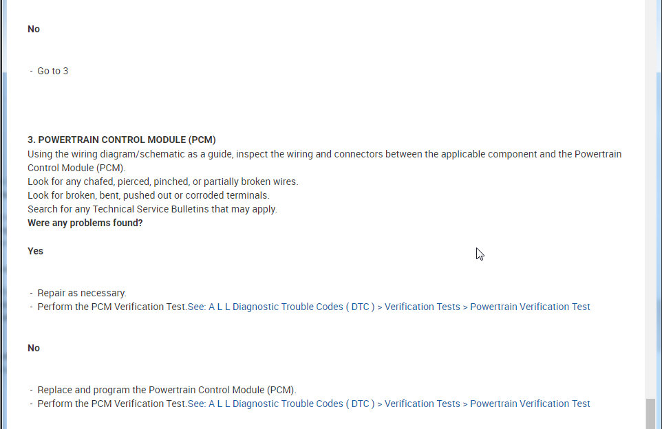

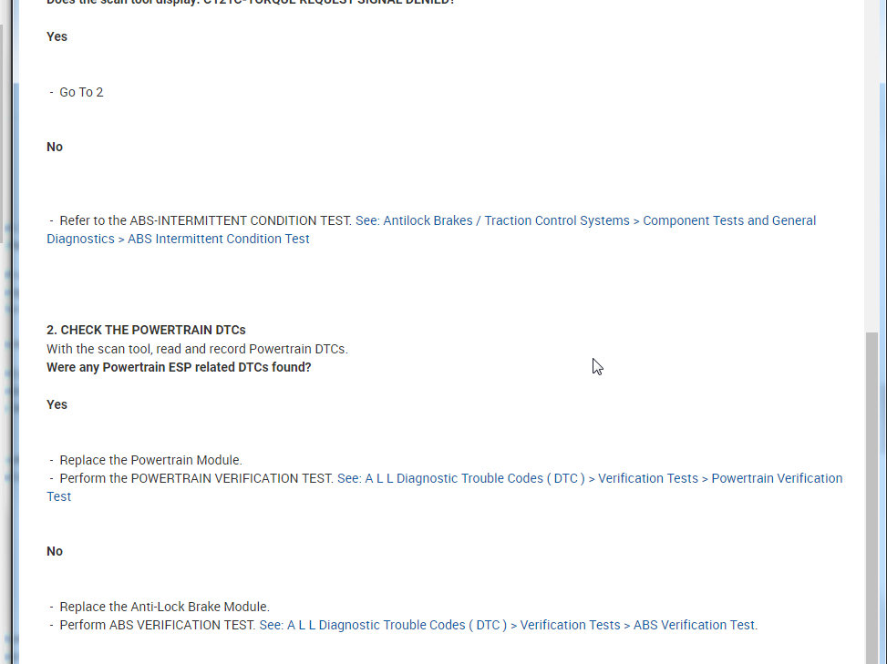

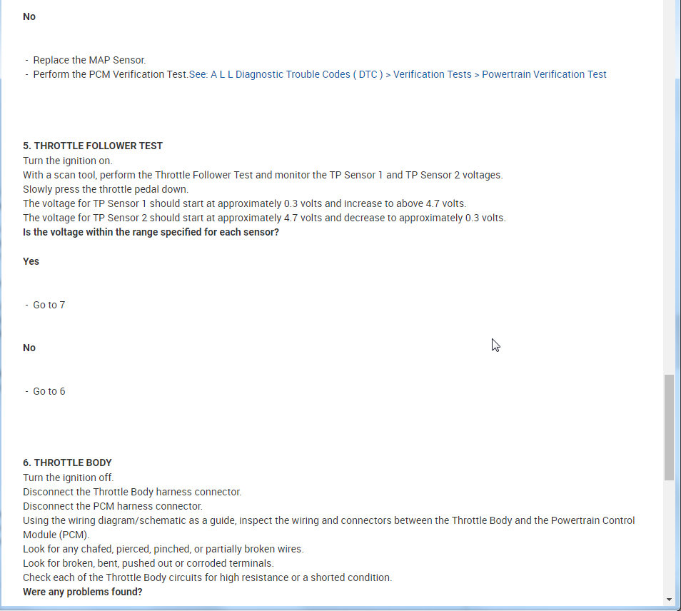

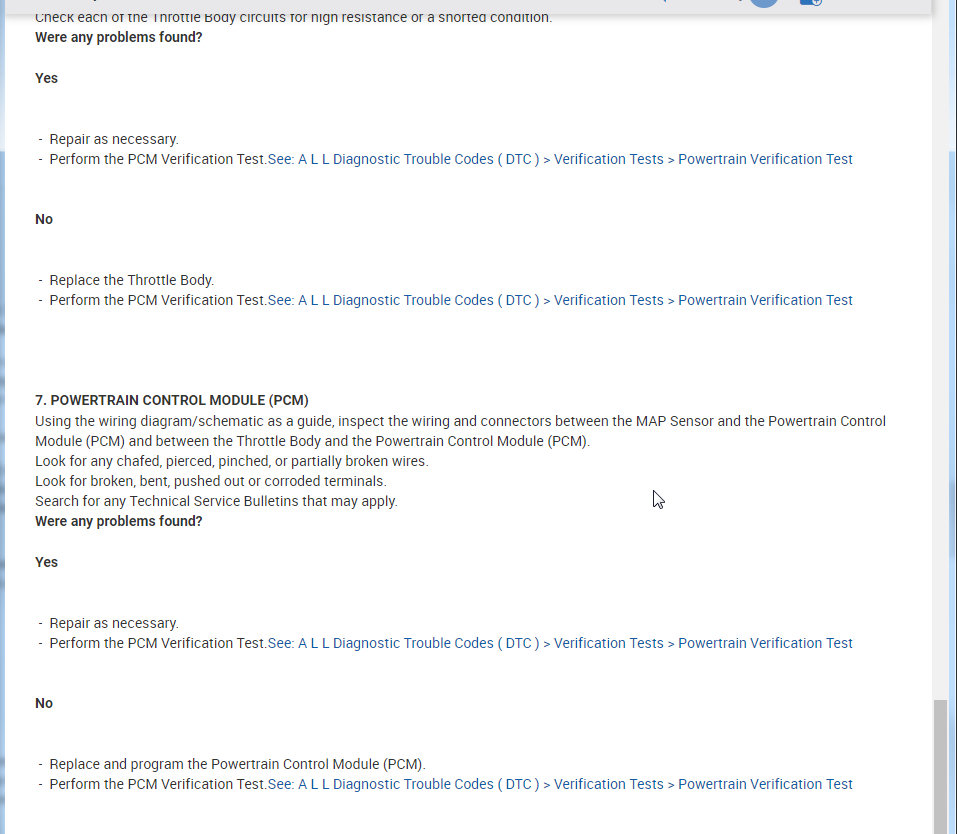

I doubt this is related to the spark plugs so I would suggest starting with the P2173 code. I supplied the testing for all these codes below.
Please run through this material and let us know if you have other questions and what you find. Thanks
