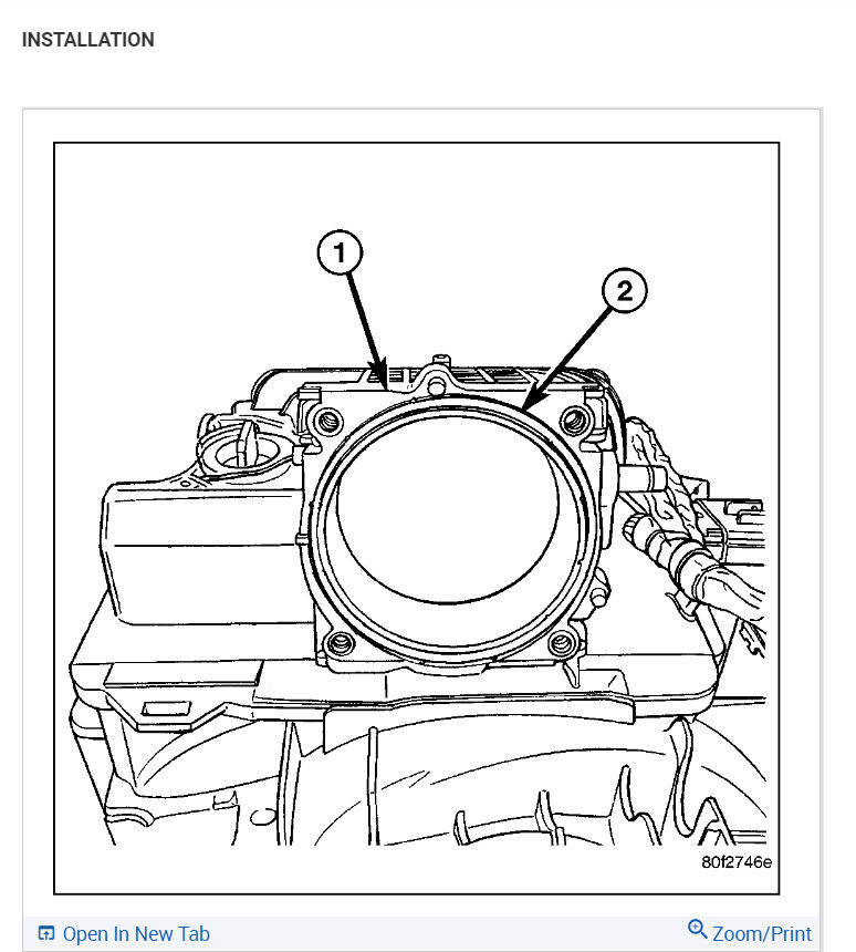

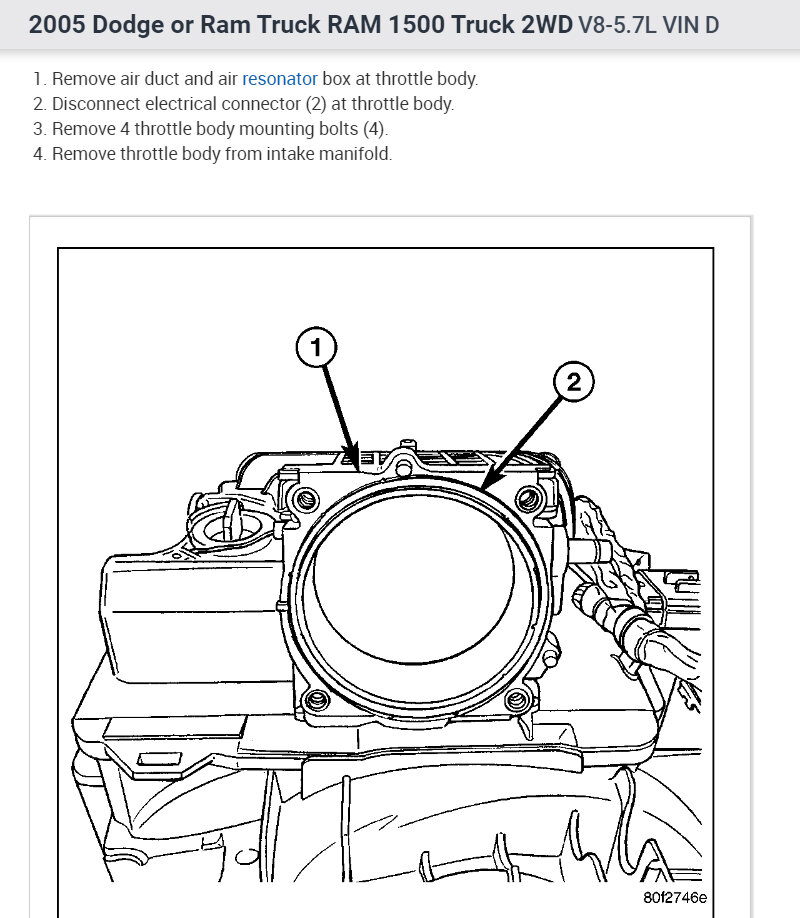

truck starts up and idles rough and will stall out occasionally. Red lightning bolt is on dash and is not blinking. Used scanner, no trouble codes popped up. The following parts are new: crank and cam shaft sensor, throttle body. help
Jan 30, 2023 at 6:32 AM
  • 55,743 POSTS

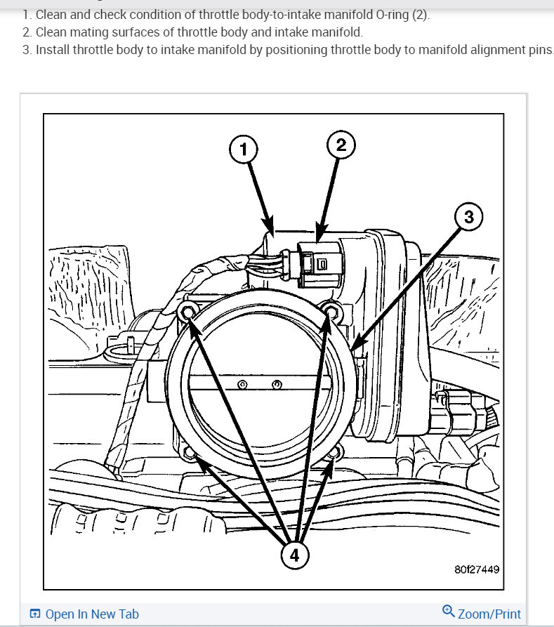

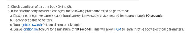

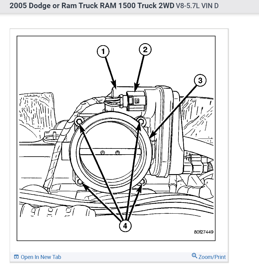

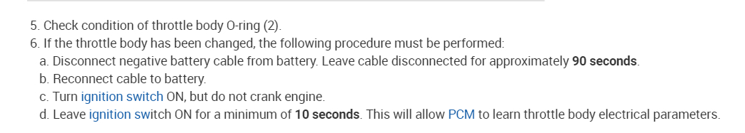

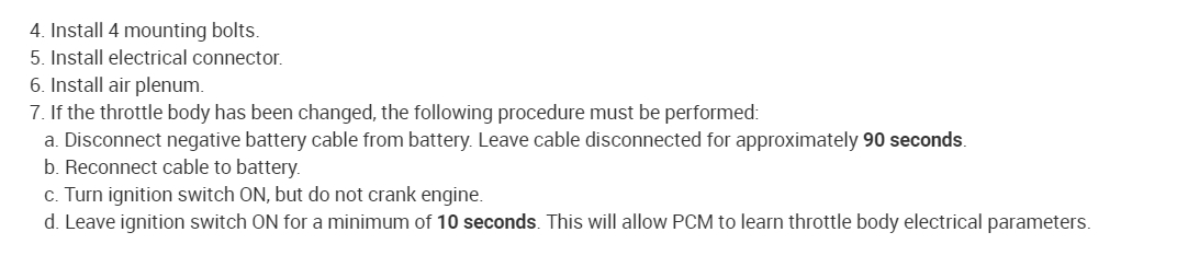

The red lightning bolt on the dash means there is a problem with the throttle body. Nine times out of ten the unit just needs to be serviced.
Here is a generic guide to show you how with instructions on how to do the job on your car in the images below:
This condition will not set a trouble code. Check out the images (below). Please let us know what happens.
