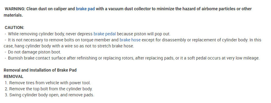

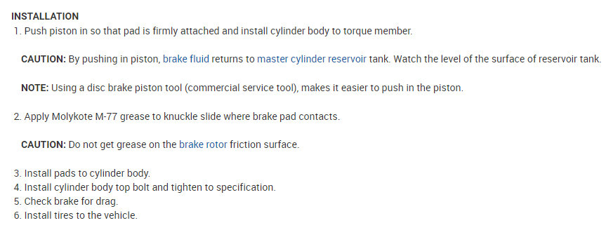

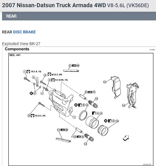

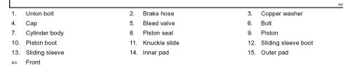

How can I replace my rear brake pads and rotors?
2007 NISSAN ARMADA
220,000 MILES • V8 • 4WD • AUTOMATIC
LGILL1984
While i was driving i heard grinding from the rear brake I need to change them out.
Jul 23, 2020 at 3:37 AM
DANNY L
  • 5,648 POSTS
Hello, I'm Danny.
Here is the information you requested. Here is a guide to help you step by step with instructions in the diagrams below to show you how perform the repairs on your truck:
https://www.2carpros.com/articles/how-to-replace-rear-brake-pads-and-rotors
Here is a YouTube video from our site on how to compress the rear caliper piston when performing a rear brake job:
https://youtu.be/j8YwfSKEzZo
I've attached picture steps below on how to replace the brake pads on your truck. Hope this helps and thanks for using 2CarPros.
