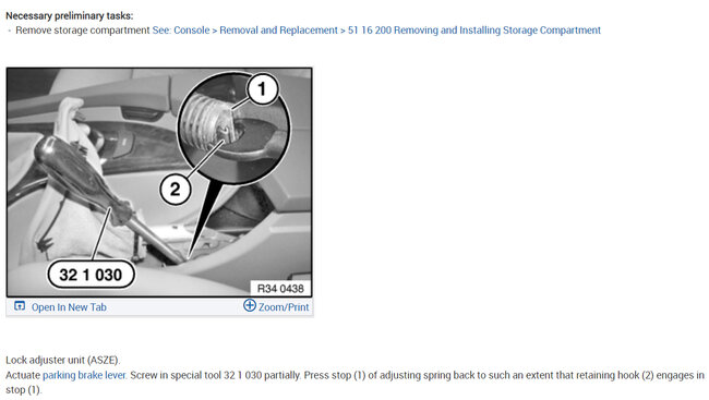

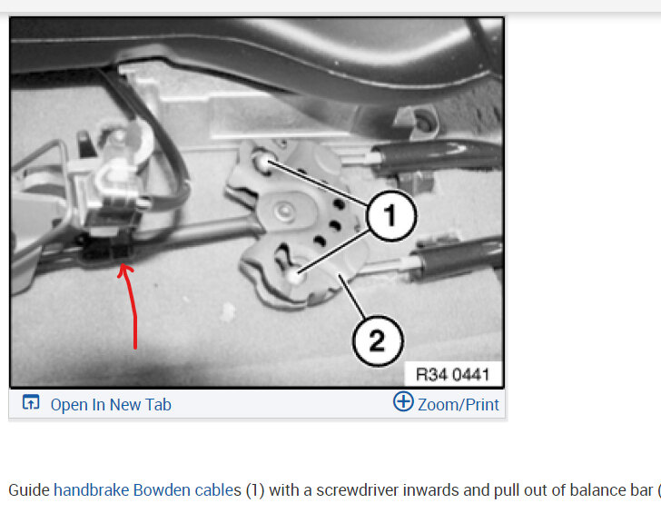

I have red "brake" light on all the time on dashboard, i already have replaced brake fluid, (front/rear) rotor, (front/rear) pad and sensor. I even tried brake fluid sensor change and still have red brake light. I checked with voltmeter for warning switch sensor with brake fluid sensor in the brake fluid, car on but i get continuity, i would expect reading to be 1 and not continuity (0). Any ideas or suggestions? How can i disable the red brake light off? Guys please help, I have been trying to fix it for a while.

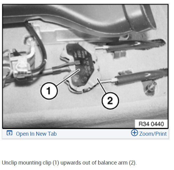

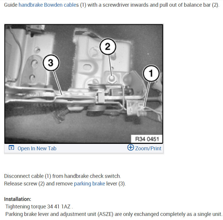

This brake light will be on if the parking brake handle, I would remove the handle cover to check the adjustment on the level position switch. Here are the instructions and location of the switch. I would unplug the switch to see if the light goes out with the engine running as well. Check out the images (below). Please upload pictures or videos in your response to any problems so we can see what to help you with.

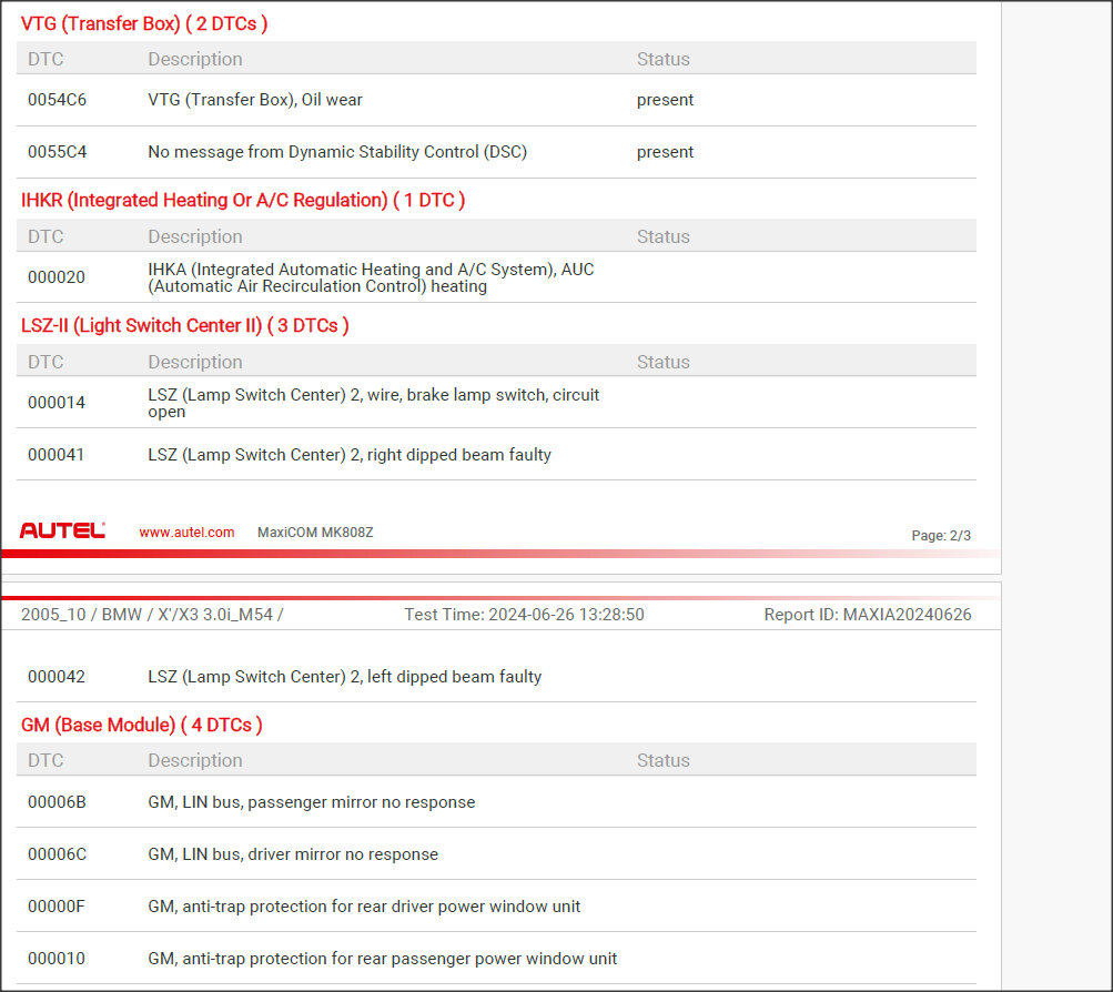

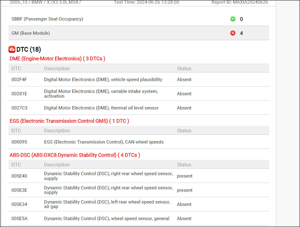

I am attaching scan report. I have some these speed sensor codes for years due to ABS issue. But "red" brake light was not present earlier.
For last few days, i am noticing after i park car for 10 mts and then i start the car, remove parking brake, "brake" turns yellow, as before. After driving for few mts it turns "red" . What i also observed that if i drive straight, in about 5 mts after starting car, "brake" turns "red" from yellow. If i drive reverse, it remains "yellow"
What you think it is ? As mentioned before i have changed front/rear rotor/brake pad/sensor and red light has started coming up after putting front rotor/brake pad/sensor. I put front and rear two weeks apart.

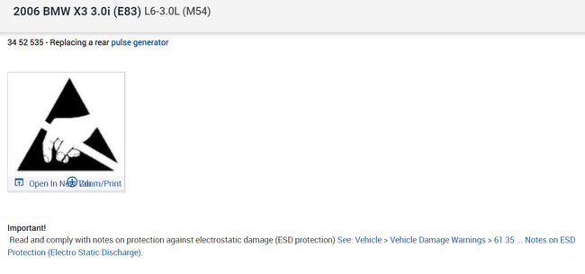

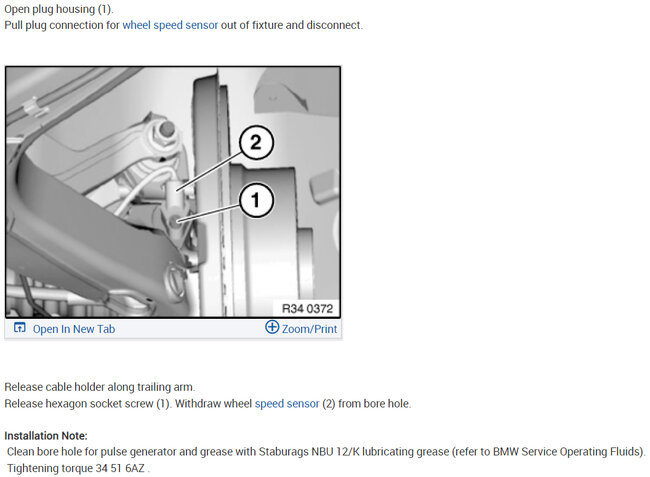

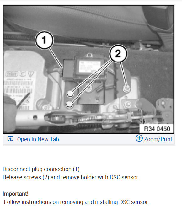

Thanks for the code readout, the codes that sticks out and which can cause the other codes is the 005E34 left rear wheel speed sensor problem, I would raise the car up to check the wiring to the sensor to make sure it is not damaged by road debris and if it is okay lets try a new sensor and then clear the codes. Check out the images (below). Please let us know what happens.

Each manufacturer has a different criteria on how there warning system works, I would concentrate on fixing the trouble codes and the warning light issue should go away. I would replace the left rear wheel speed sensor and clear the codes to see what happens.

If i am fixing speed sensor, i have a question - i have abs, 4x4, brake light, tire pressure lights for years and this is due to the fact that my ABS ring - reductor ring is rusted and it is touching speed sensor so it is not catching correct speed, while i am fixing speed sensor, can i put washer to prevent abs ring touching speed sensor to create ABS, 4x4, brake light, tire pressure lights again and may be "red" brake light again ?

The washer may work but I am more concerned with why the sensor is touching the reluctor wheel, you may have a bad bearing hub causing the issue.

Yep, that can cause the problem, I would try cleaning the reluctor wheel and at the same time check the bearing hub for play.
