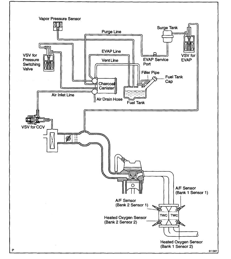

I've taken my car to two different repair shops to diagnose and fix recurring P0440 emission error. The following parts were replaced without positive result, the P0440 persists.
1) New Gas Cap.
2) New Purge Valve.
3) New Charcoal Canister.
4) New Idle Control Valve (valve body was supposedly
cleaned).
5) New PCV.
6) New MAF.
7) New Gas neck filler tube.
It's really hard finding a competent shop much less one that cares to venture beyond simple OBD2 reading.
What else could be the problem with this issue? Any advice appreciated. Thanks.
Sep 30, 2022 at 1:54 AM
  • 55,758 POSTS

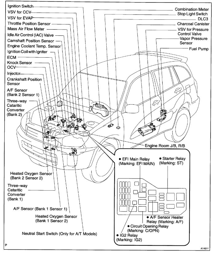

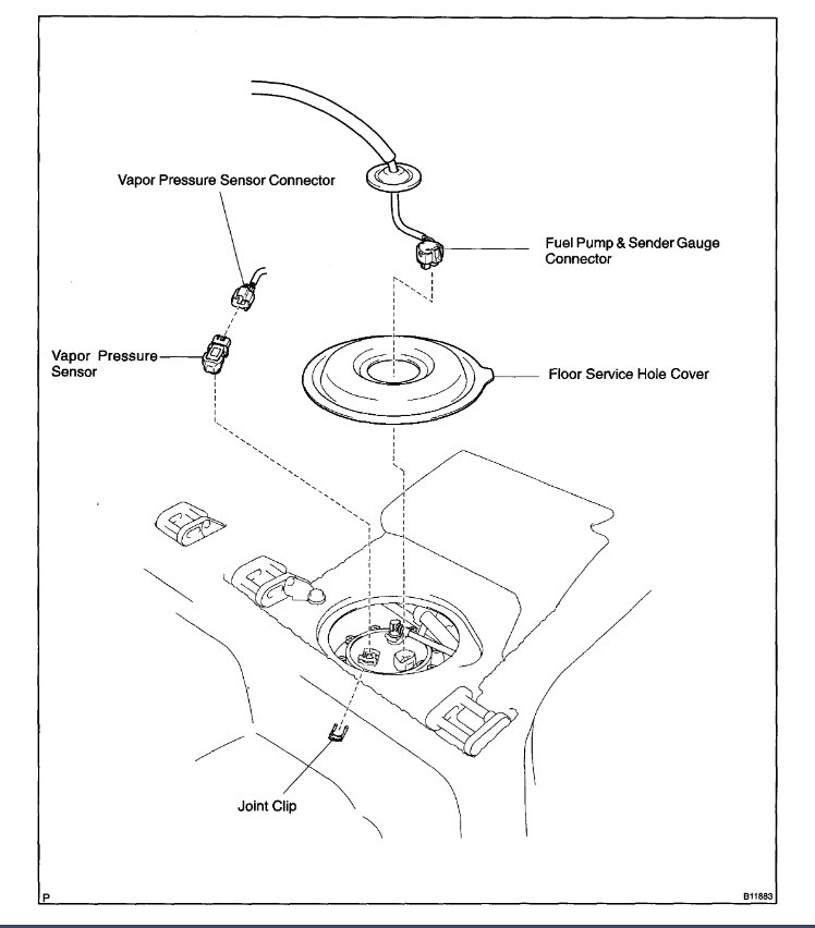

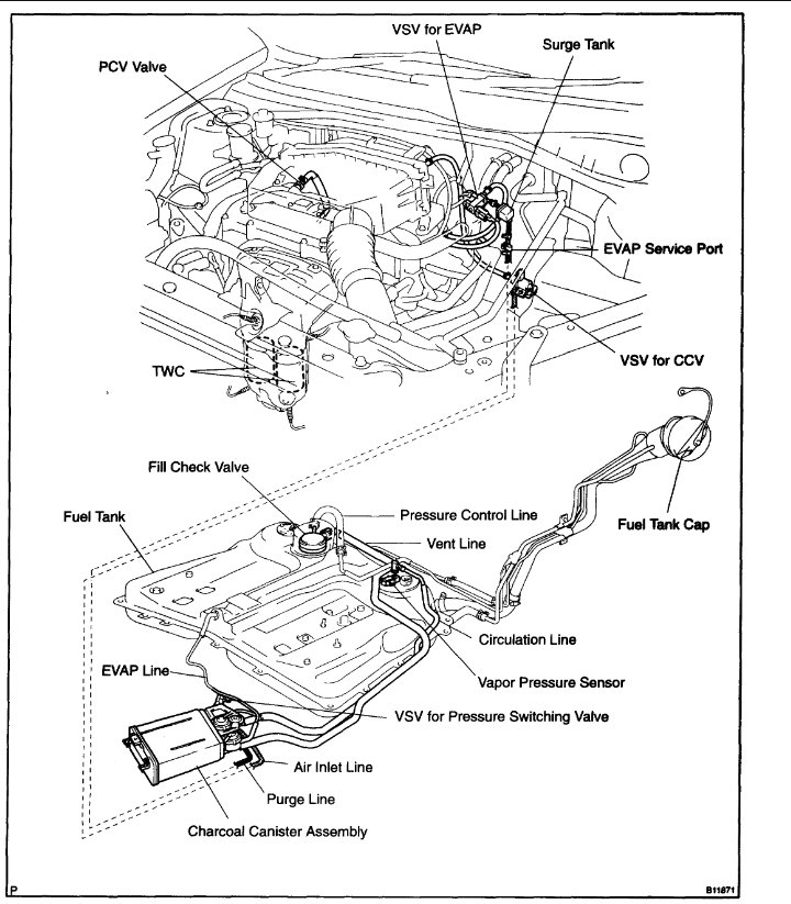

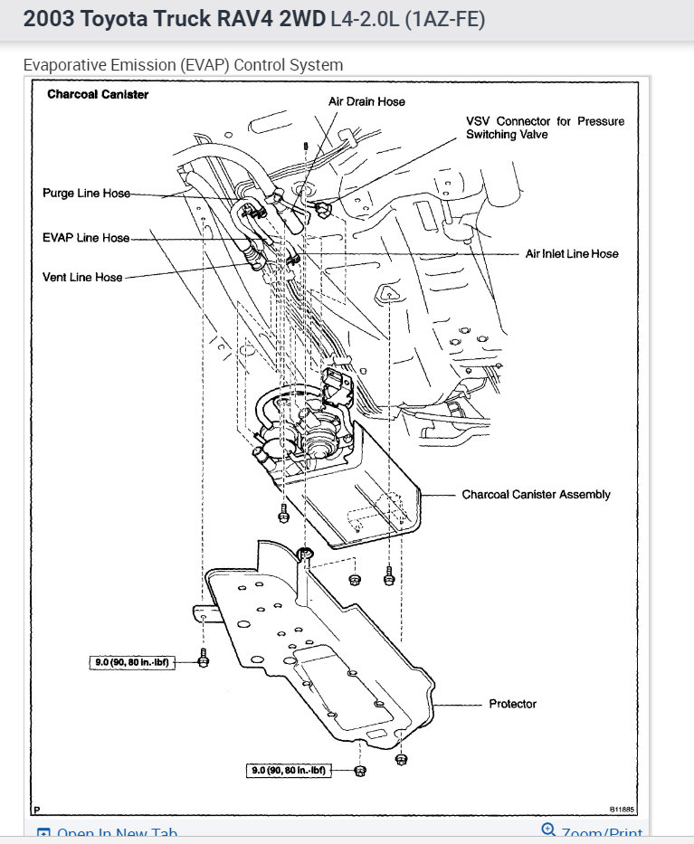

Error Code P0440 means a leak in the EVAP system or that a vapor pressure sensor has malfunctioned. So, to fix this problem you need to go over the EVAP lines to make sure they are not leaking, if it comes back on with no leaks change out the EVAP pressure sensor which is by the fuel pump/fuel tank. Check out the images (below). Let us know what happens and please upload pictures or videos of the problem.
