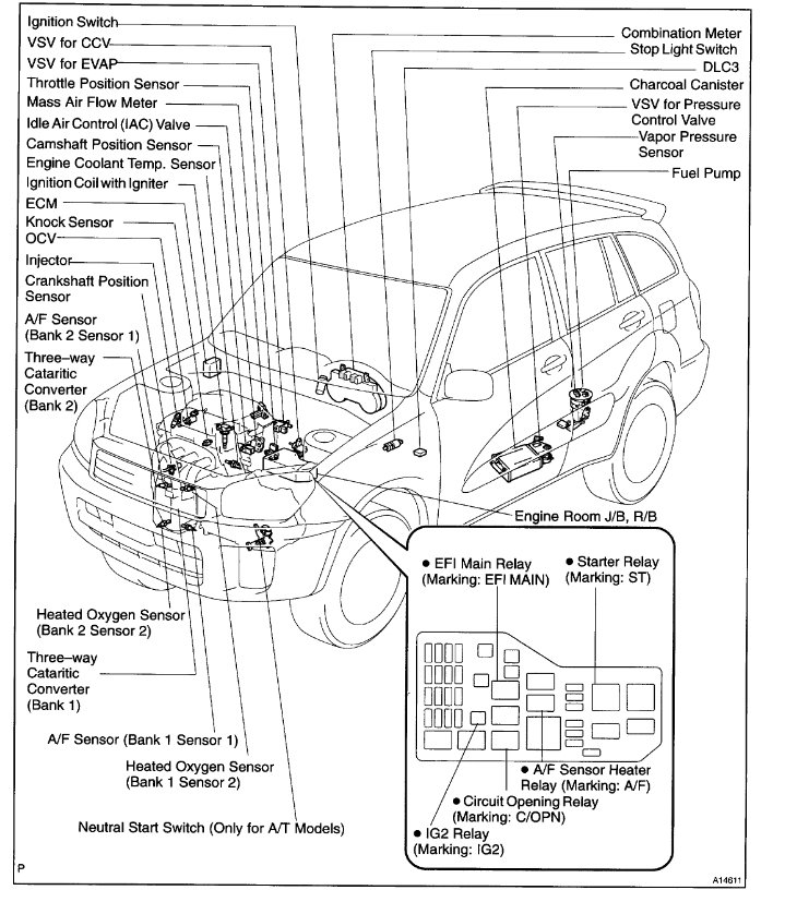

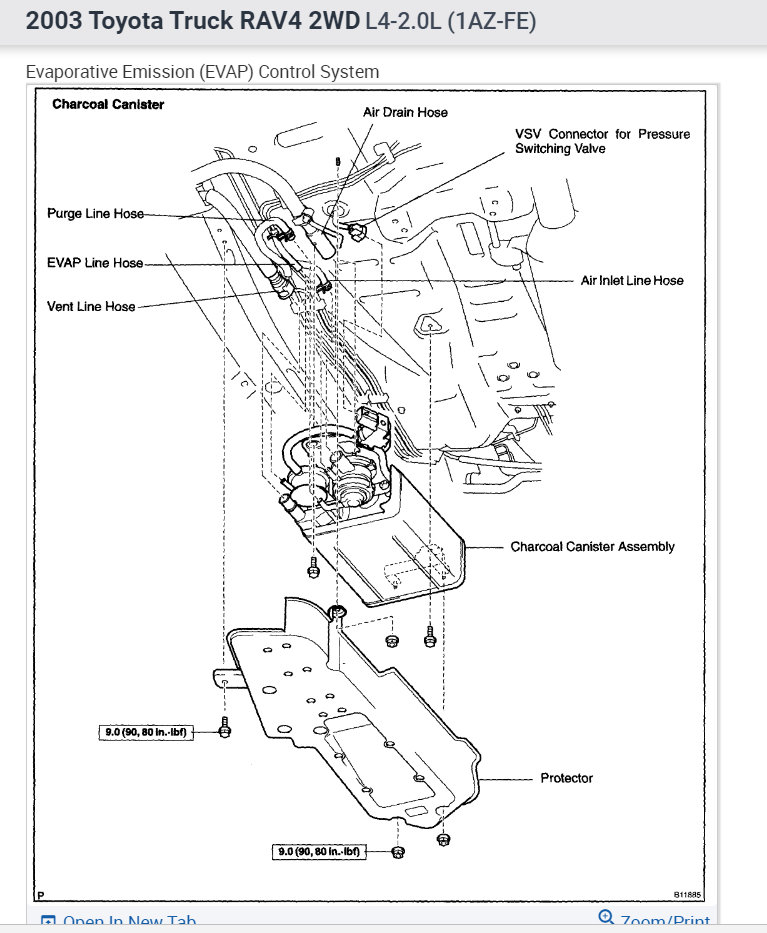

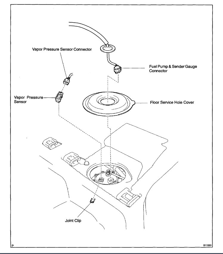

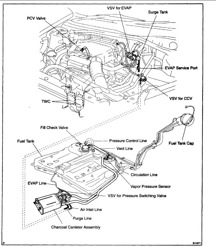

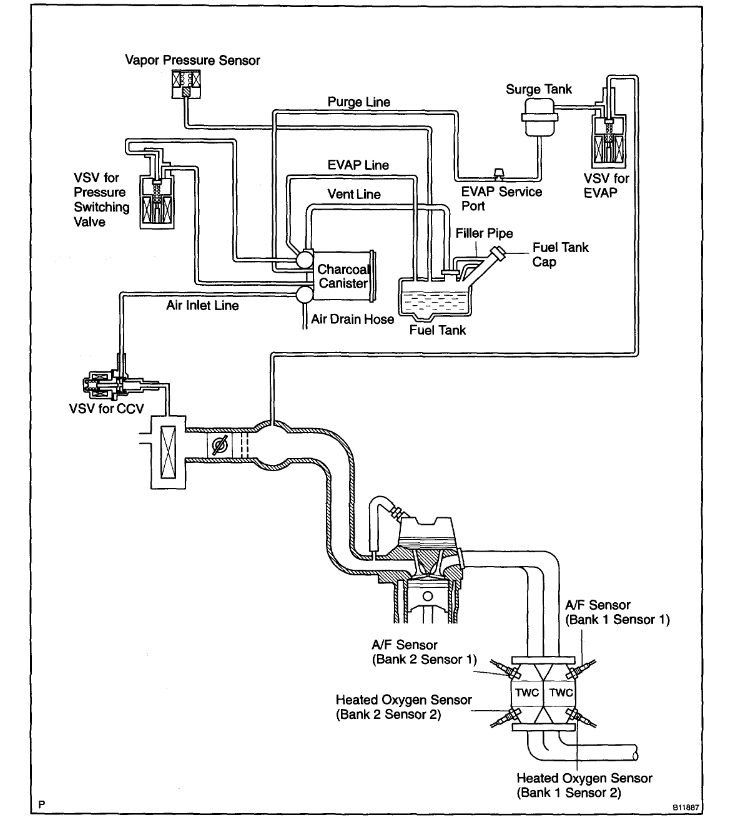

Error Code P0440 means a leak in the EVAP system or that a vapor pressure sensor has malfunctioned. So, to fix this problem you need to go over the EVAP lines to make sure they are not leaking, if it comes back on with no leaks change out the EVAP pressure sensor which is by the fuel pump/fuel tank. Check out the images (below). Let us know what happens and please upload pictures or videos of the problem.
