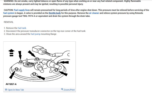

Had cylinder misfire when purchased car. Replaced spark plugs and coils, ran great for couple days,started running rough.trouble code said misfire #4 and 5.cleaned plugs,ran good for couple days then rough again trouble code said misfire #3 and 4, clean plugs and MAF. Ran good couple days, then rough again. Trouble code said misfire #4 and 5, cleaned, re-gapped plugs, reset PCM.ran good for about 4 days now rough. Trouble code now says misfire #1 and 3, also new trouble code P1131. What do I check or repair/replace next?

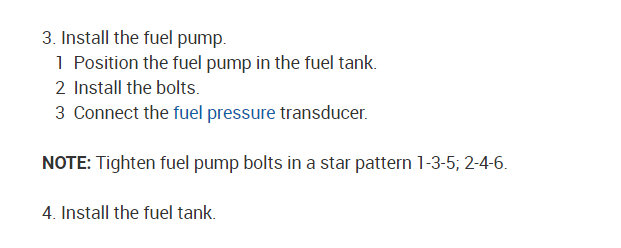

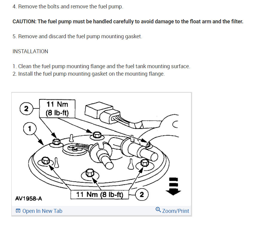

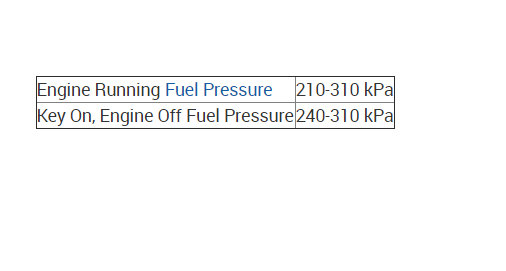

I would also check the fuel pressure to be sure there is good pressure. Low fuel pressure will cause this issue.
