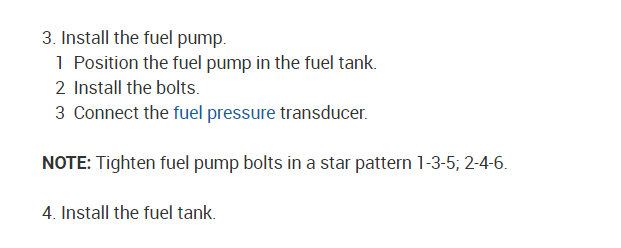

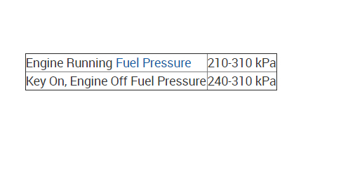

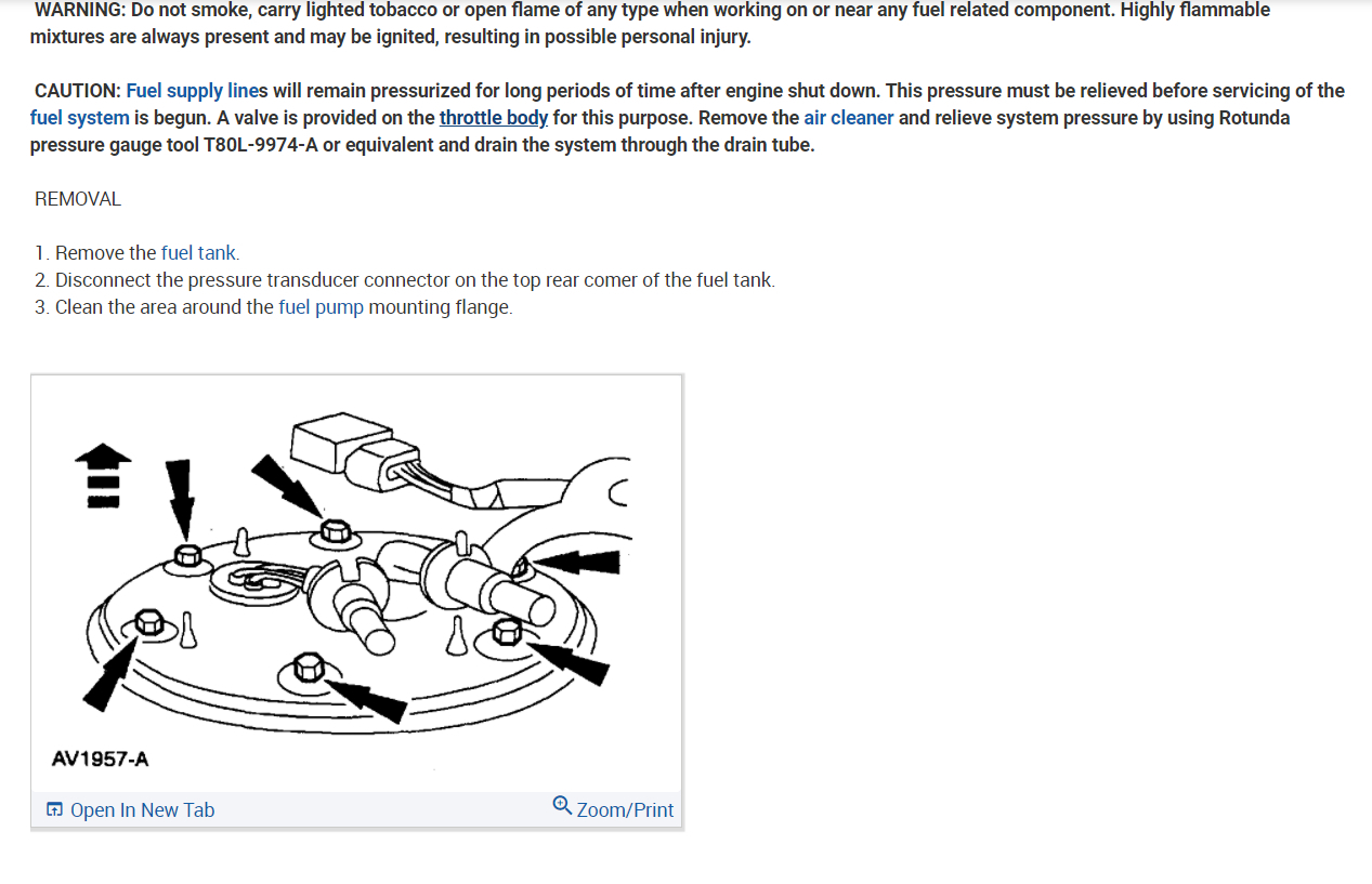

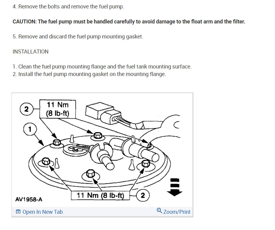

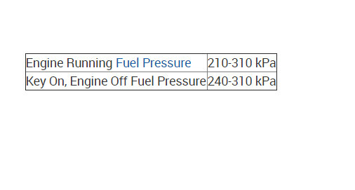

I would also check the fuel pressure to be sure there is good pressure. Low fuel pressure will cause this issue.
