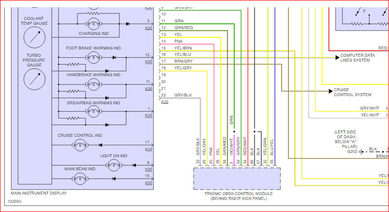

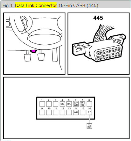

The wires for the OBD port became disconnected and separated from the port while working on dash board. How do I connect them correctly?
Sep 8, 2018 at 5:49 PM
DANNY L
Experienced Mechanic
5,648 POSTS
Hello, I am Danny.
Here is a SAAB diagram I found and have attached. Hope this helps and feel free to ask any questions if needed. Thanks for using 2CarPros.
