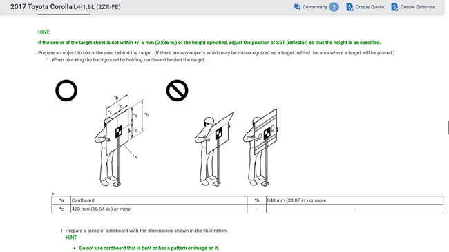

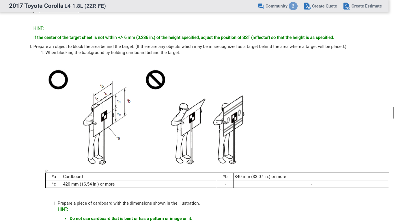

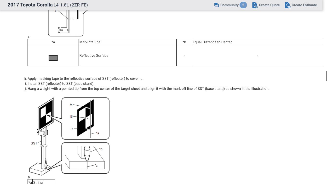

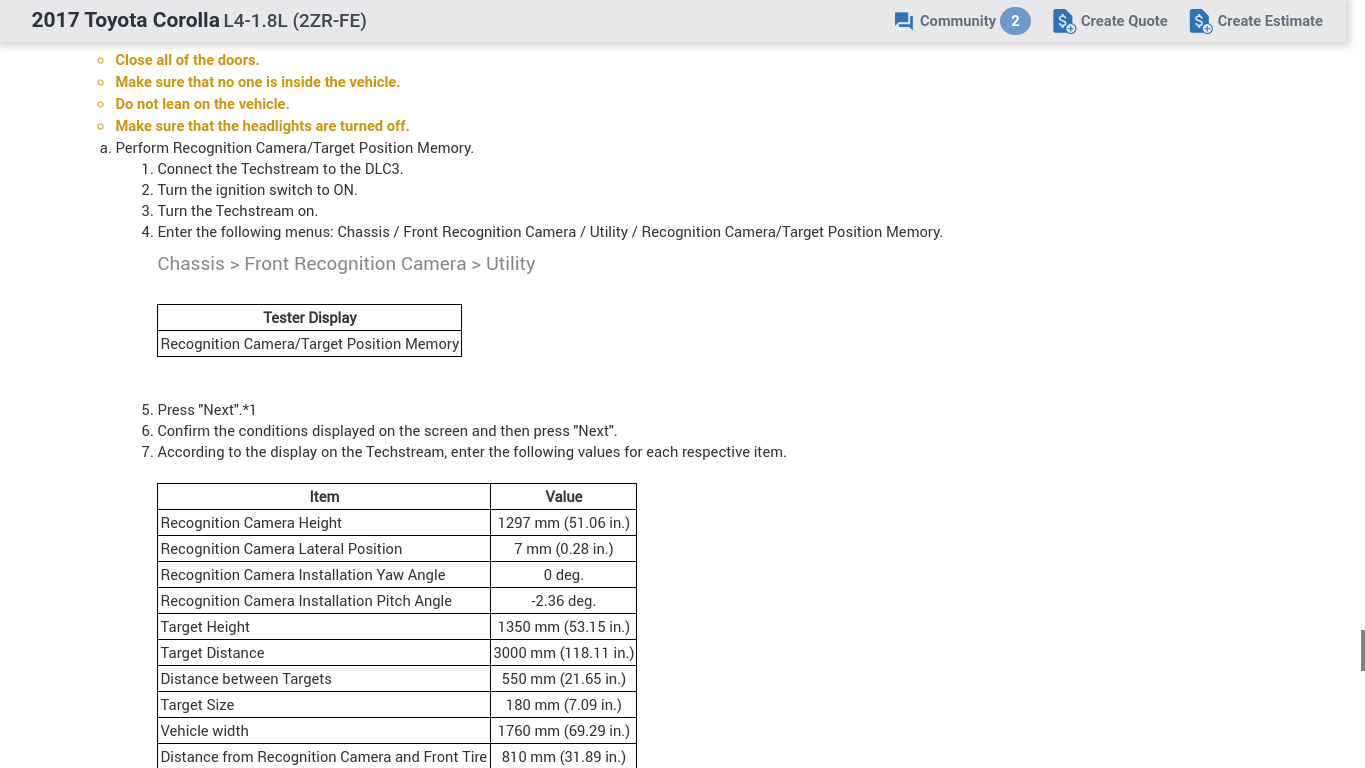

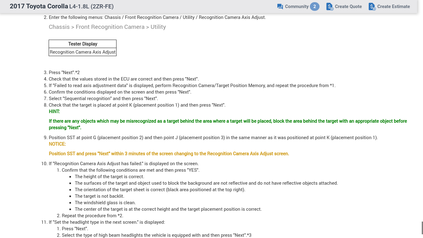

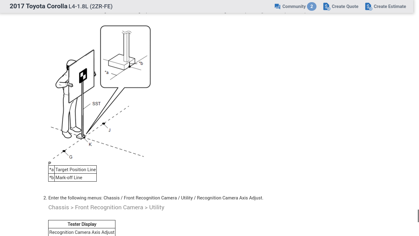

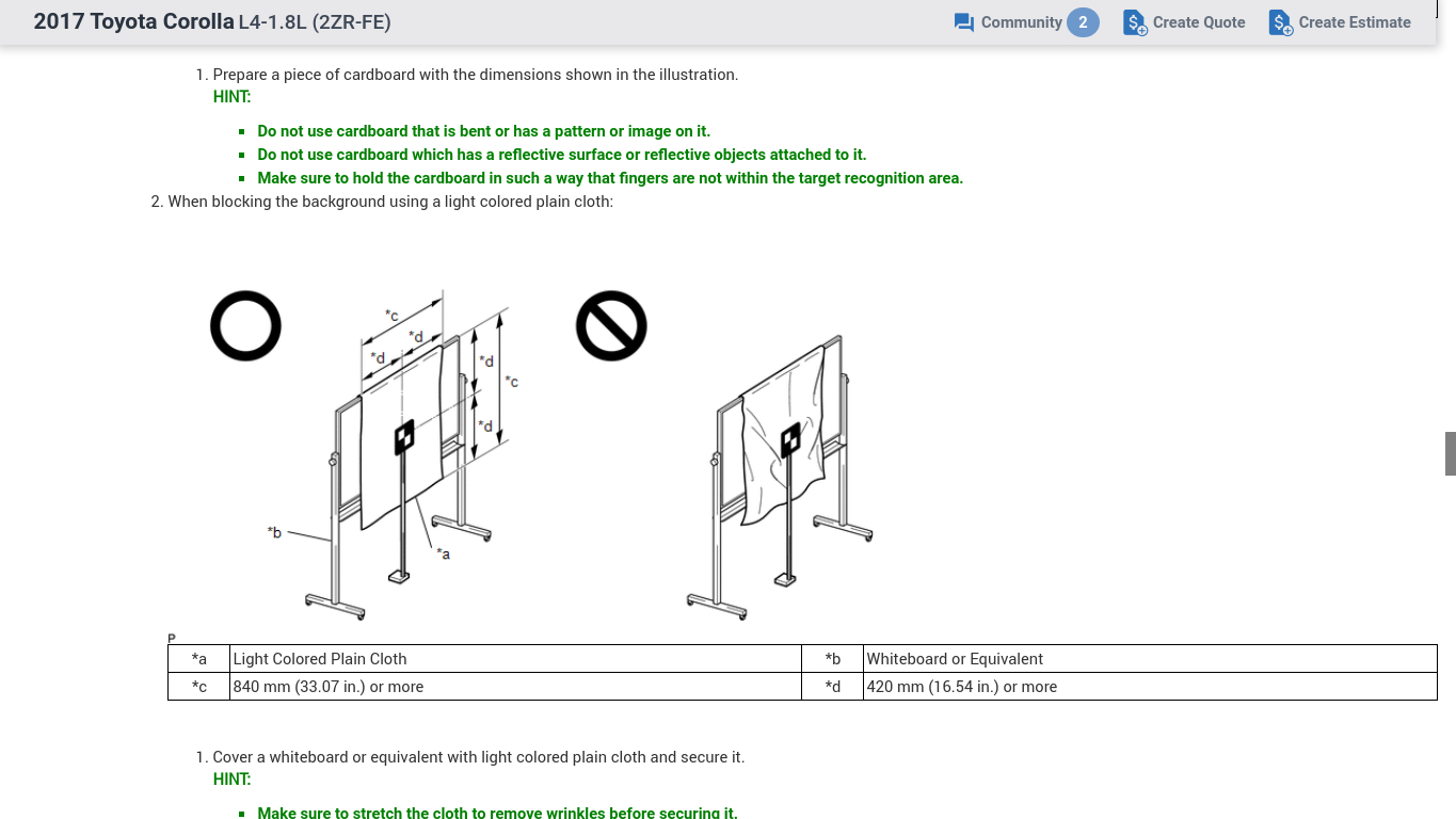

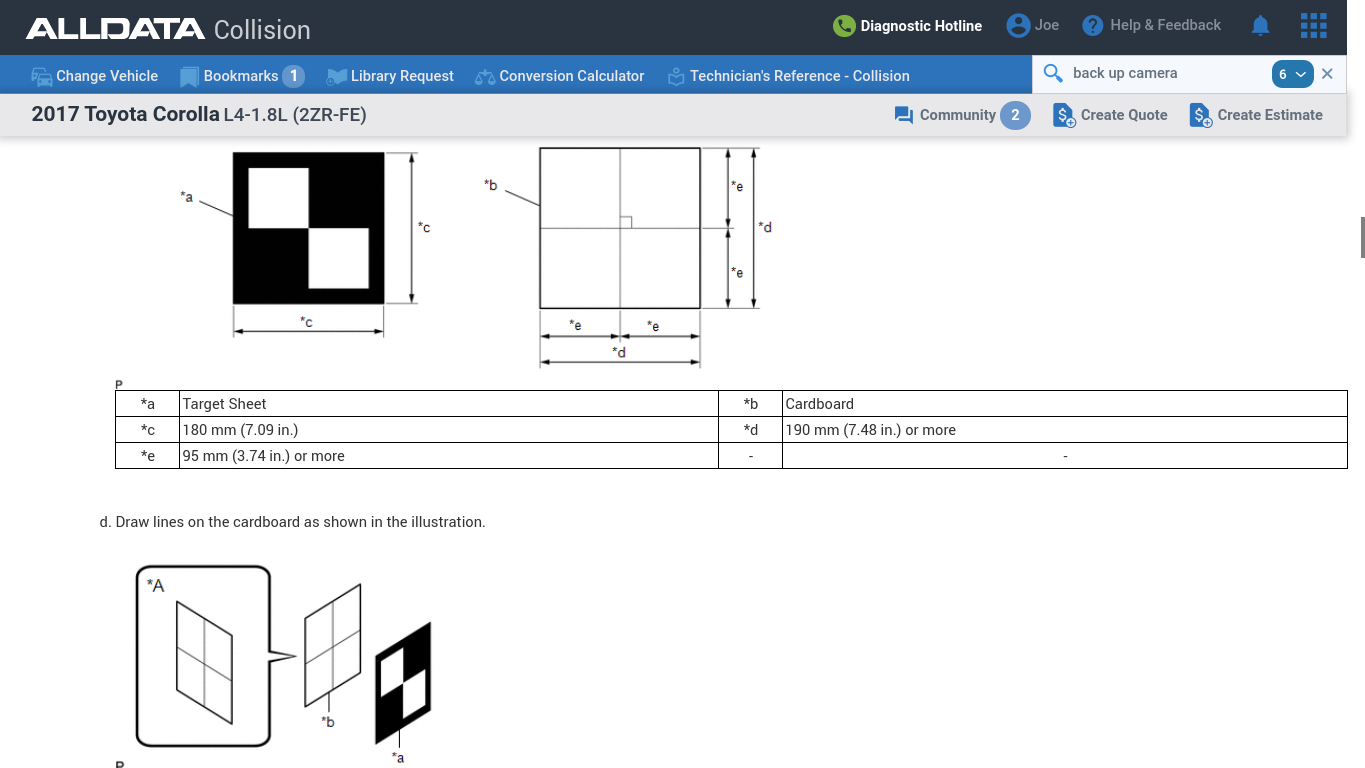

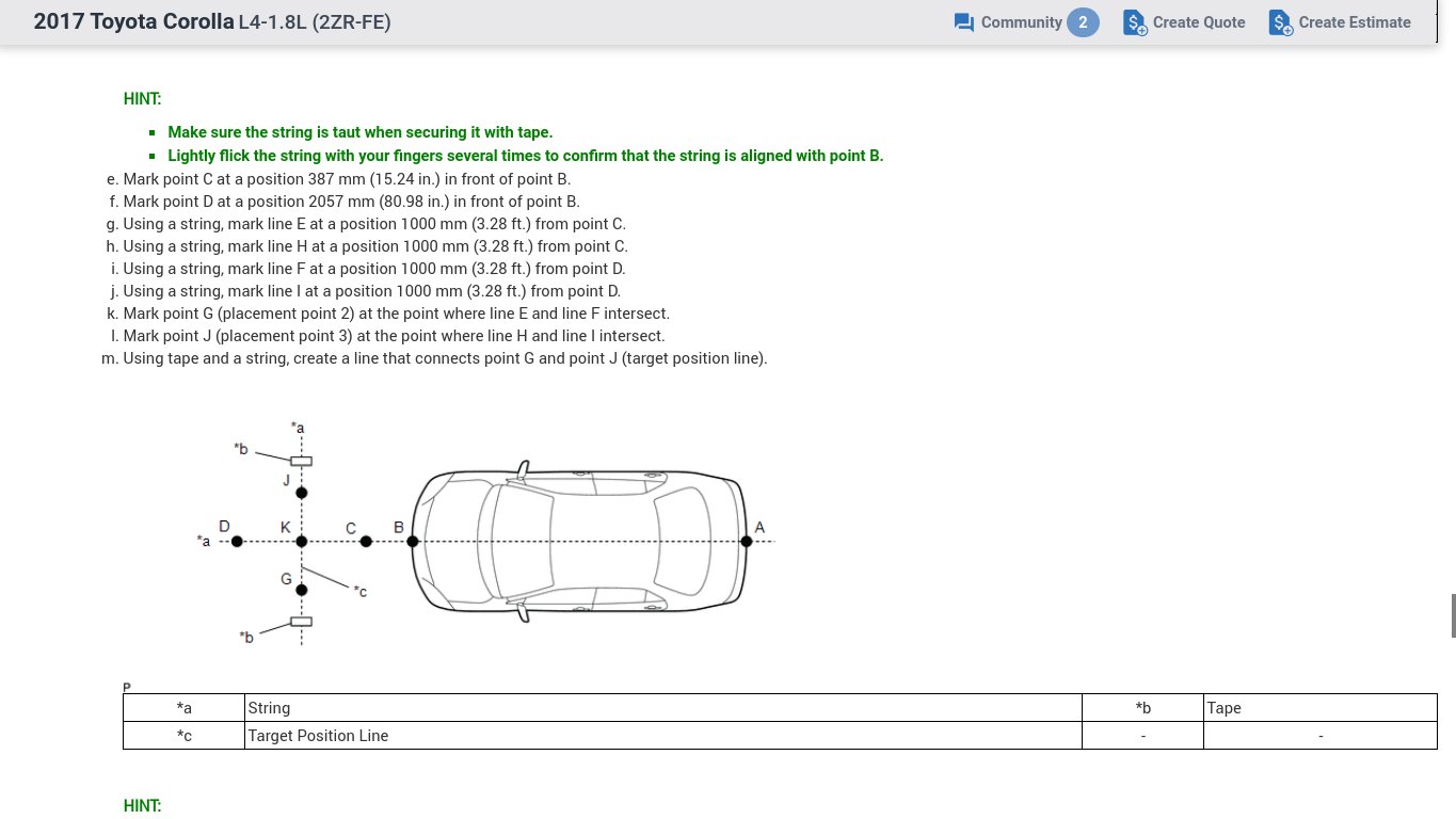

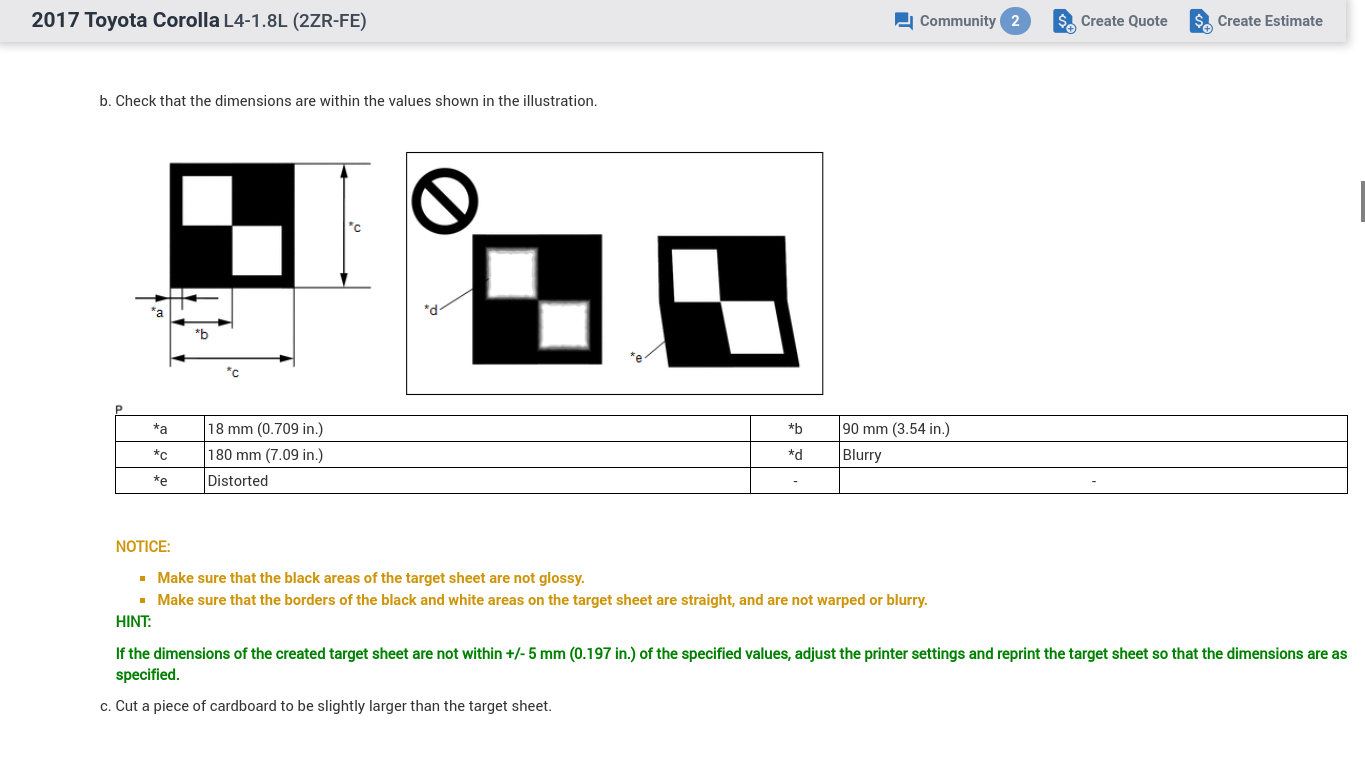

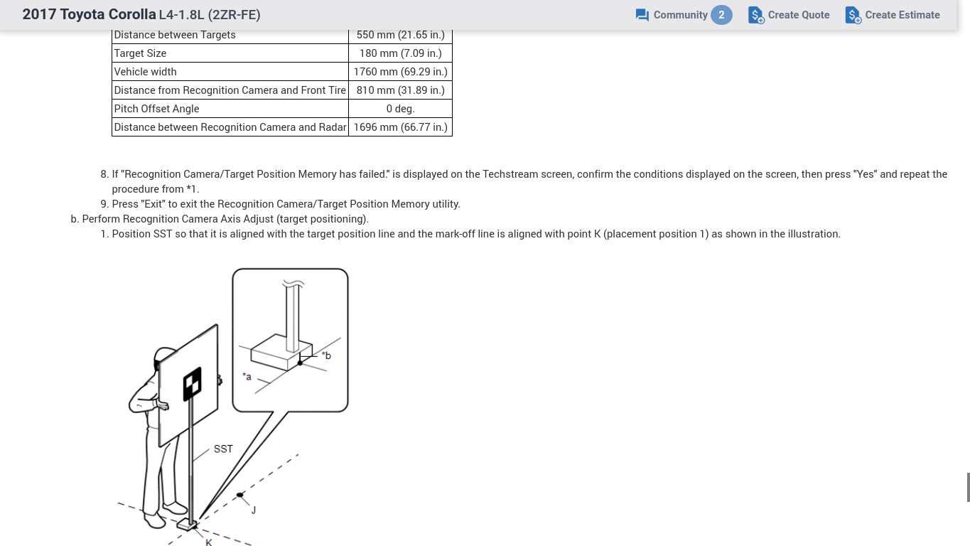

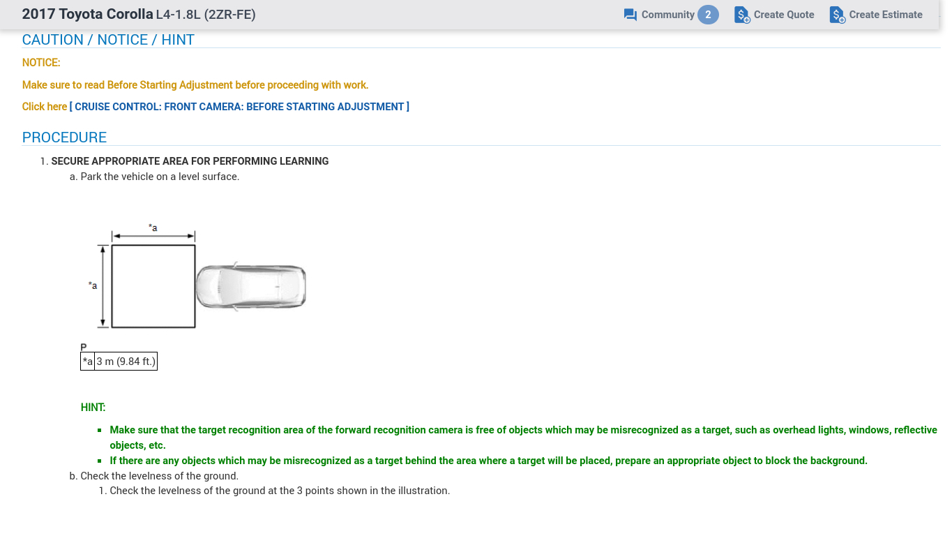

I want to make camera adjustment to the vehicle. the software need to put the vehicle information in memory (lateral position, yaw angle, pitch angle, target height, vehicle width, etc.) and this information found in repair manual. Can someone help for getting repair manual?thanks
Feb 19, 2020 at 9:23 PM
TOUGHDIVER
  • 226 POSTS

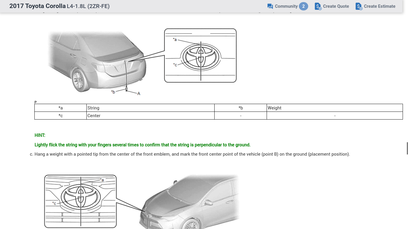

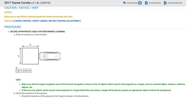

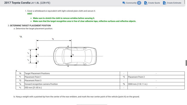

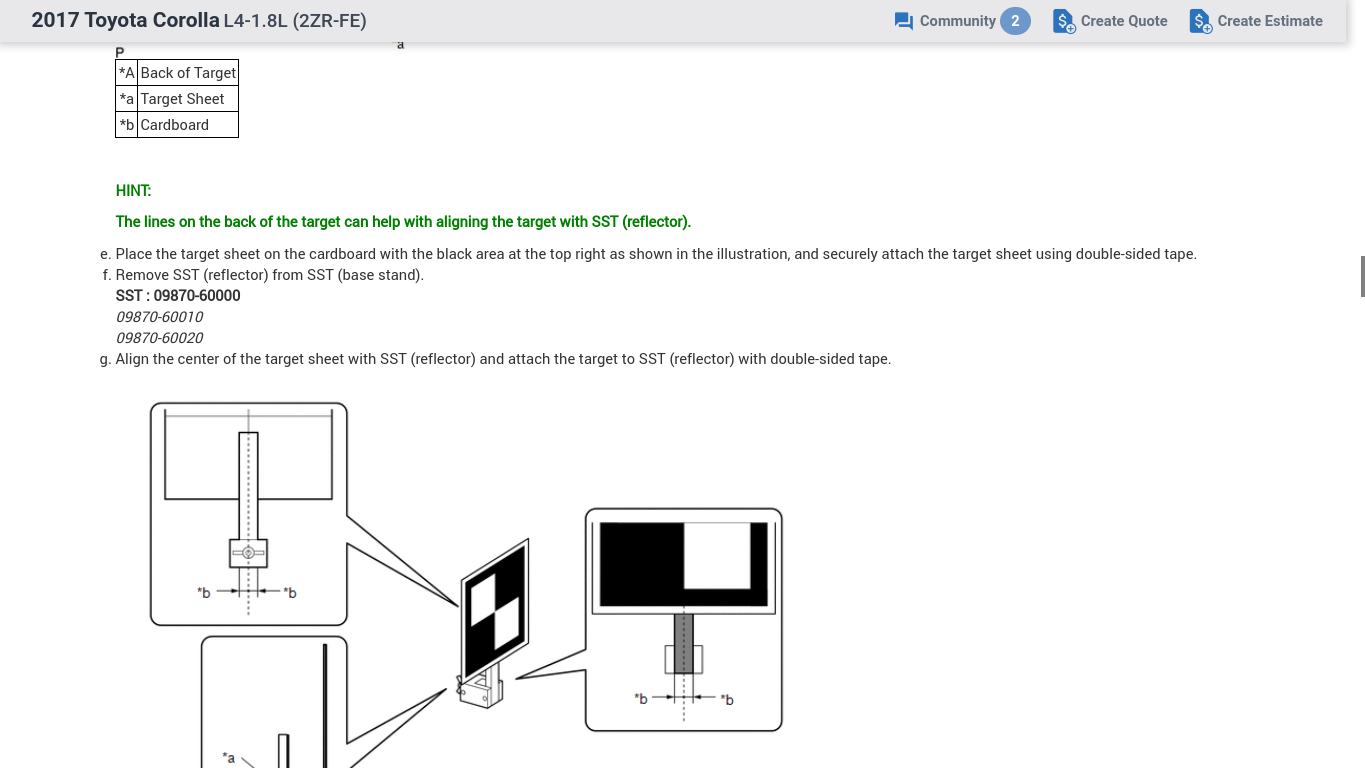

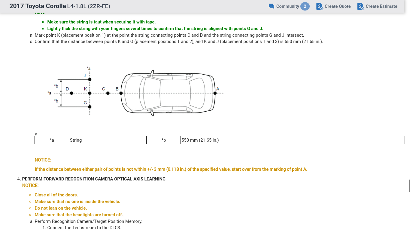

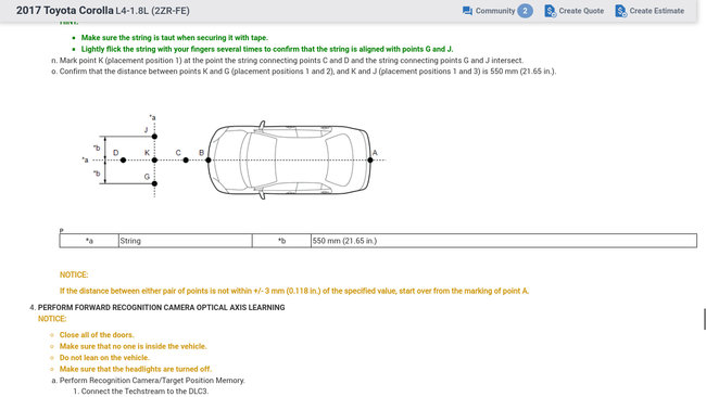

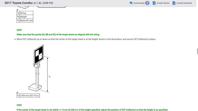

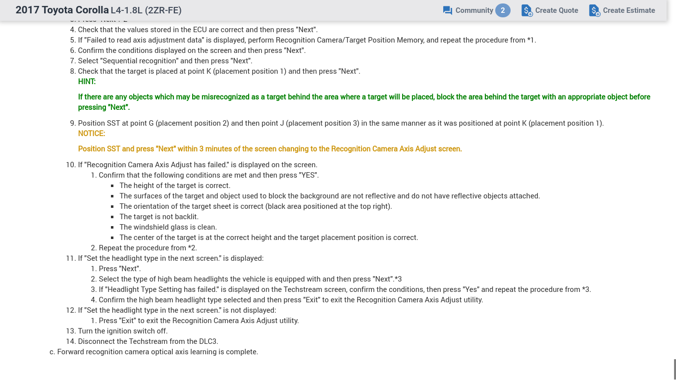

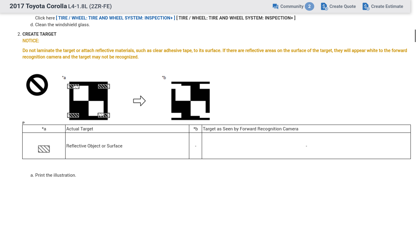

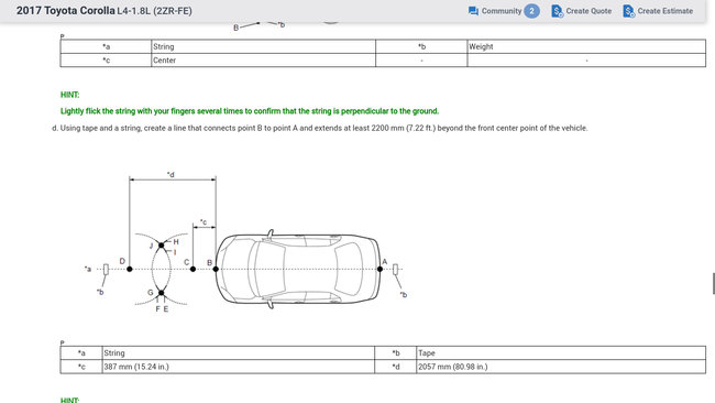

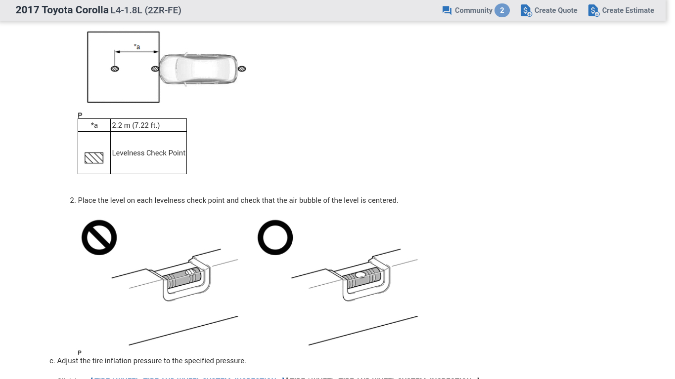

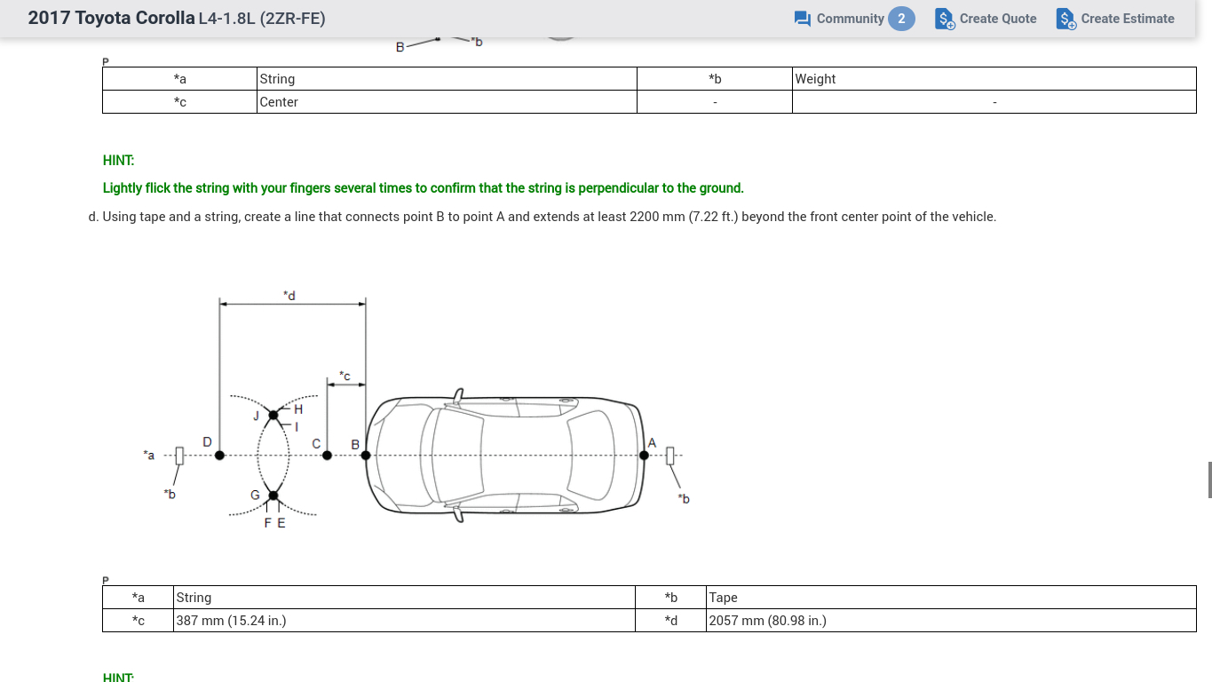

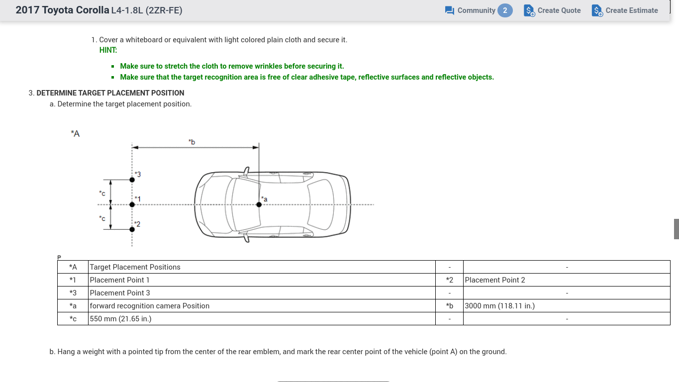

I'm attaching 21 pages below on adjusting camera let us know if you need more information. Note there may be a little overlap on the screen shots.

Thanks Joe T. your pictures are very helpful for me. I will do my best.
Feb 21, 2020 at 4:00 PM
  • 55,412 POSTS
You are welcome, DUFFDIVER is one of our newest experts, he is quickly shaping up to be one of our best! Please let us know what you find. We are interested to see what it is.
Feb 24, 2020 at 2:49 AM
AMMAR20
  • 5 POSTS
I used pictures above and camera adjusting was done successfully. Thanks again for help.
