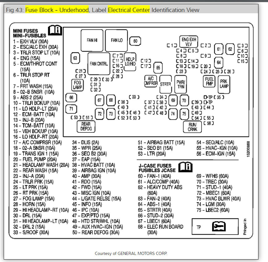

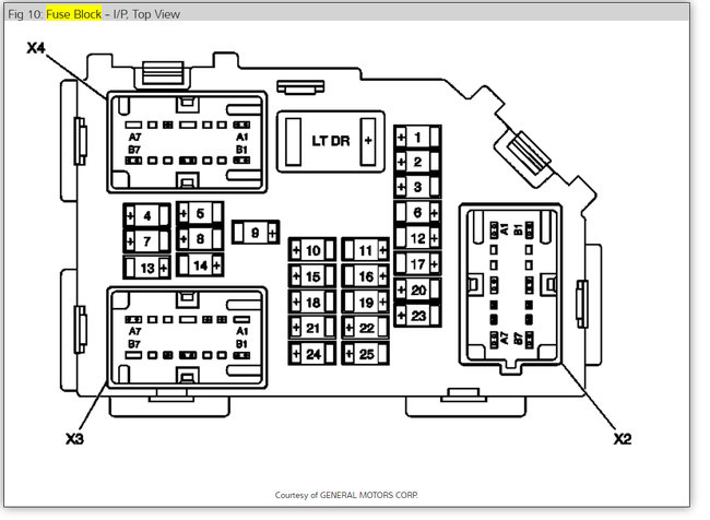

Hi, re-circulation actuator was stuck. Replaced by new one. When turn AC on, it rotates three times but when i activate the re-circulation button, nothing moves.
Jan 9, 2018 at 5:45 AM
  • 55,758 POSTS

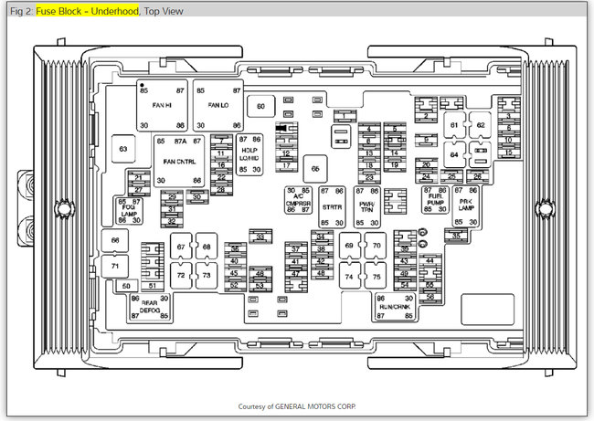

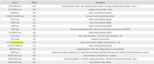

You need to calibrate the system which is easy. Turn the ignition key on then remove the HVAC fuse for 5 minutes then turn the key off and then replace the fuse. Then try the system. Here is the location of the fuse. #38
