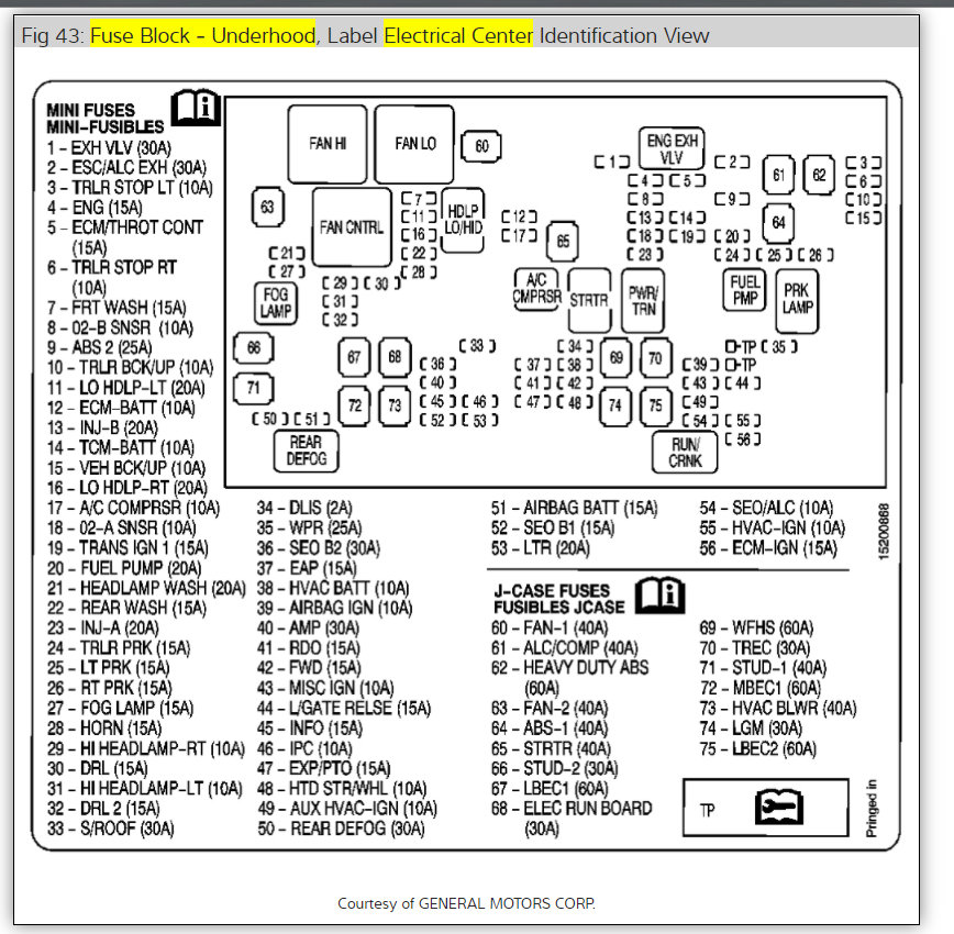

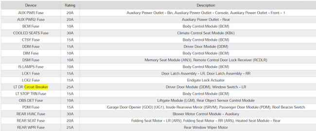

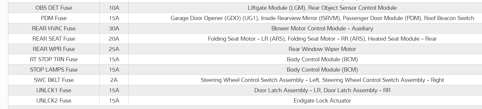

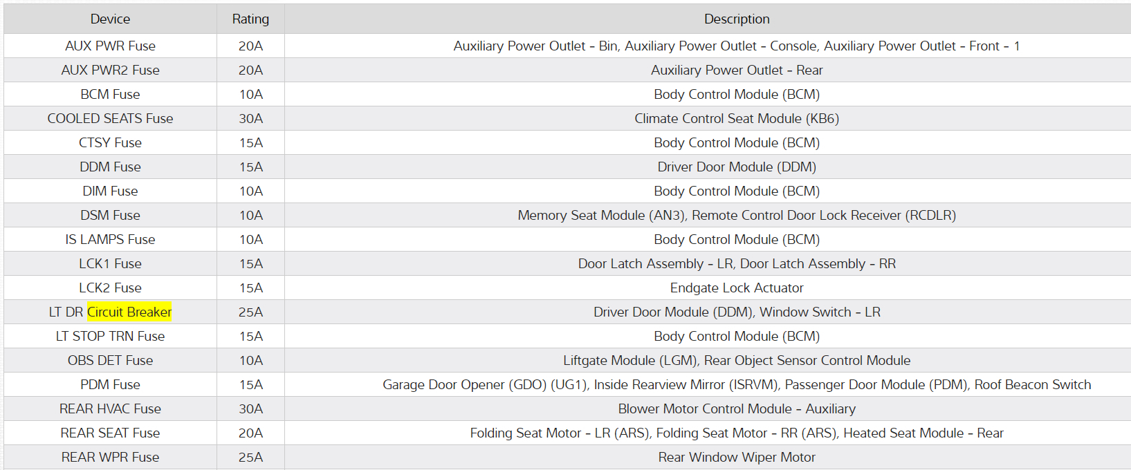

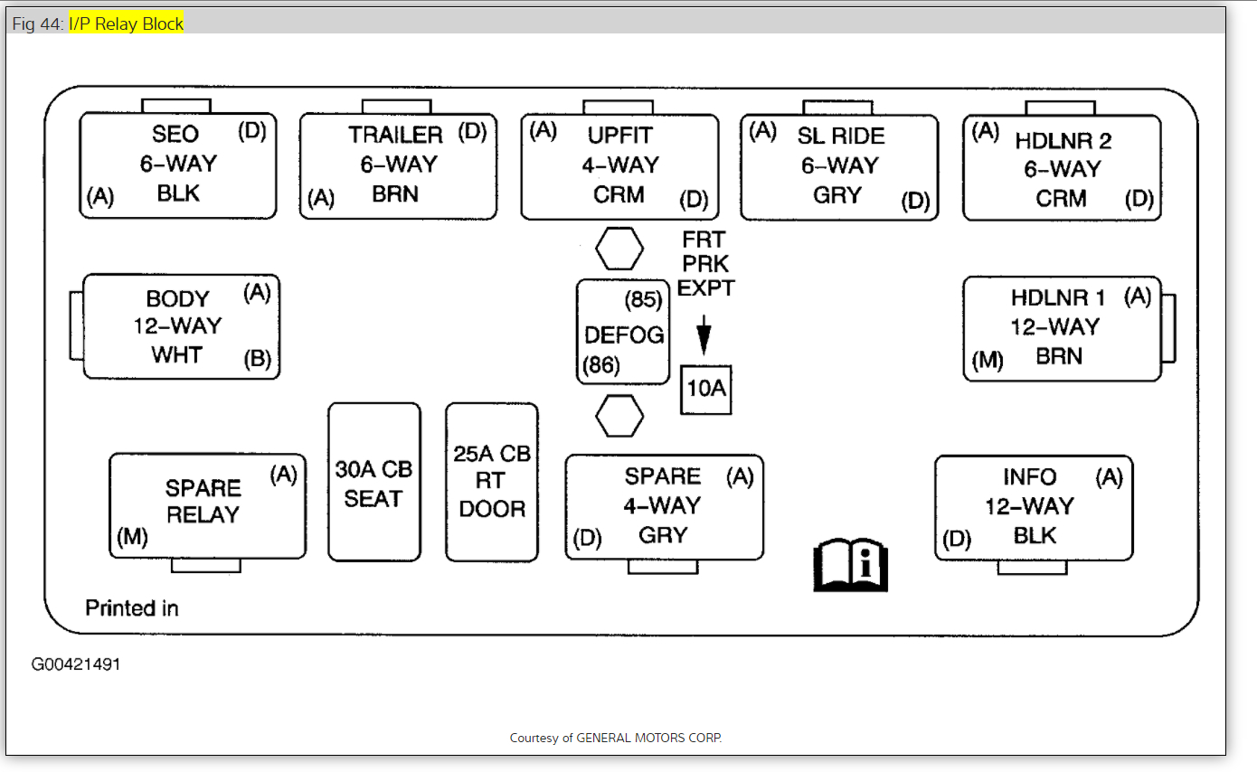

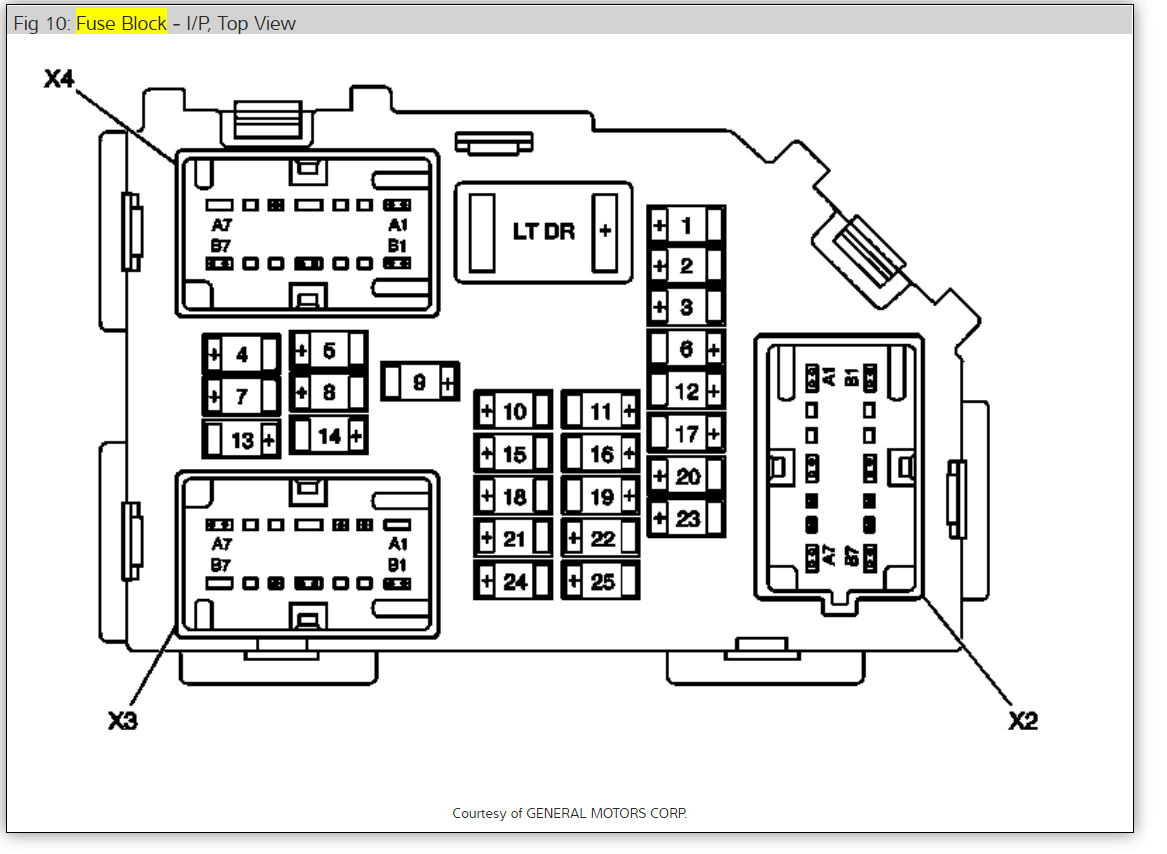

You need to calibrate the system which is easy. Turn the ignition key on then remove the HVAC fuse for 5 minutes then turn the key off and then replace the fuse. Then try the system. Here is the location of the fuse. #38
