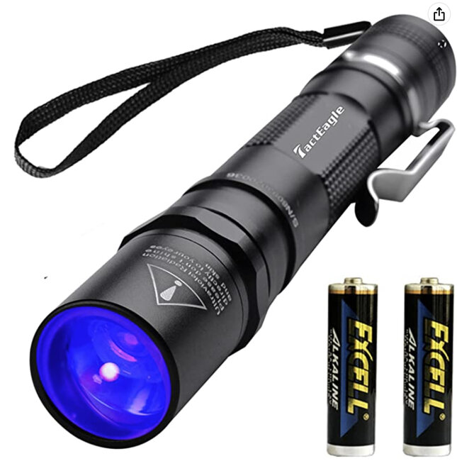

You can also look for leaks yourself with a UV light you can pick up at your local auto parts store. I will add a picture of one for you. Although pulling a vacuum on it is the best option because you won't be able to get to the evaporator with the light.
As long as dye has been put into the system any leaks should glow a bright yellow.
Check every hose, fitting, compressor, condenser and any other parts you can reach and see if you can see anything.
