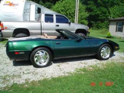

I talked to a couple people, and they said it was probably the optispark. So I pulled the air intake off, water pump, crank pully, and distributor. Replaced the distributor and plug wires, then put it all back together, and it is running. I did get two wires crossed on the drivers side, I marked them with what I could find, but then could not see my marking on 3 of them. I tried to trace them under but lost track of one apparently when putting them on. So I had to take the belt, and tentioner off, to get to that side to redo the wires again. But now it is fixed and running strong. Not bad for a girl huh? Thanks for all the input.

Thanks for the follow up. Another case for mechanical comprehension not being related to gender. :wink:
