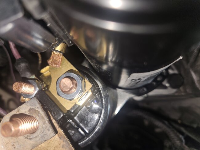

I've recently replaced a faulty starter with a new one. About 3 or 4 days I replaced it, my car attempted to start without there being the key in it.

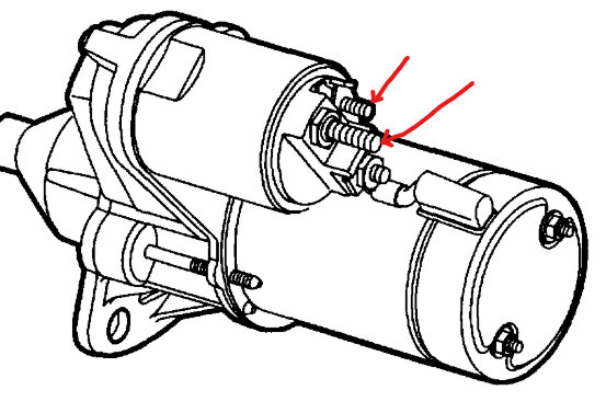

O wow, exciting, so if the wiring at the starter (main power lug) is too close to the trigger wire it will cause this, here is a guide to help you see what I am talking about.
If the wiring is okay you have a defective starter and need another. The wires at the red arrows cannot touch. Check out the images (below). Please upload pictures or videos in your response

Here's a photo Mr. Ken. Sorry for the late response.
Sep 9, 2025 at 5:08 AM
JOSHUACHESTER41
  • 5 POSTS

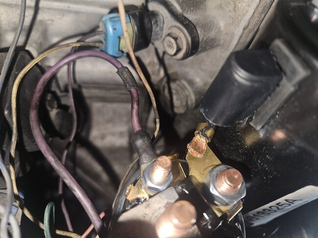

And some more
Sep 9, 2025 at 5:16 AM
JOSHUACHESTER41
  • 5 POSTS
I can't tell if they're correct or not, but it seems like it.
Sep 9, 2025 at 5:20 AM
  • 55,690 POSTS
Yep, it is connected correctly, I would get a different starter, that one is defective. Thanks for the images and video, it helps.
