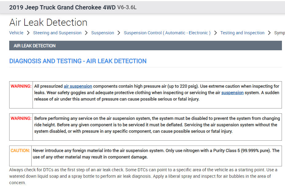

Hello.
I have my vehicle listed above summit model repaired at a mechanic a time ago, who replaced both of the front upper control arms, unfortunately my air suspension had some issues thereafter, which he could not solve them until I did some searches and I had to fix the problem myself by tightening the bolts only when the car is on the ground not when it is actually jacked , since I did the repair, I started to hear hissing sounds from the compressor l, like an air is escaping under pressure or like when we hear the sound of air hissing from a lorry !!
but there was not any issue with the jeep apart from frequent finding of air compressor working at morning, until now there was nothing annoyed me so much,
Recently and actually 4 or 5 days ago, I started to find the jeep sagging from the front when kept overnight until the morning, but it corrects itself when I just start the vehicle.
I think it is a leak problem and seems like a small leak that it needs an overnight to become evident.
sorry for being too much talking, but I wanted you to be fully informed about the problem ...
I hope you can help me with where to start and what are my next steps, please. Thanks, a lot.

It's odd the upper control arms needed to be replaced at this low mileage. I have a 2013 with 130,000 and it is all original and in good condition.

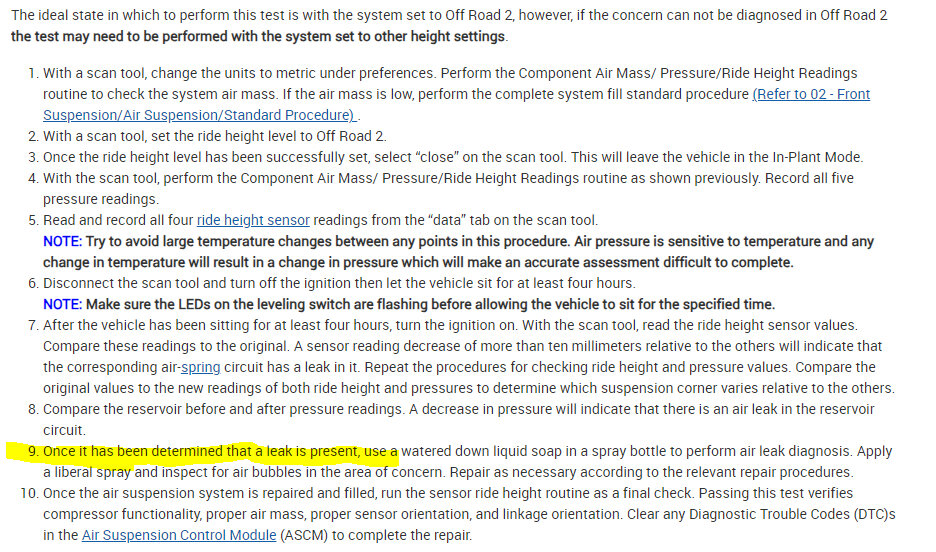

As far as locating a leak, I attached the directions below. It requires the use of a bidirectional scan tool. Actually, that is to help limit possible causes. However, toward the end of the tests, you will need to spray hoses down with soapy water.
Take a look at the diagnostics and let me know if this is something you are comfortable performing.

Thank you sir, I forgot to reply to you, the problem was solved, there was a leak from the left front connection of the air tube to the air strut, and since then, everything was going fine, really appreciate your reply sir.
