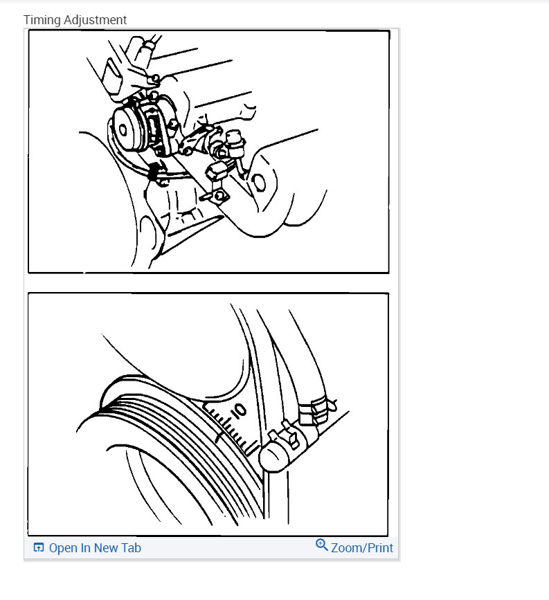

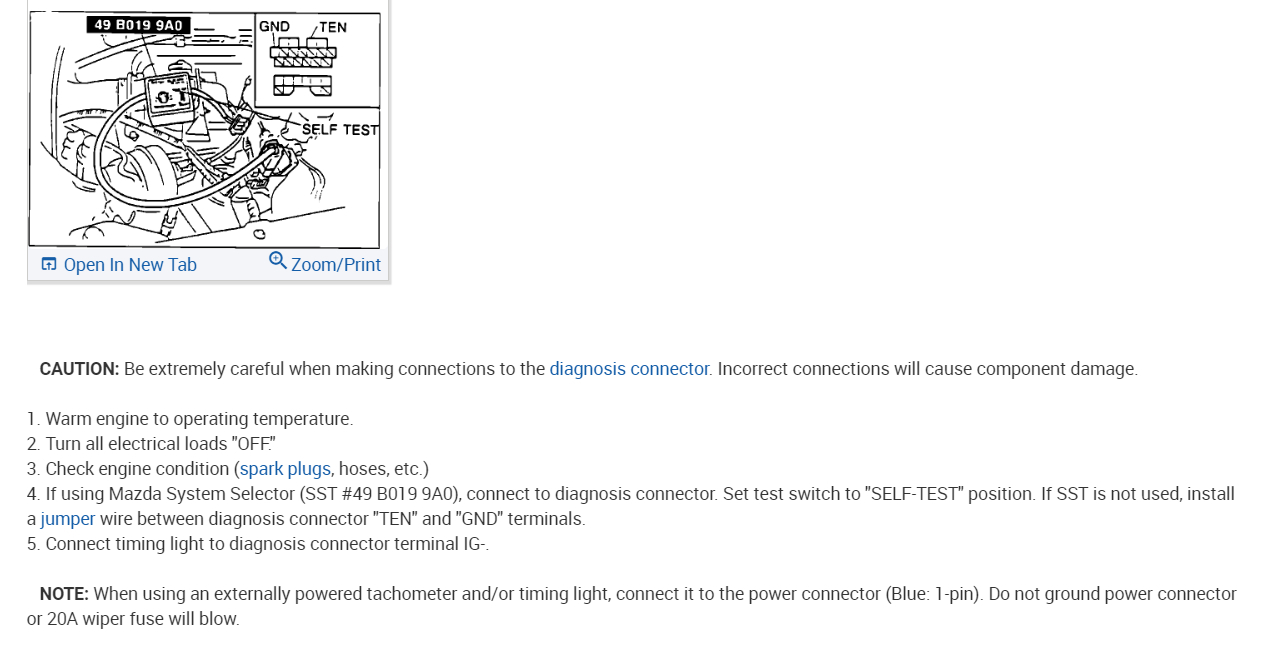

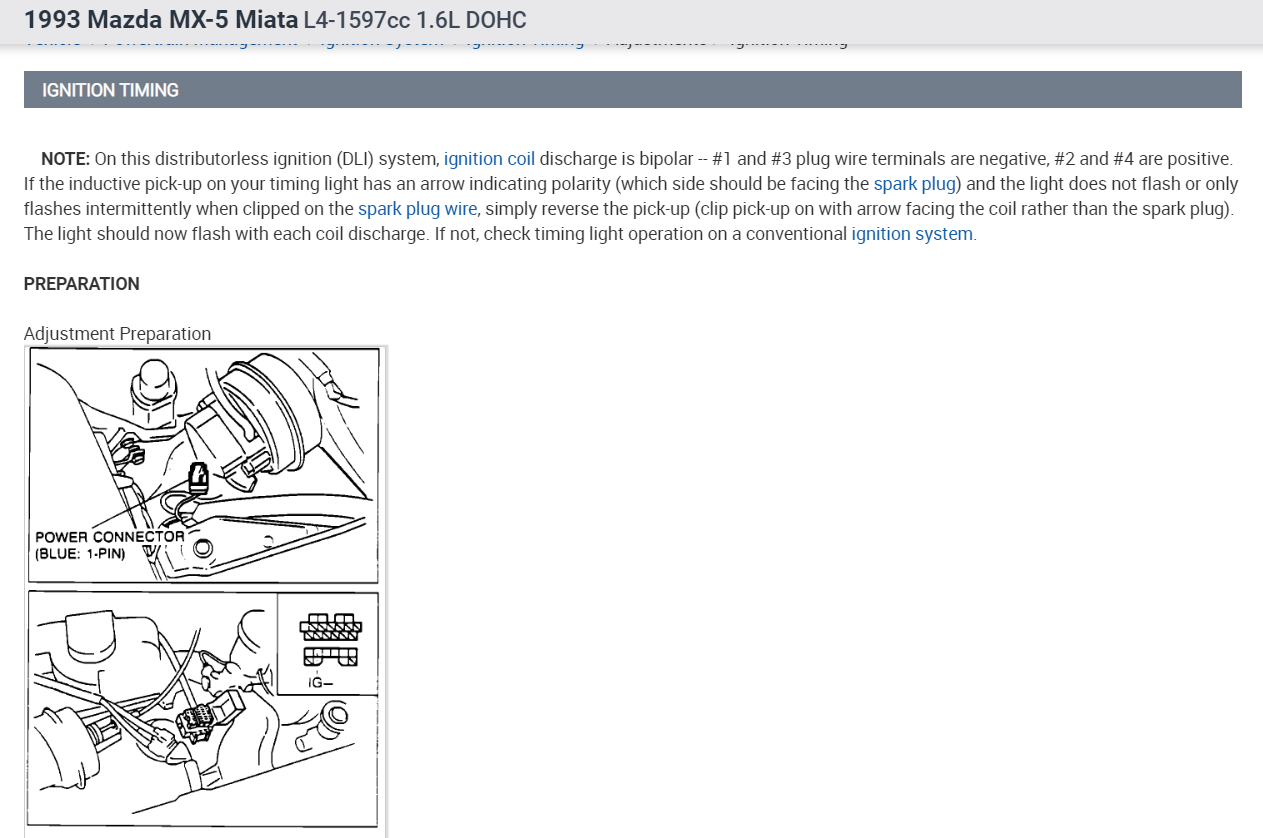

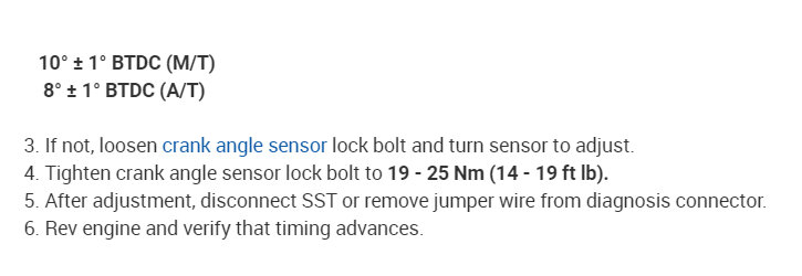

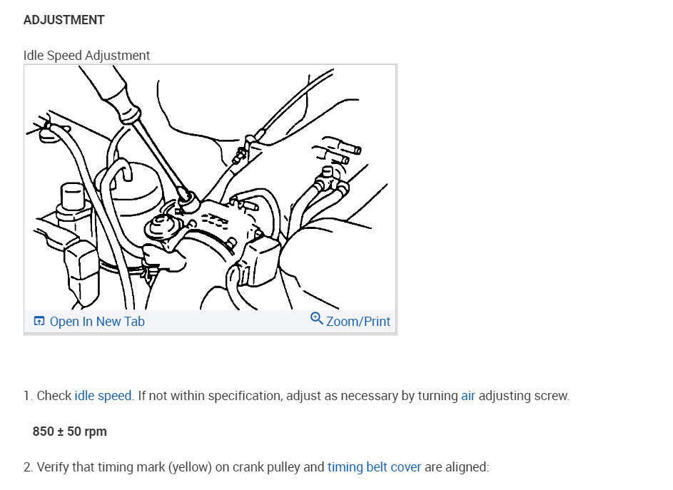

What is the compression? Also, will it run on starting fluid? How is the fuel condition being it is old? Can you upload a short video of the engine trying to start? That would help. Can you double check the ignition timing. here is how the job is done in the images below:

Check out the images (below). Let us know what happens and please upload pictures or videos of the problem.
