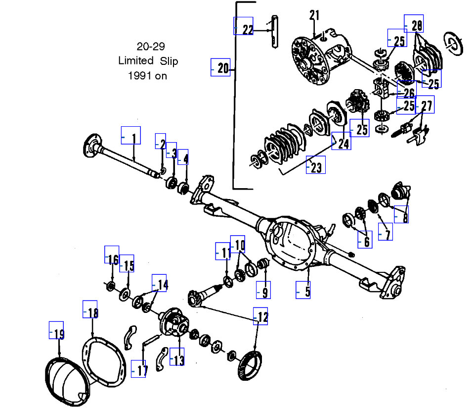

I have the truck listed above Xtreme pickup. The bearing inside the rear end that has the output shaft where the Driveline bolts to, it is behind that seal. The cage blew up and dropped all the bearings into my mini gears and all that. I need to know what I can get another rear end up out of that's compatible not just an S10 or an S10 Blazer or what have you what other vehicles have the same rear end? I'm at my Wit's End and I need some help.

A wrecking yard is your best bet on this, all you need to do is hold one rear tire still and count the revolutions of the drive shaft for the opposite tire to go around 2 times unless you have posi-traction in which case both tires will turn once. This will be the gear ratio which the yard will want to know. There are many applications that will fit your car and they have software they can tell which ones fit. Here is how to remove and replace the rear differential. Check out the images (below). Let us know if you need anything else.
Rear Axle Housing Replacement
Removal Procedure

15. Remove the differential assembly.
16. Remove the drive pinion yoke.
17. Remove the drive pinion.
18. Remove the drive pinion bearings from the drive pinion.
19. Remove the differential side bearings.
