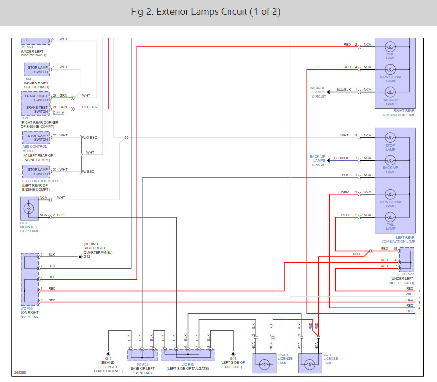

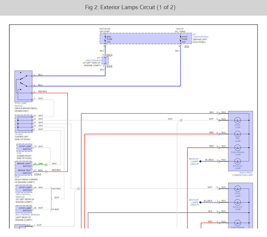

I installed a new brake switch, fuse, and new bulb. All rear brake lights work, except the lower right brake light. I checked for power with a voltmeter, no power. I'm at a loss from here. Pete
May 9, 2022 at 7:50 AM
  • 55,421 POSTS

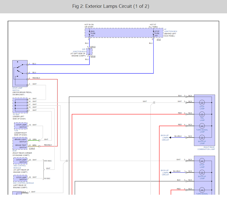

If the left side works the system is working, you can see in the brake light wiring diagrams below there is a connection between the left and right brake light. I would use a test light to double check if you are getting power at the white wire near the brake light bulb. Here is a guide with the brake light wiring diagrams below:
and
https://www.2carpros.com/articles/brake-lights-not-working
