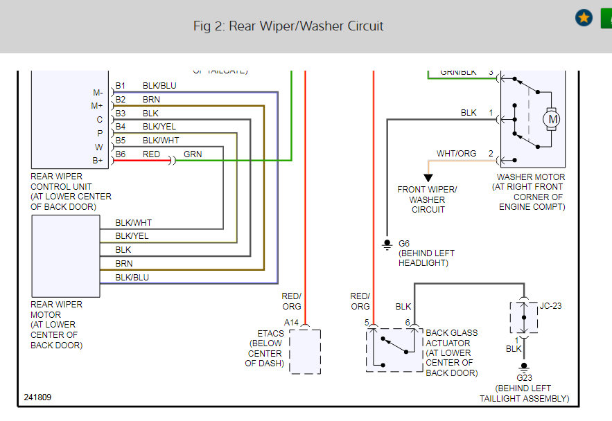

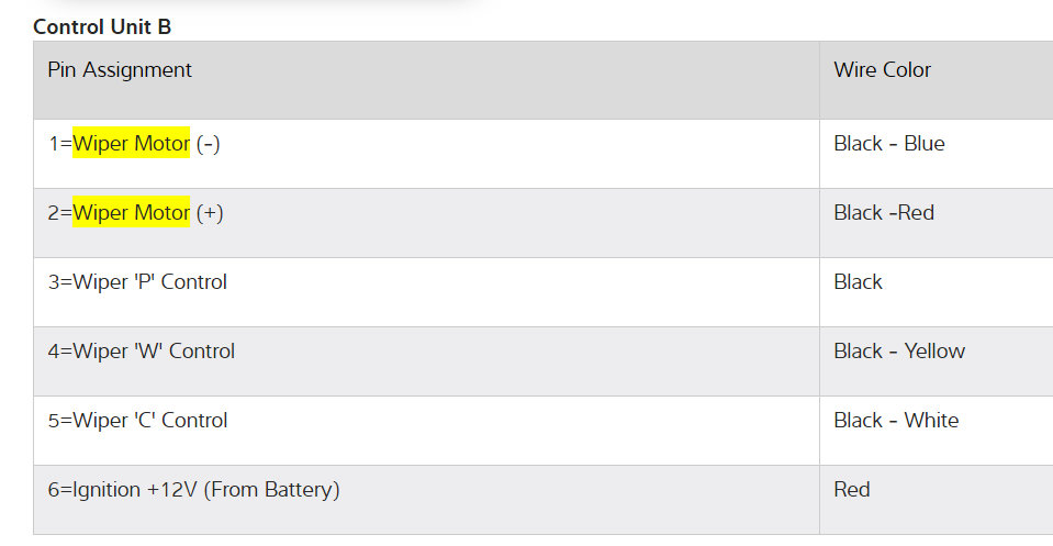

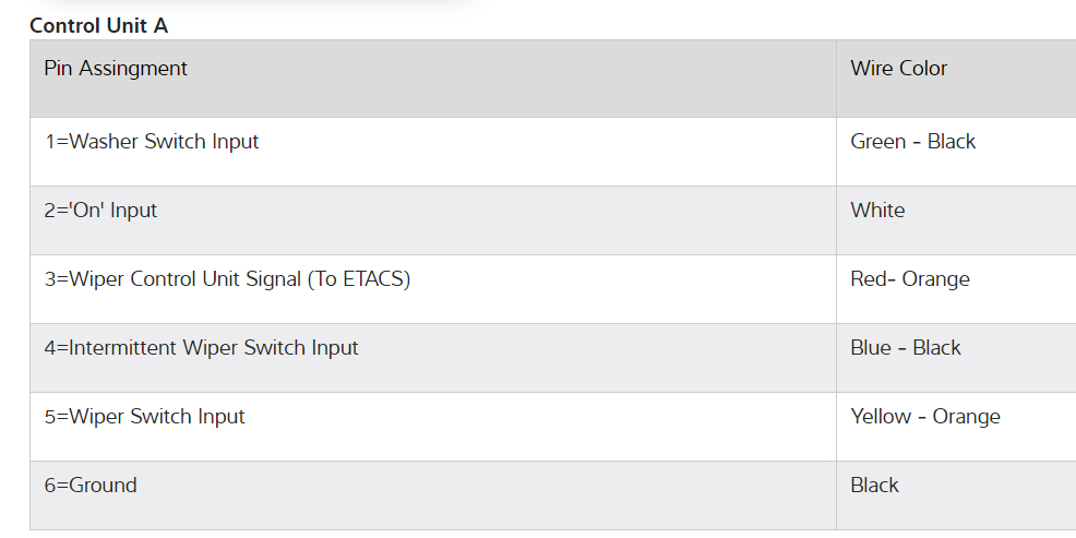

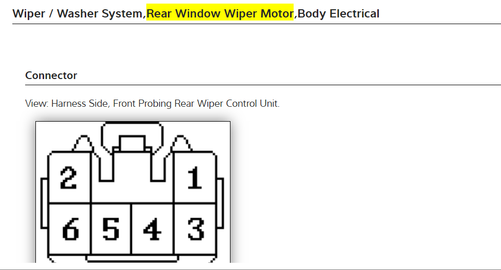

Rear wiper won’t stop running even when ignition turned off.
I changed the box in the tailgate (marked RR WIPER CONTROL 98750-3E000>ABS.
Aug 1, 2019 at 2:26 PM
SCGRANTURISMO
  • 4,897 POSTS

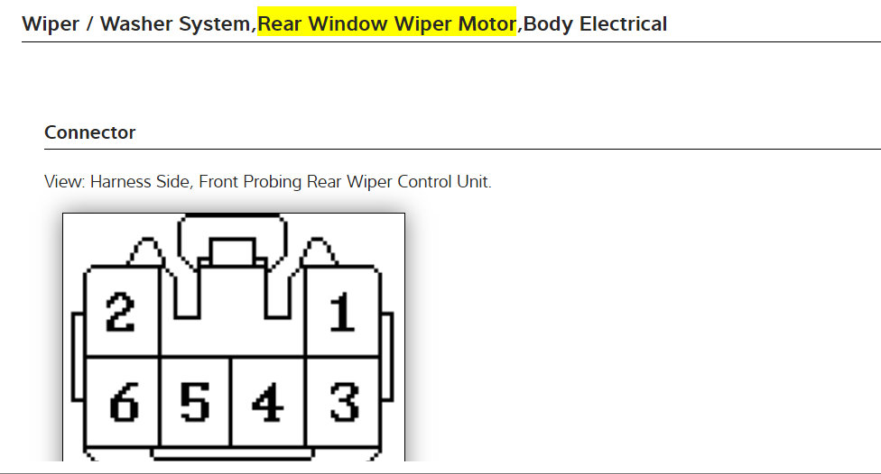

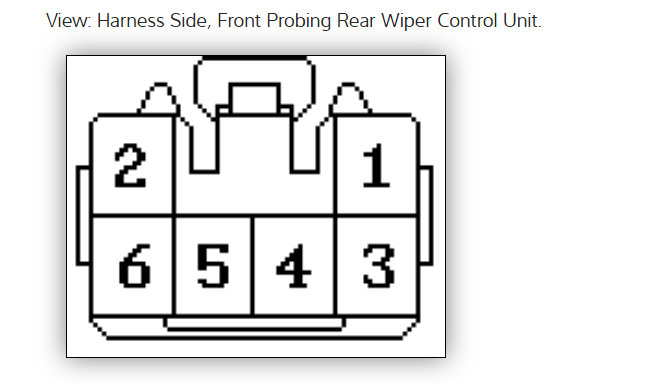

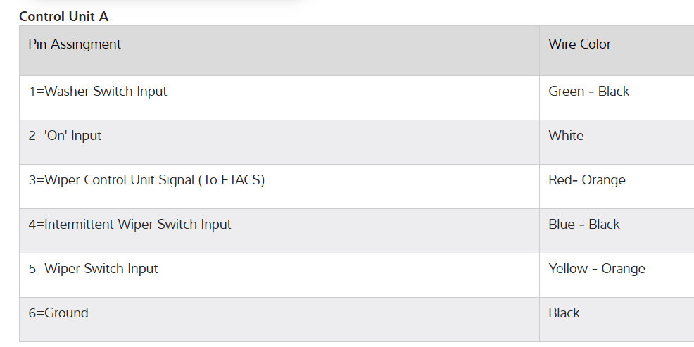

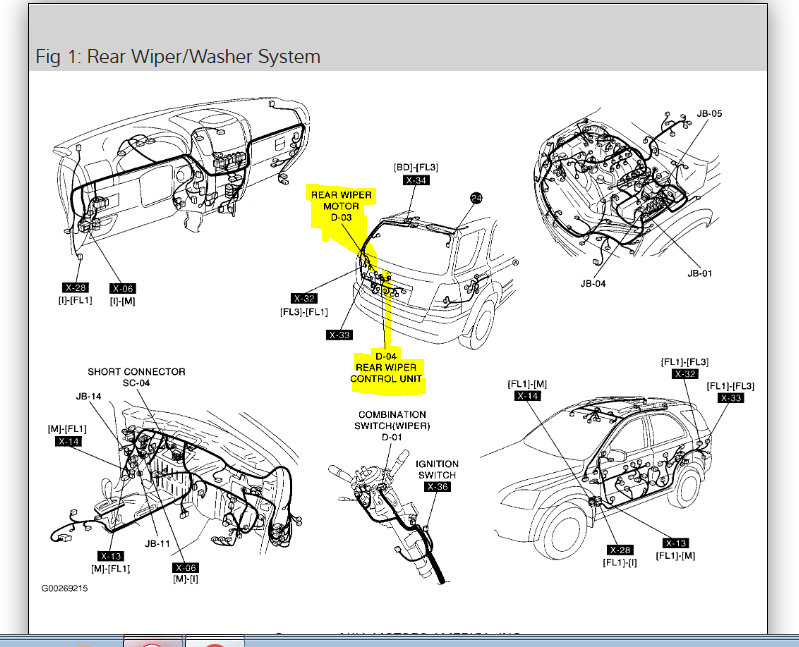

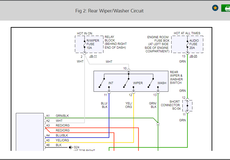

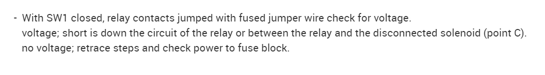

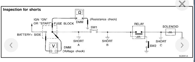

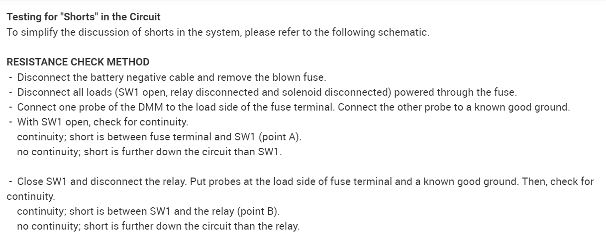

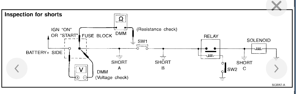

There are a couple of possibilities here. The first is you have an internal short to power in your vehicle's Rear Wiper Control Unit or you have a short to power in black/blue wire going from pin #1 of the Rear Wiper Control Unit to the Rear Wiper Motor. I would start by checking the black/blue wire for a short to power. In the diagrams down below I have included wiring diagrams, connector views, and the location of the Rear Wiper Control Unit and the Rear Wiper Motor, as well as a guide for how to find a short to power. Please go through these guides and get back to us with what you are able to find out.
Thanks,
Alex
