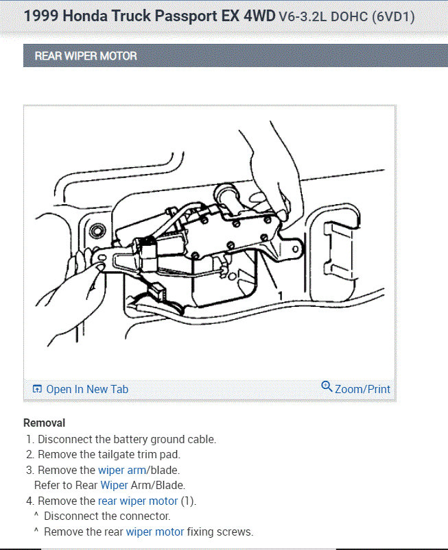

As soon as I start the truck the wipers start working for like 5 minutes and then stop sometimes in the center.
How can i remove the wiper motor to replace it?
Jan 19, 2022 at 9:55 AM
  • 110,240 POSTS
I'm not sure the wiper motor is the problem. Even if it is bad, it needs power to work. That leads me to think there is an issue with the switch itself.

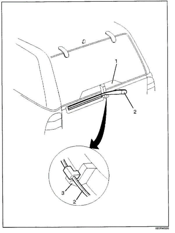

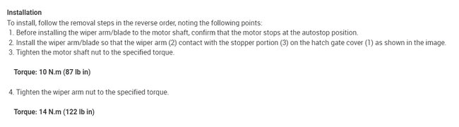

If you want, I have attached the directions below for replacing the rear wiper motor. These are specific to your vehicle.
Let me know if you have questions or if I can help in any way.
