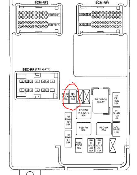

Rear washer fluid pump and rear wiper are not working
2008 KIA SEDONA
190,000 MILES • 2WD • AUTOMATIC
AARMITCH

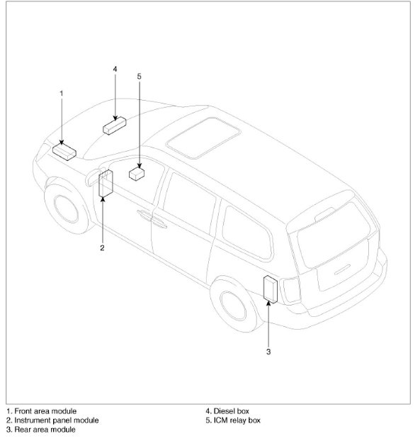

I suspect a blown fuse, but I'm not sure which one to pull. Any help is appreciated.
Sep 20, 2019 at 9:56 AM
DANNY L
  • 5,648 POSTS
Hello, I'm Danny.
It is located in the RAM (rear area module). Here is a tutorial showing how to replace fuses:
I've attached two pictures below showing the locations.Hope this helps and thanks for using 2CarPros.

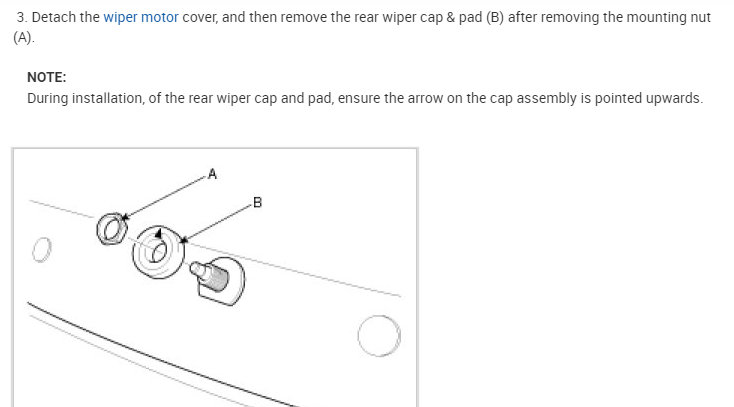

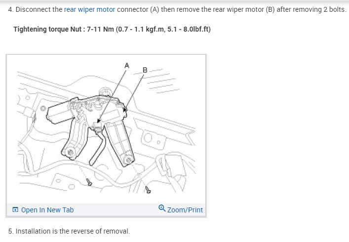

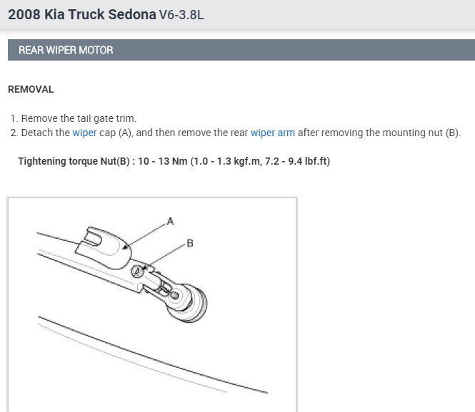

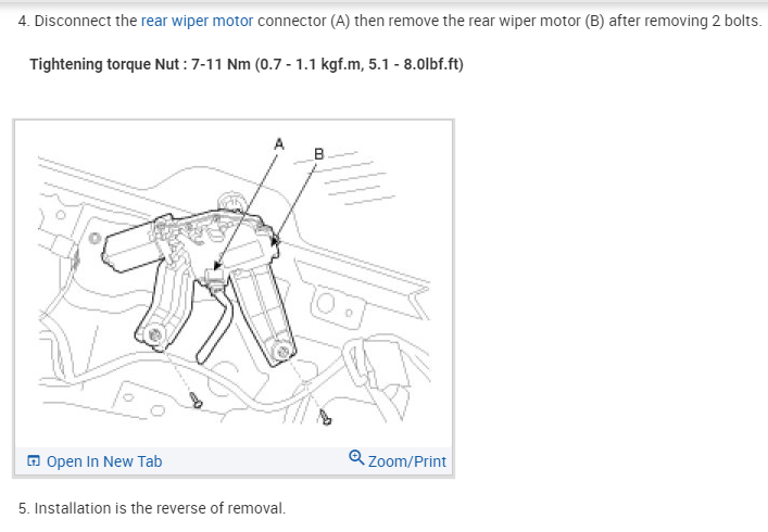

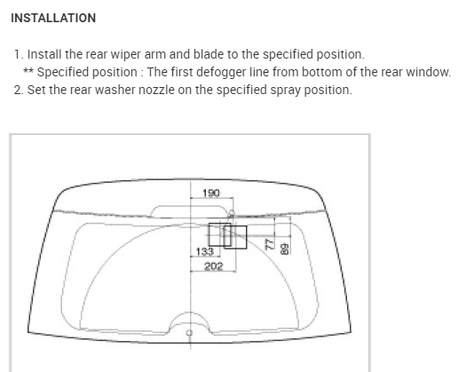

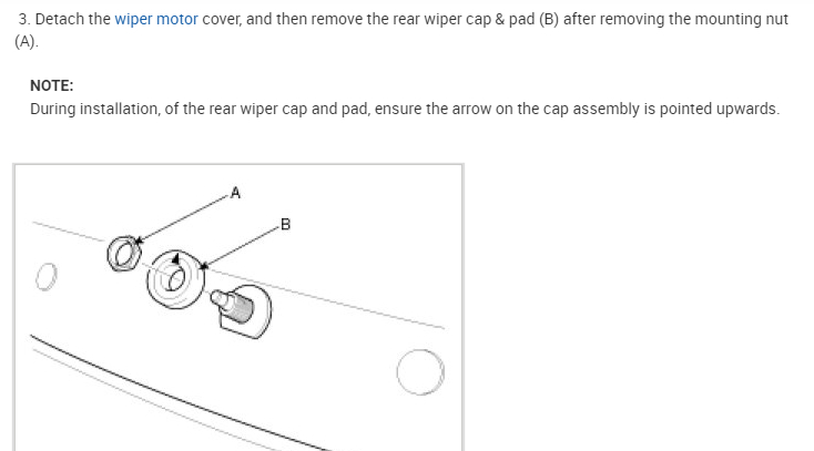

Thanks for the quick response. It didn't end up being the fuse. I've been able to get the wiper to travel in 1 direction, but then it stops and makes a loud clicking that only stops when the key is pulled from the ignition. Ideas?
Sep 20, 2019 at 1:10 PM
DANNY L
  • 5,648 POSTS
Hello again.

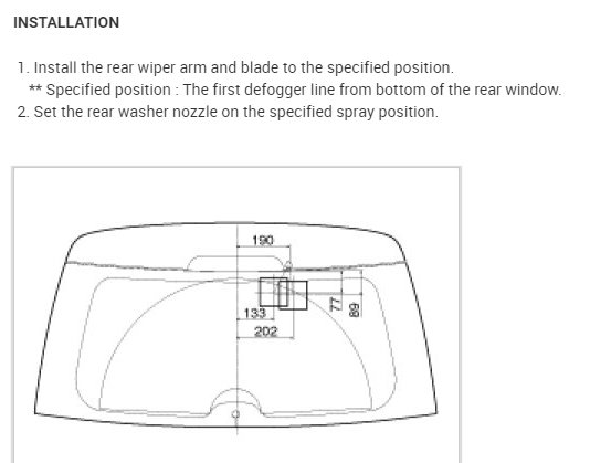

In that case since fuses are good, Sounds like the actual wiper motor is defective. I've attached step-by-step instructions for removal. I've also attached a picture of the Kia factory part number.You can save a money by going to your local auto parts store if you want a non factory part.Hope this helps and thanks again for using 2CarPros.
