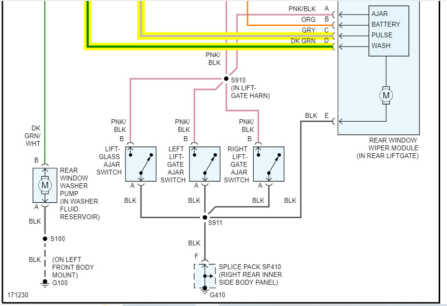

No problem. I need some general info. It sounds like you have already done a lot. You mentioned checking for power at the motor. Is power present? Additionally, you mentioned working with the ground. Is the ground in good condition?
I attached the wiring schematic below. Note that if any of the liftgate or rear window switches are not closed, you "in theory" lose a ground path via the door-ajar switch. So, check those and make sure they are working and adjusted.
Next, looking at the wiring schematic, tell me where power is available or where it stops. Do the same thing with the ground circuit.
Let me know as much as you can. Note: If there is power and ground to the wiper motor, it should run. If it doesn't, you may have another faulty wiper motor. Also, let me know if both fuses, I highlighted are good and have power to and from them. I feel somewhat confident the interior fuse isn't a problem since the washer works. However, the one under the hood is a different issue.

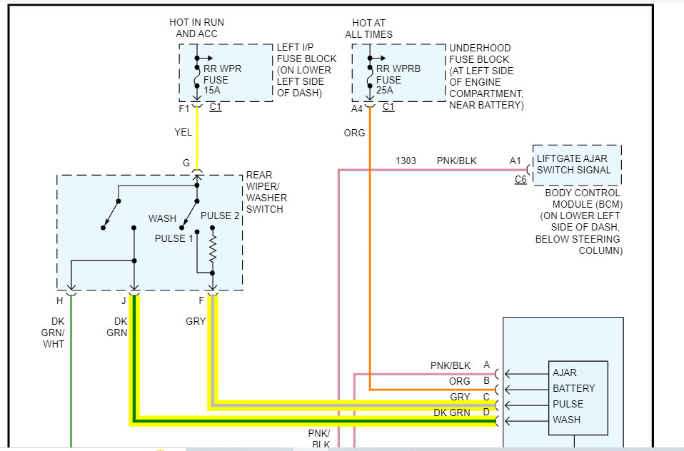

Thanks for reaching out. This is what I know.
With the key/switch off:
Black/Pink = 3.8
Orange = 12.4
Gray = 0
Green = 0
Black = 0
With key on and wiper turned on:
Black/Pink = 3.8
Orange = 12.4
Gray = 3.6 to 5.5 (it jumps back and forth)
Green = 0
Black = 0
You kind of lost me on these two quotes. Not sure how to check these.
"I attached the wiring schematic below. Note that if any of the liftgate or rear window switches are not closed, you "in theory" lose a ground path via the door-ajar switch. So check those and make sure they are working and adjusted."
And:
"Next, looking at the wiring schematic, tell me where power is available or where it stops. Do the same thing with the ground circuit."

Okay, I just read somewhere to test the gray wires power with the wiper switch in the #1 position. I did this and it read 12v. In the above power test, I had the switch on #2 and that read Gray = 3.6 to 5.5 (it jumps back and forth). Does this tell you anything?

If you have 12v with it in position 1, the motor is getting power. So, either the motor is no good or there is no ground.
Also, I have seen the voltage (12v) drop to nearly nothing when under a load due to a faulty connection. If you want to check for that as a possibility, with the wiper motor on, you would need to back probe the gray wire to see if the power drops.
As far as the tests you questioned above, if you have power to the gray wire, the only thing we need to confirm is power is consistent when requested and there is a good ground.

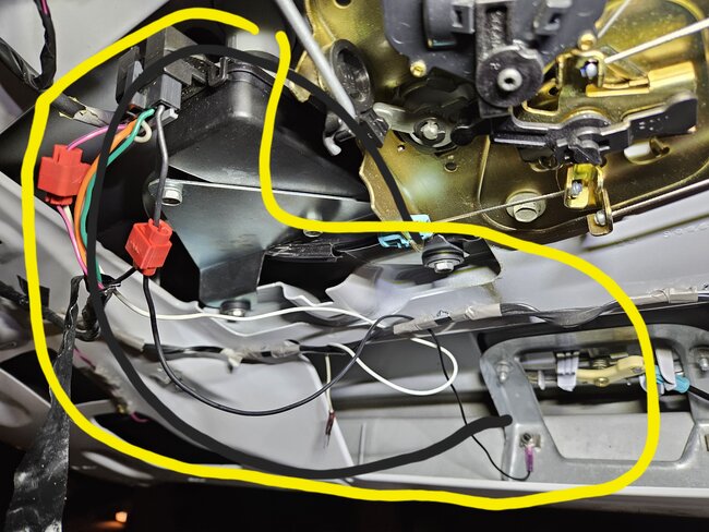

Just as an FYI, in some of what I researched, a lot of people have jumped the ground wire from the motor plug in to another ground. I did this. Should I keep it or put it back to normal. Or, maybe I jumped it from the wrong place.

It looks like you attached a new ground from the motor connector and appears to be grounded to the side body panel. That is perfectly fine, and you can leave it like that. It won't hurt anything.
