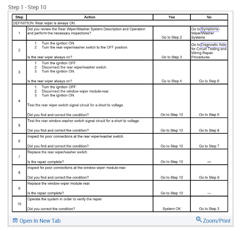

With ignition on the rear wiper will not shut off. It has been irregular in parking but even then it's only for a short time. Have pulled the fuse but winter weather makes it a desirable feature to work correctly.
Had it detailed in December and has had this issue since picking it up.
Feb 15, 2019 at 6:08 AM
  • 55,694 POSTS

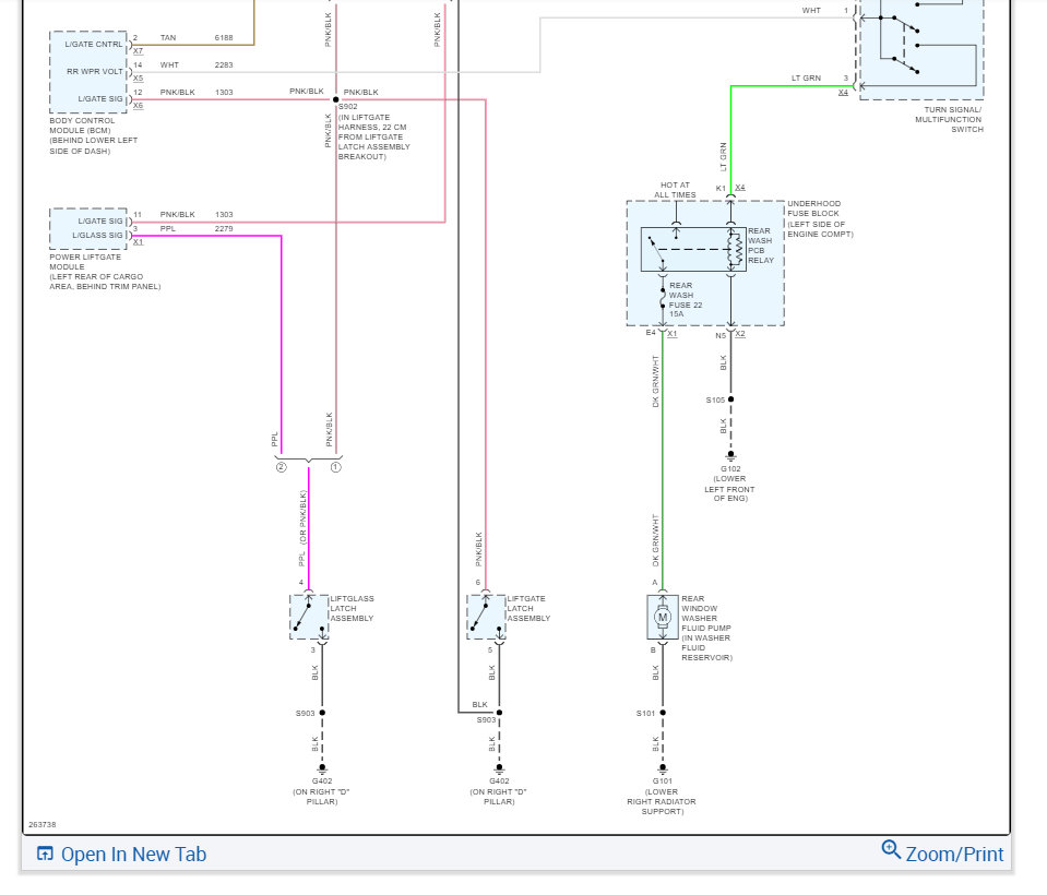

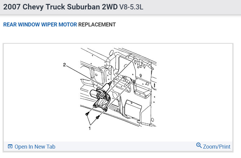

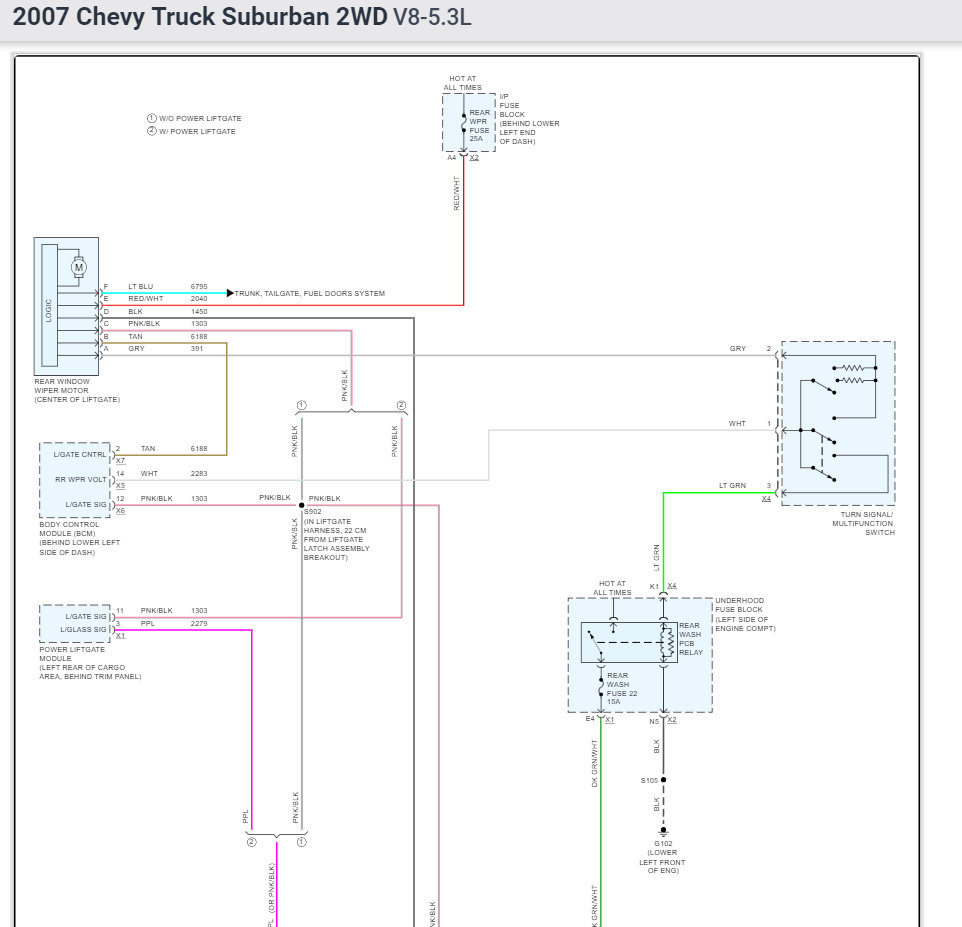

It sounds like the logic inside the wiper motor has gone bad. here is a wiring diagrams for the rear wiper so you can see how the system works. You will need to replace the rear wiper motor. I have included a troubleshooting guide as well. Check out the diagrams (below). Please let us know what you find. We are interested to see what it is.
