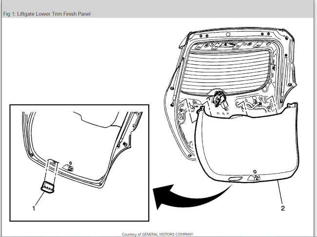

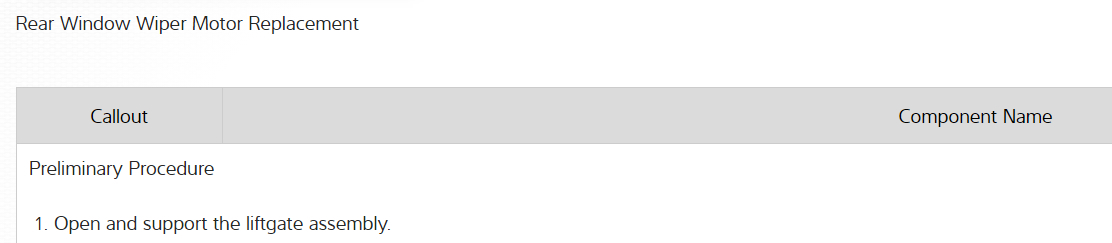

Rear wiper stops half way have to get out and either tap the rear of the wiper arm to lift the blade up of the window. There is a noise that the wiper is trying to move.
Feb 4, 2019 at 2:55 AM
SCGRANTURISMO
  • 4,897 POSTS

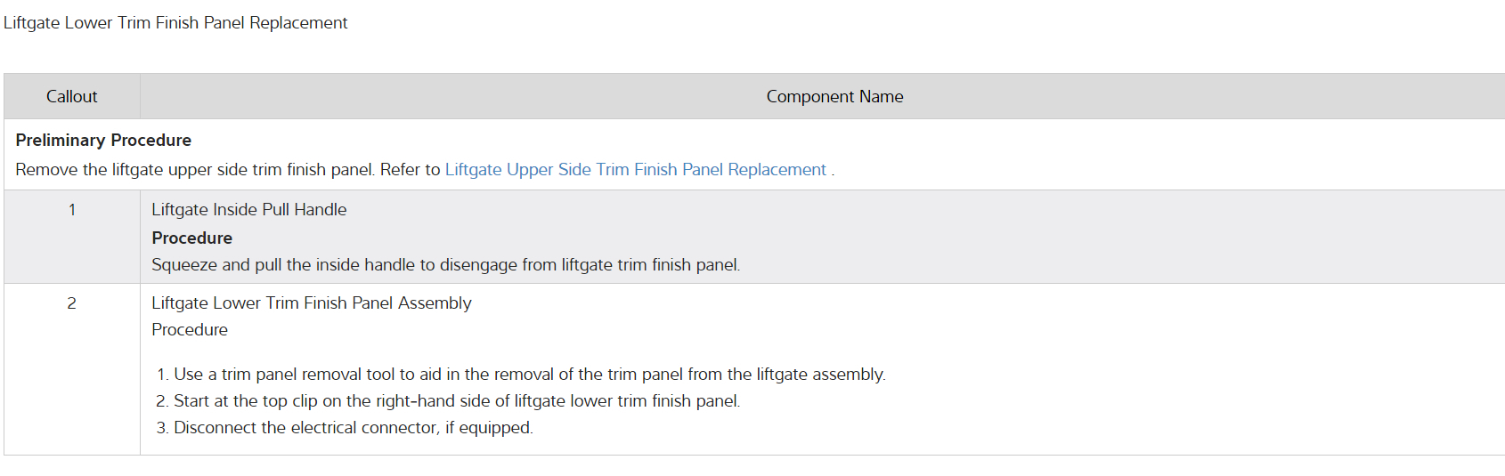

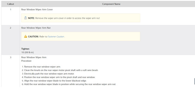

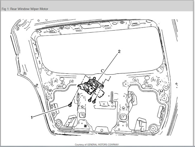

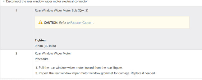

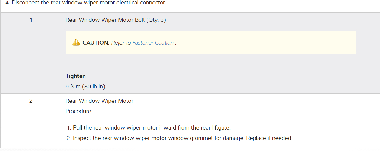

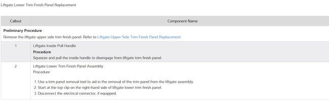

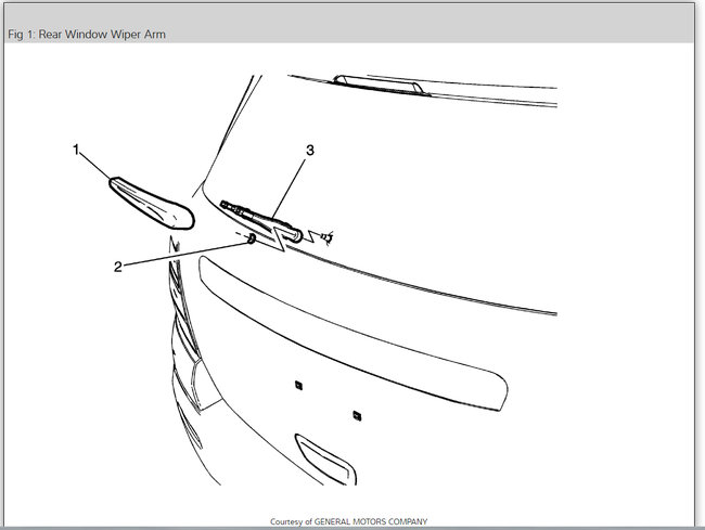

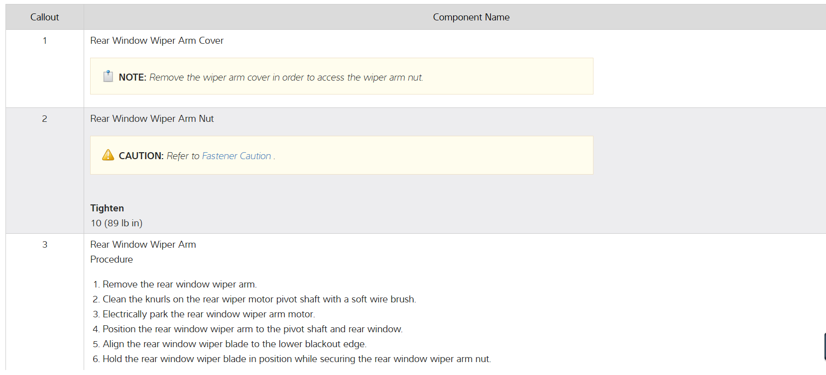

This sounds to me like your wiper are may have been bent. If not then it sounds like your wiper motor may be going out. Down below I have included step by step instructions on how to replace it.
