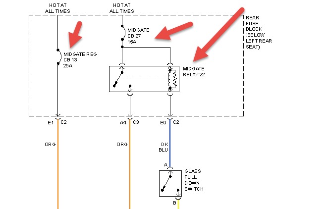

Am unable to raise the rear window. Inside sensor says rear wiper obstruction. Is there any way to disable the rear wiper sensor just to get the window up.

we all make mistakes.....ok this must be the xuv model where door and glass disappear. check the tings I've pointed to in picture. you can switch a relay with another that is like it to test. it . If not then it needs scanning by a pro to see which module is messed up. also if you want to pull the panel off of gate you can un plug lock switch and see if it works that way.

Okay, thank you very much. This gives me a place to start.
