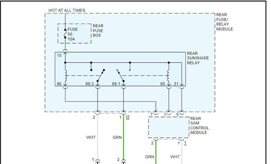

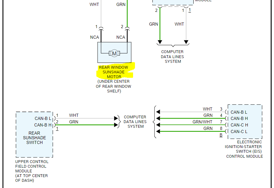

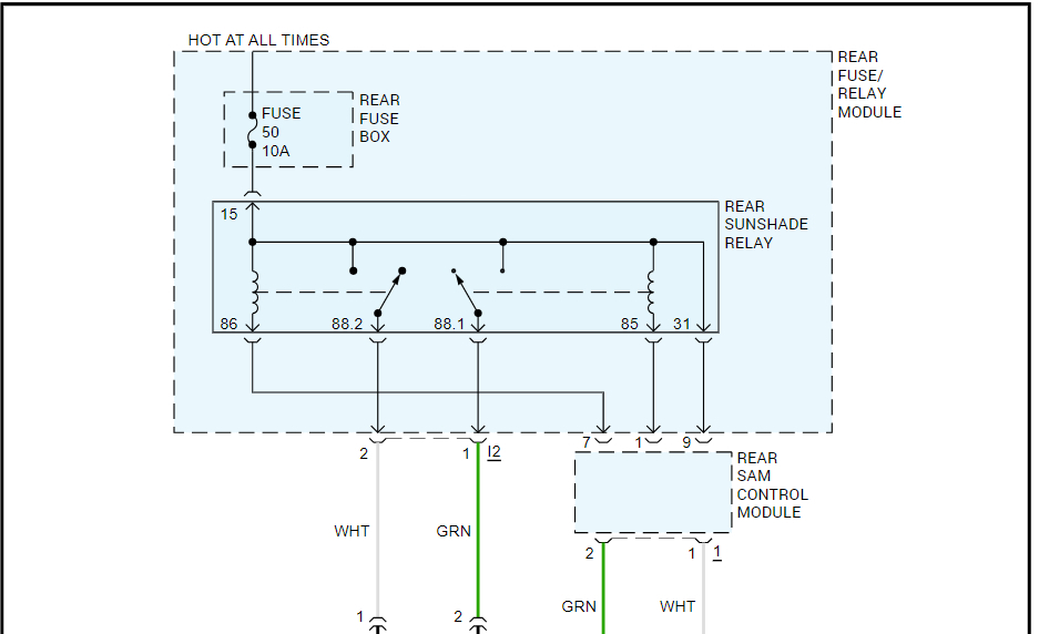

I just need the schematic for the rear window shade button if you have one thank you. And the rear window shade wiring diagram thank you.

I attached the wiring schematic below for the rear window shade motor. I had to cut the pic in half to make it readable for you. I did overlap the two so you can follow from one to the other.
Additionally, here is a link you may find helpful:
Let me know if this helps.
