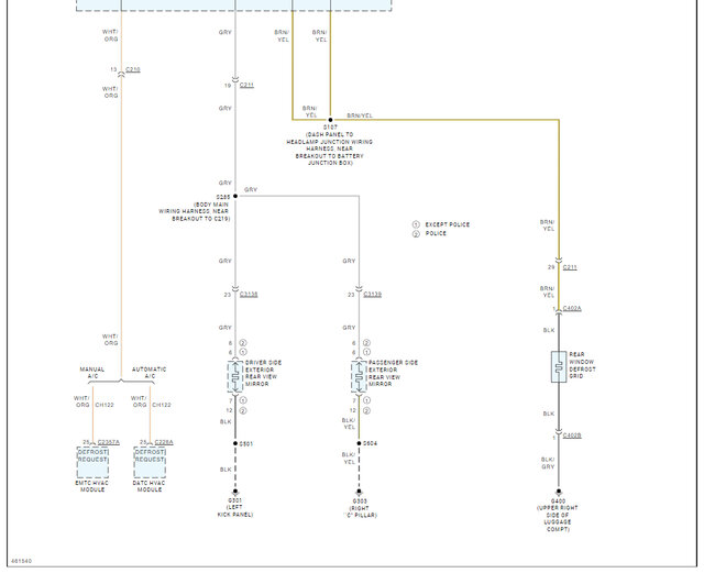

My rear heated window is not working. The fuse is good, and the element/grid has also been tested and has got correct power. The switch inside the vehicle to turn it on is also working. Am i right in thinking maybe a a bad earth/ground? i do not know where the earth is located for this issue. The is two rubber type bungs on either side at the top of the tailgate left side and right side. Could i use a test light for this? As i am a novice that is all i have. many thanks in advance.
The vehicle listed above mk5.

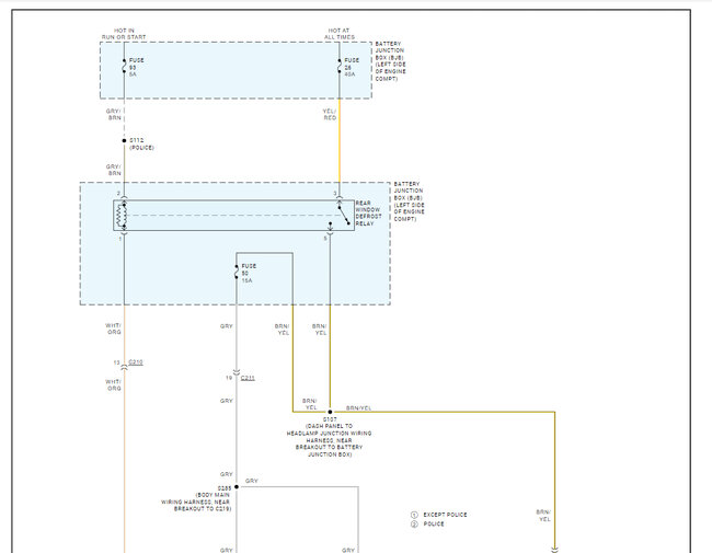

Yep, if the grid has power, then it will be the ground, or the grid has a break in it. Here are the rear defroster wiring diagrams so you can see how the system works and the ground location which is on the upper side of the luggage compartment. Check out the images (below). Let us know how it goes.

Good evening, the result is in! Drum roll, the issue was a bad earth up in the tailgate driver's side. So, thank you for your advice. good night, ste
